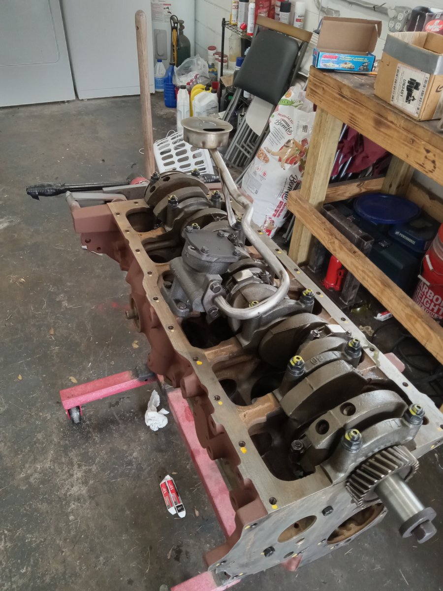

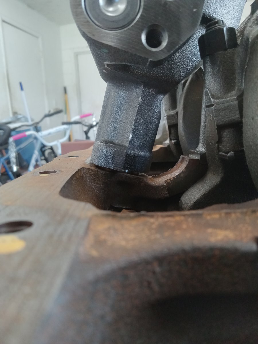

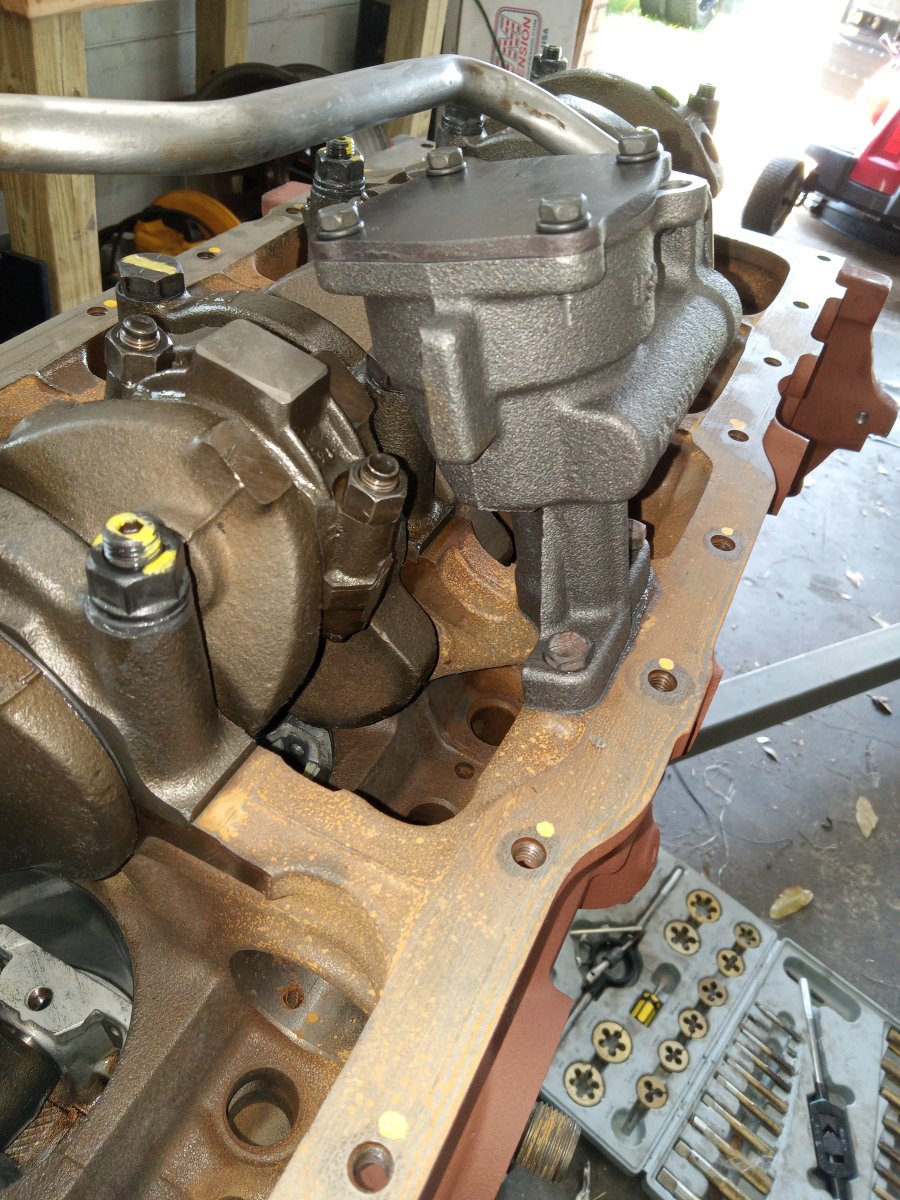

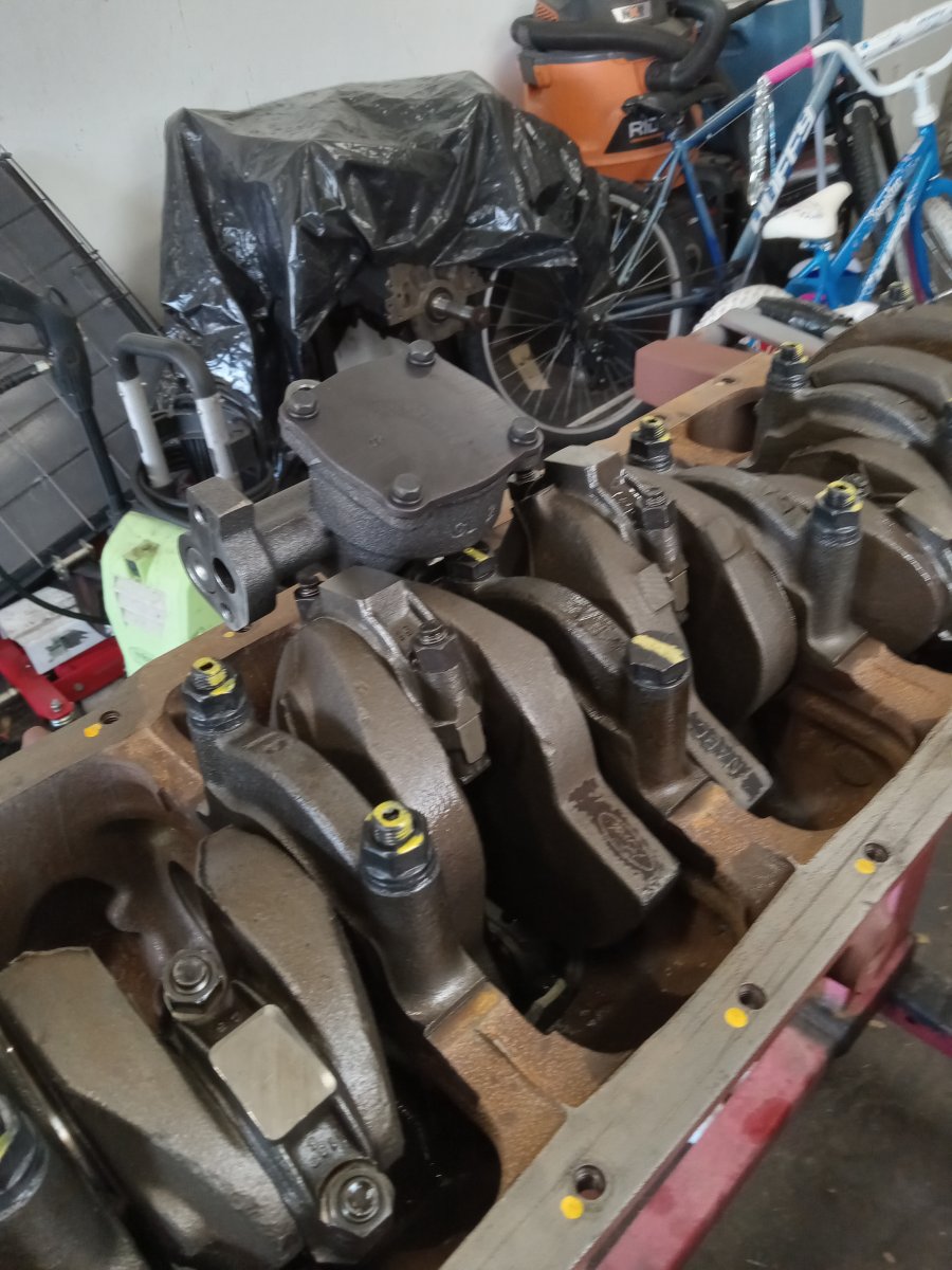

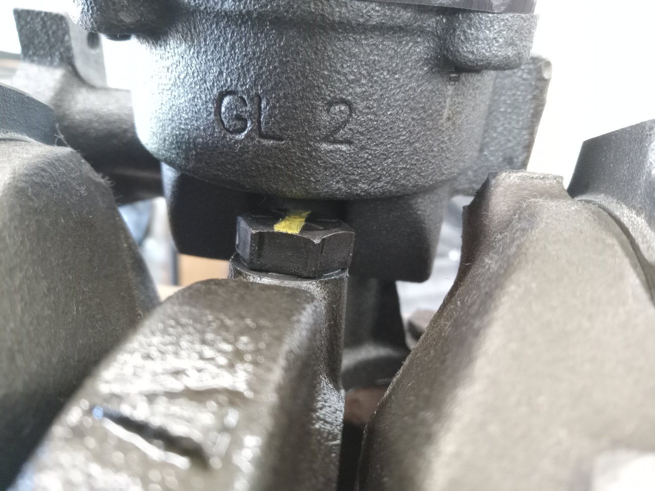

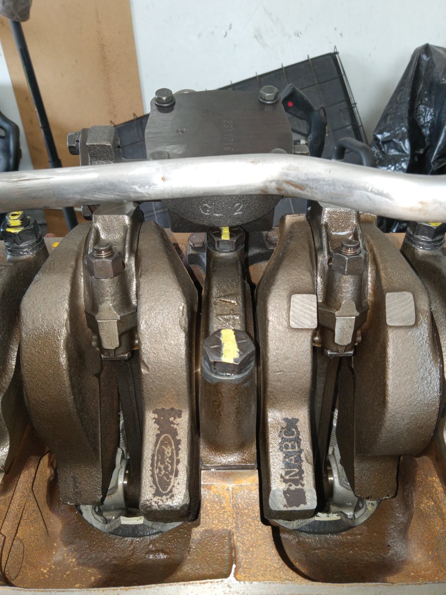

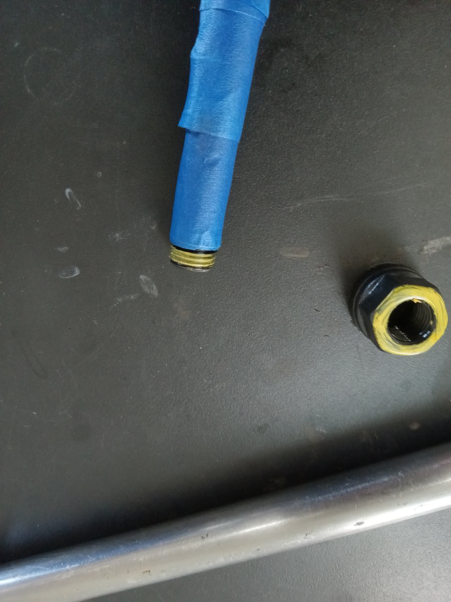

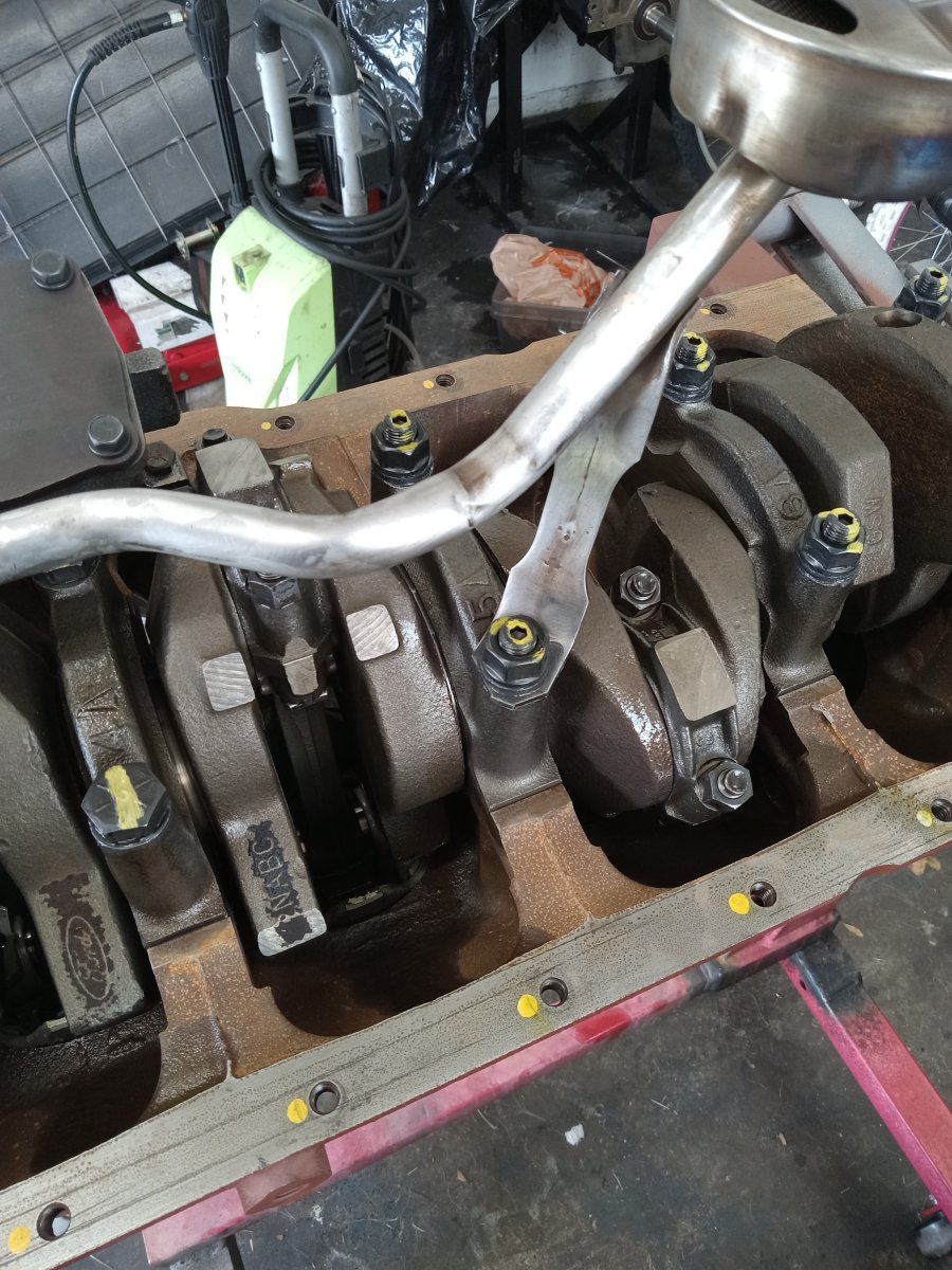

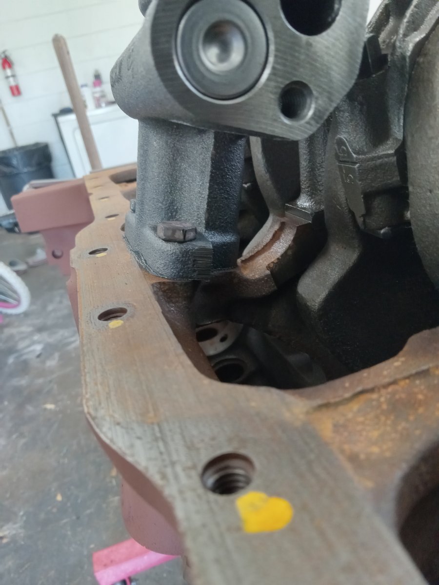

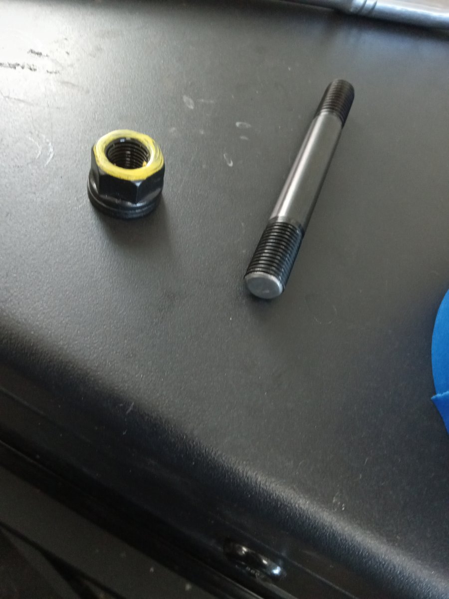

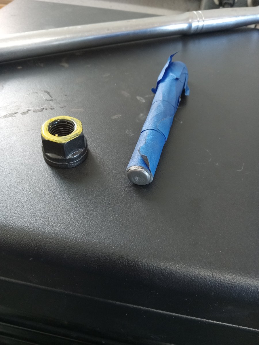

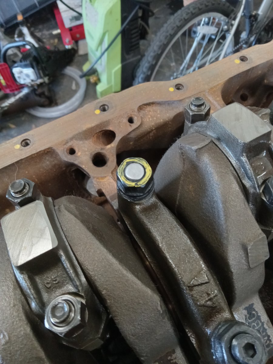

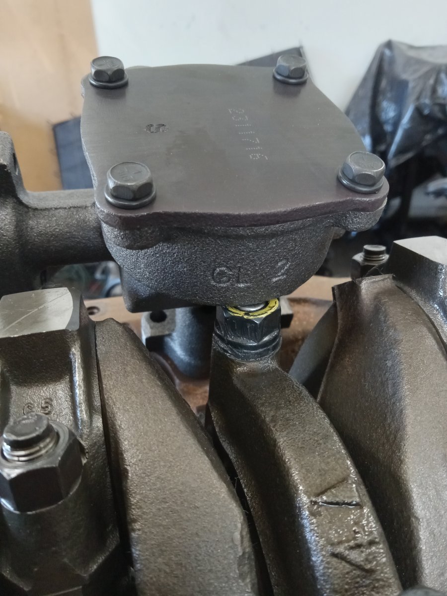

had a lot of options but chose to reuse the original main cap bolt on the main cap next to the oil pump. i removed 1/4 from the studs but the pump was still hitting the nut and i didnt want to trim the nut.

Here it the clearance after swaping to the original main cap bolt.

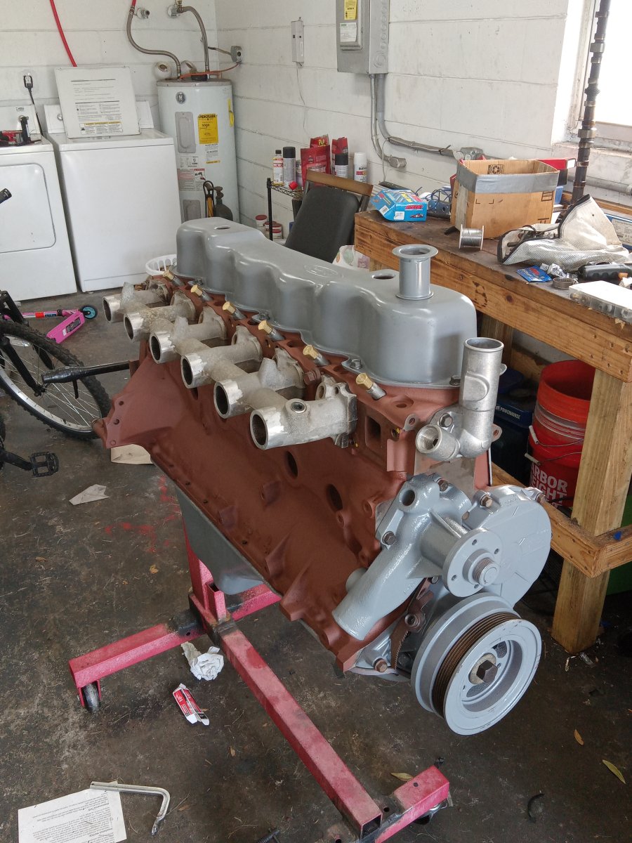

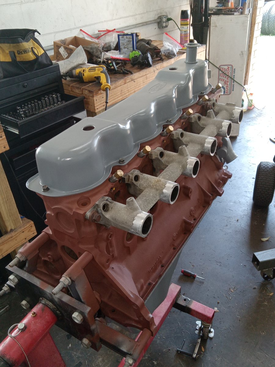

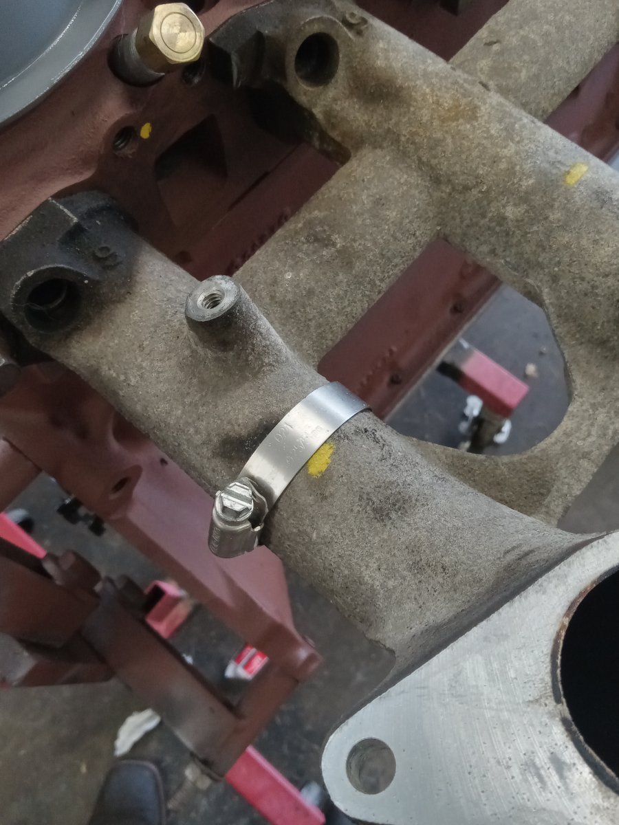

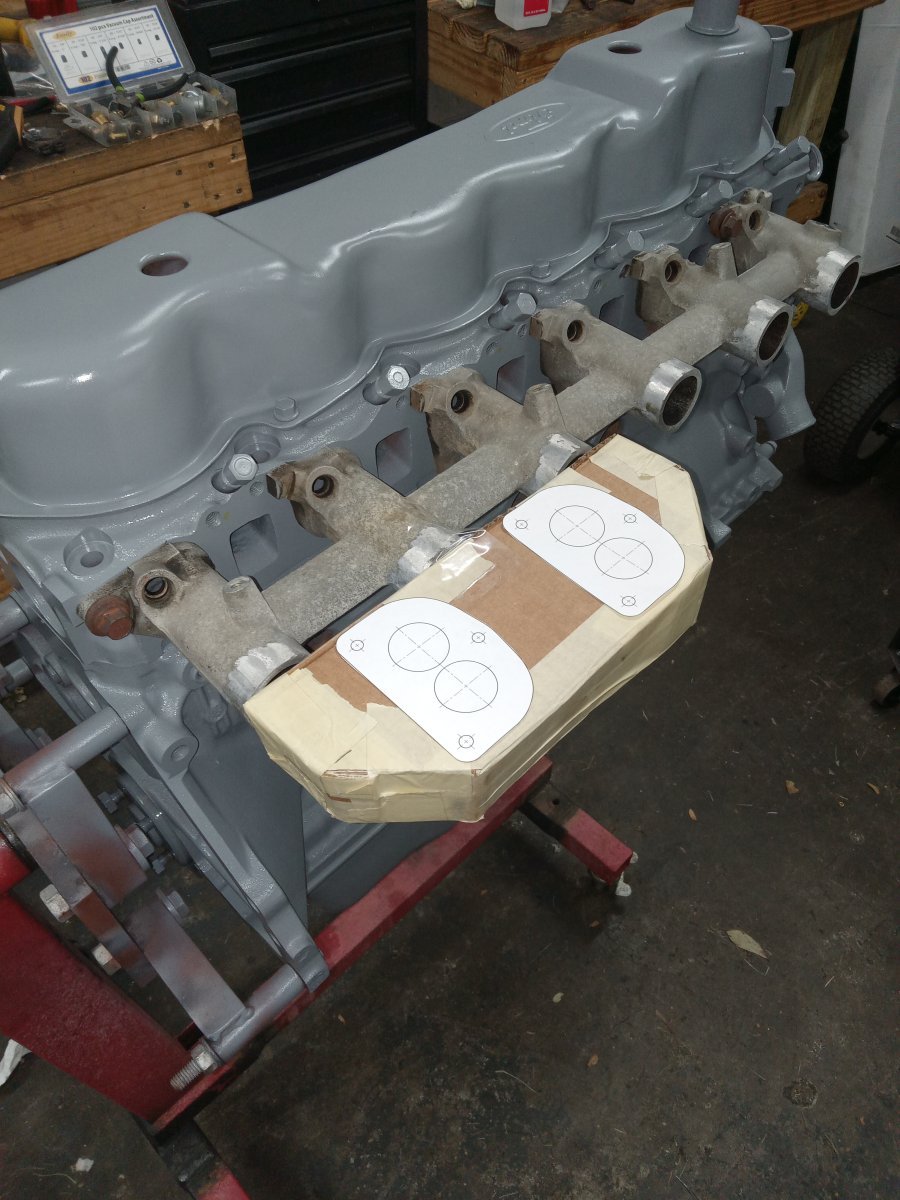

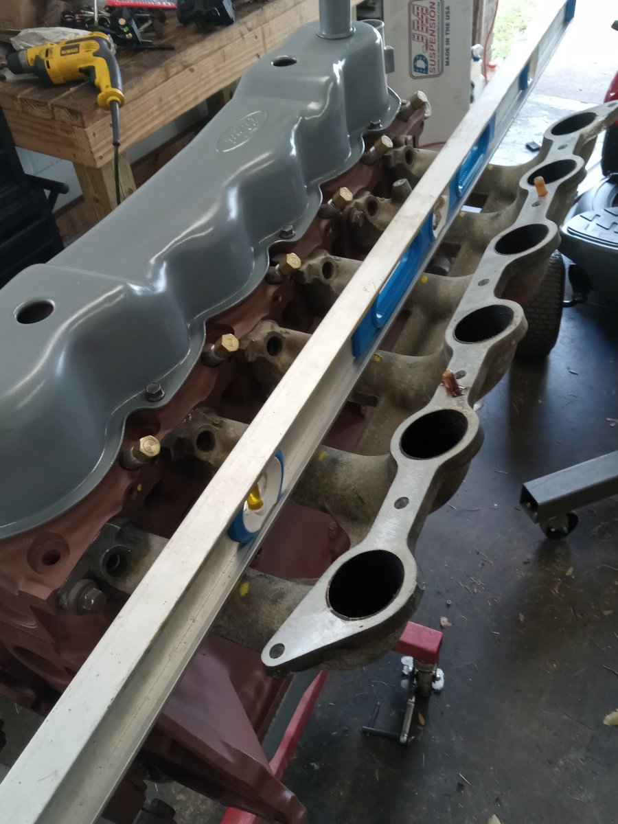

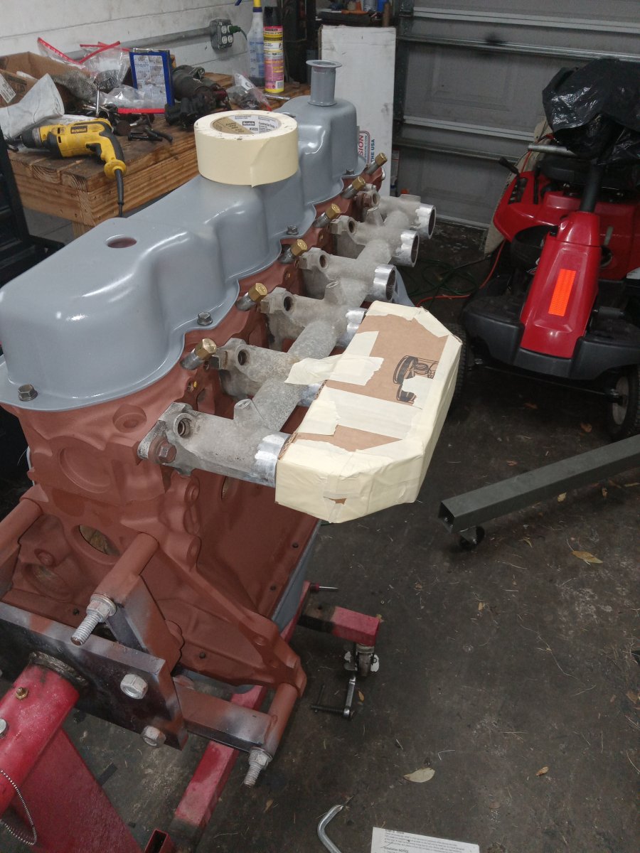

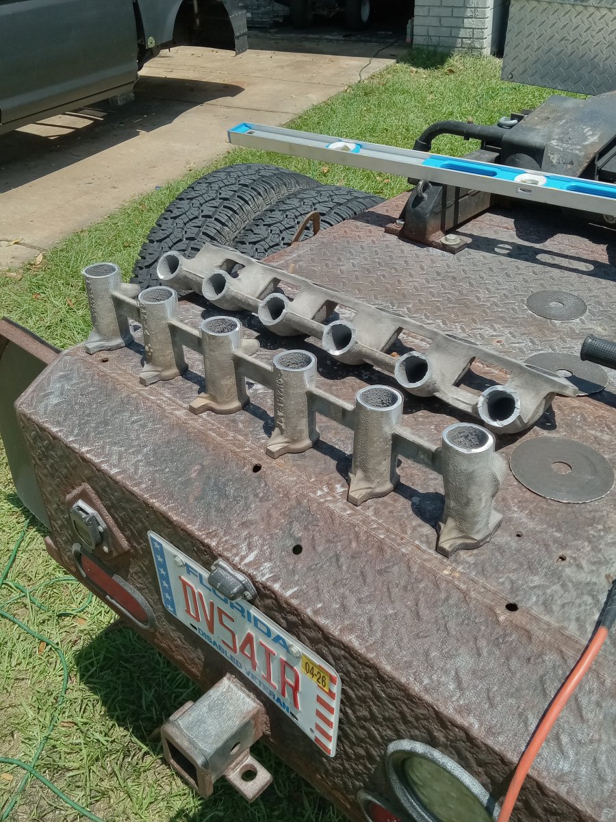

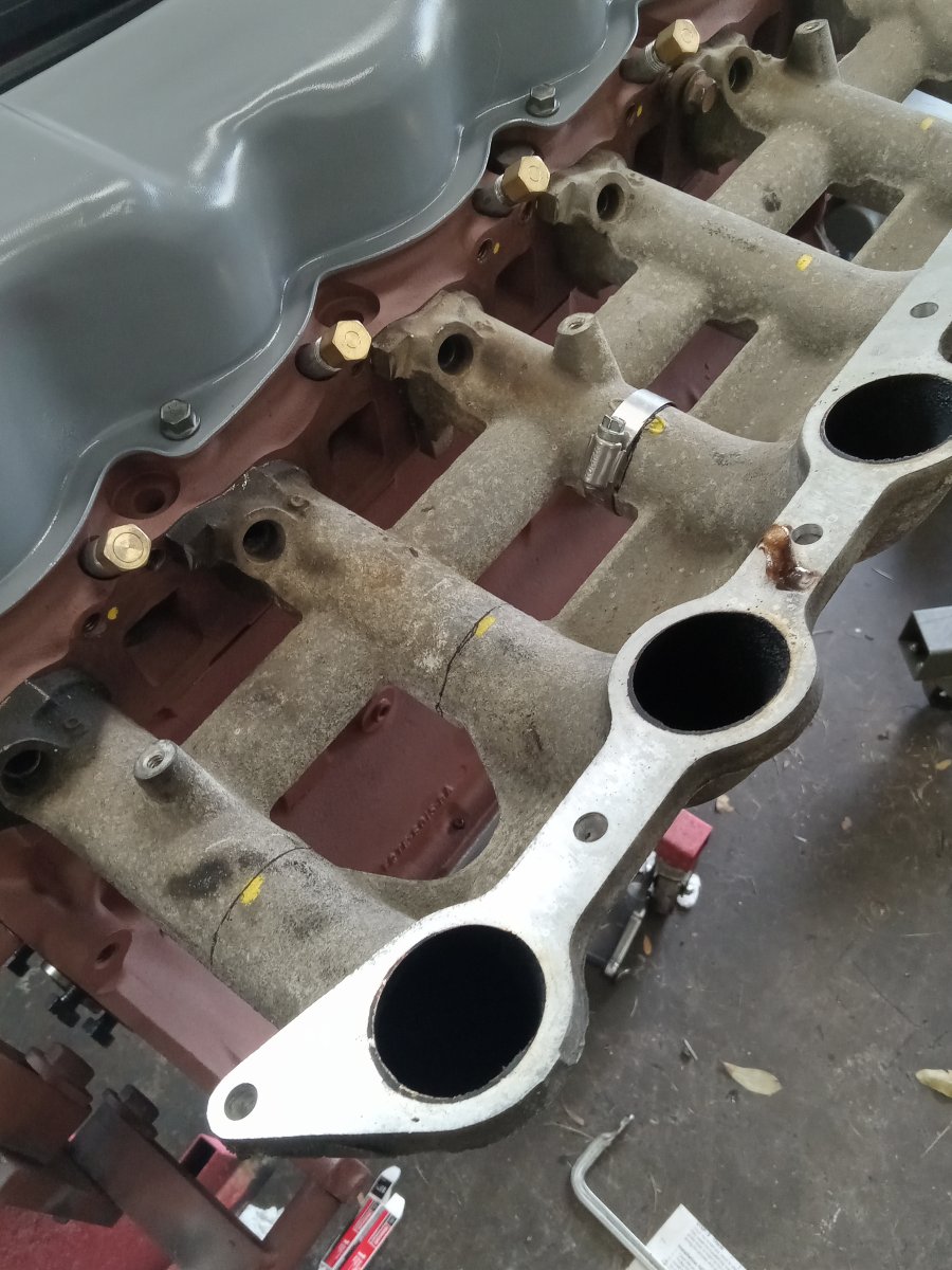

after spending this morning looking at custom intake manifolds i decided to start working on one for the 300. still havnt decided which carburetors im going to use but they are going to be one or 2 barrels.
im still amazed at how long the individual stock runners are. they are a little over 10in long when the upper intake is bolted to the lower.

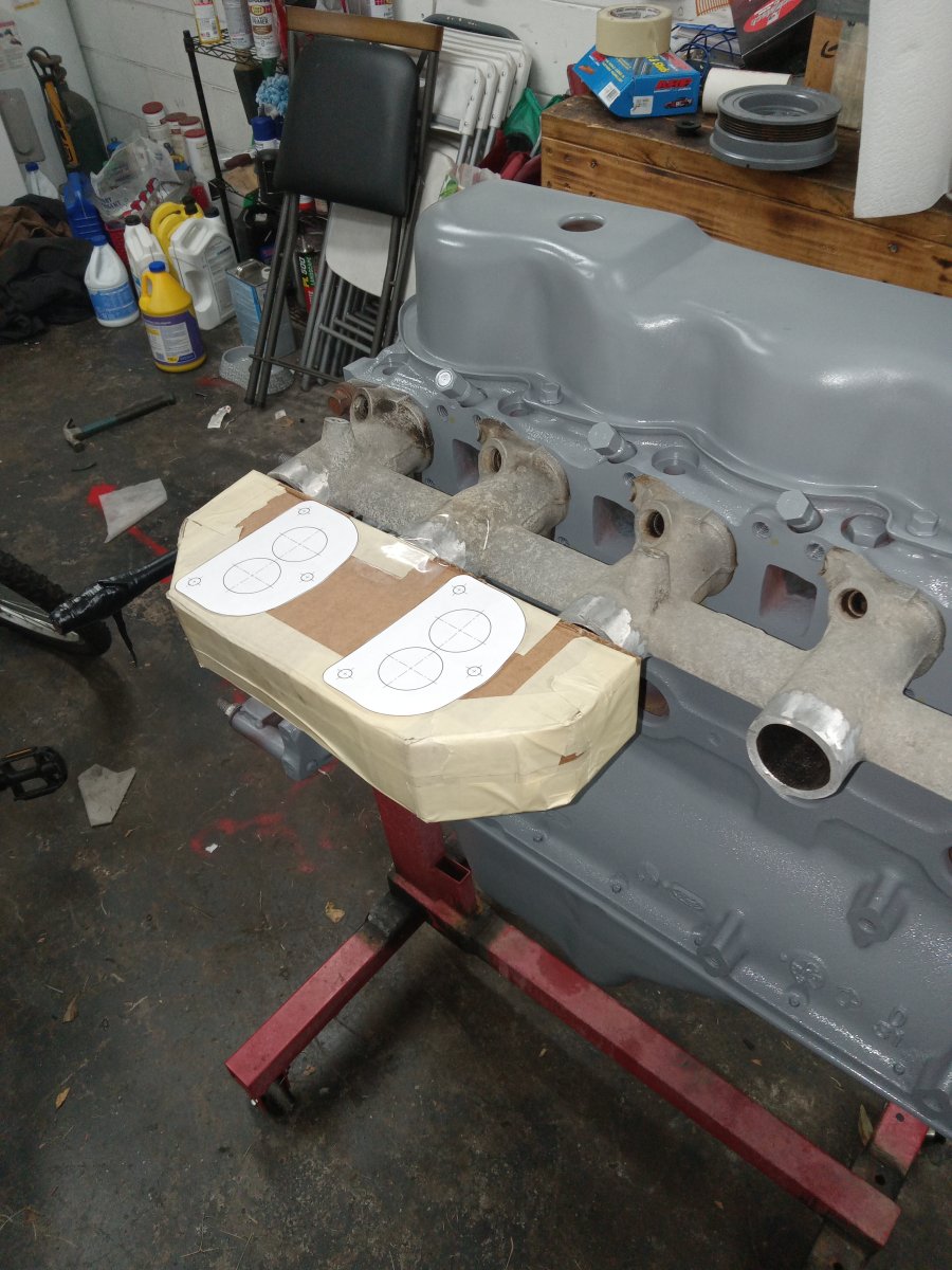

me using a hose clamp to make a strightish cut line.

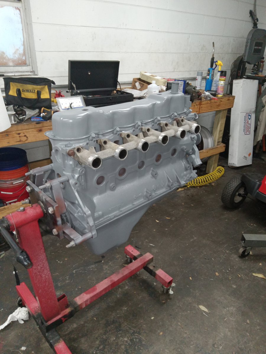

now every time i look at the intake i cant stop thinking of individual carbs
something like this. 1 carburetor for 3 cylinder.

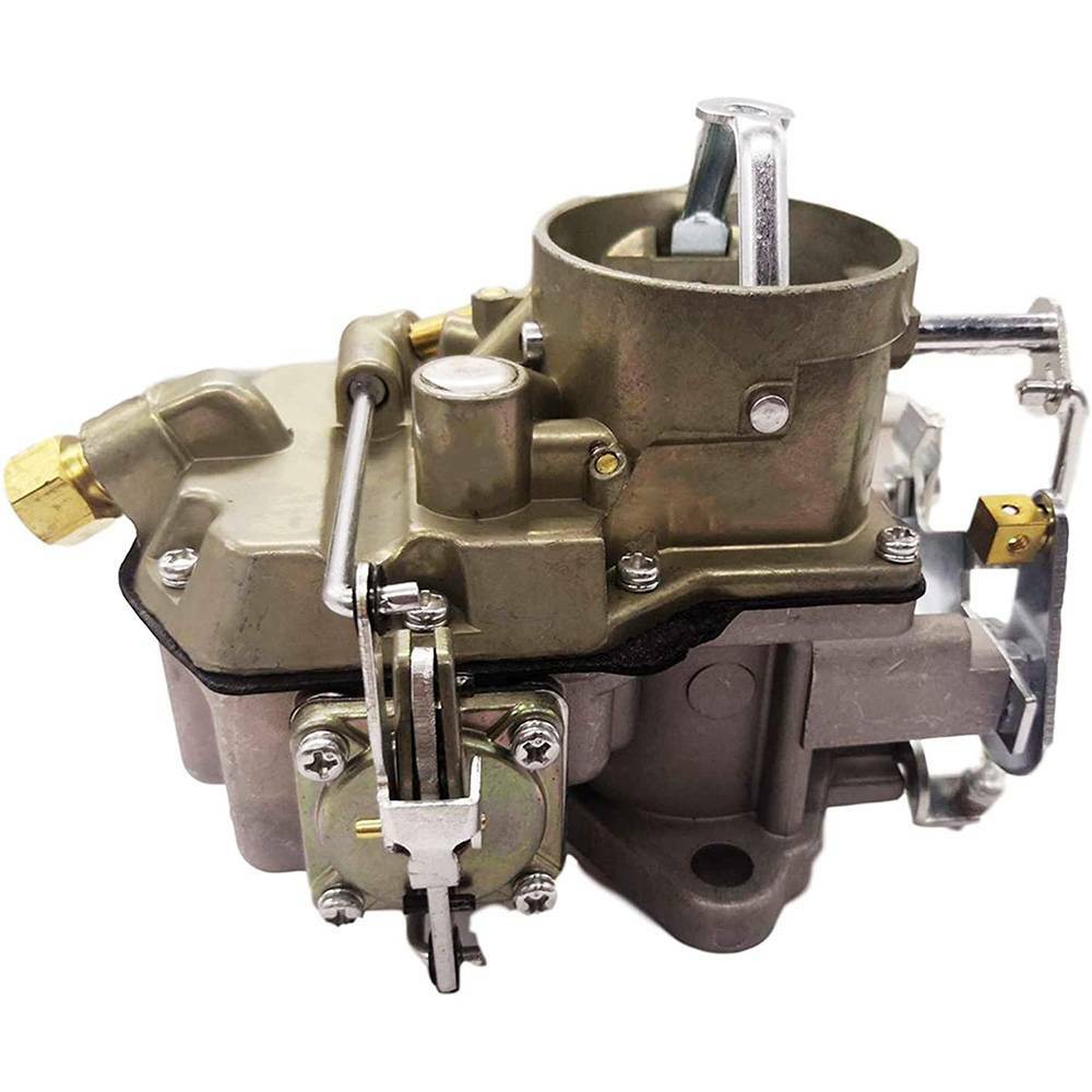

still cant decide weather to use 2 Ford autolite 1100s or 2 Stromberg 97s

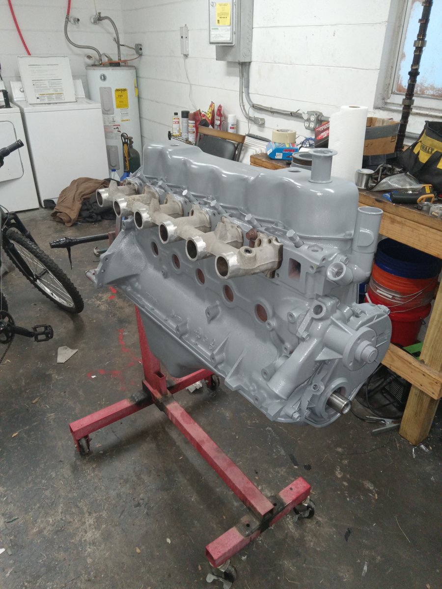

after doing some research i decided on using 4 Stromberg 97s, its close to individual carbs. lol

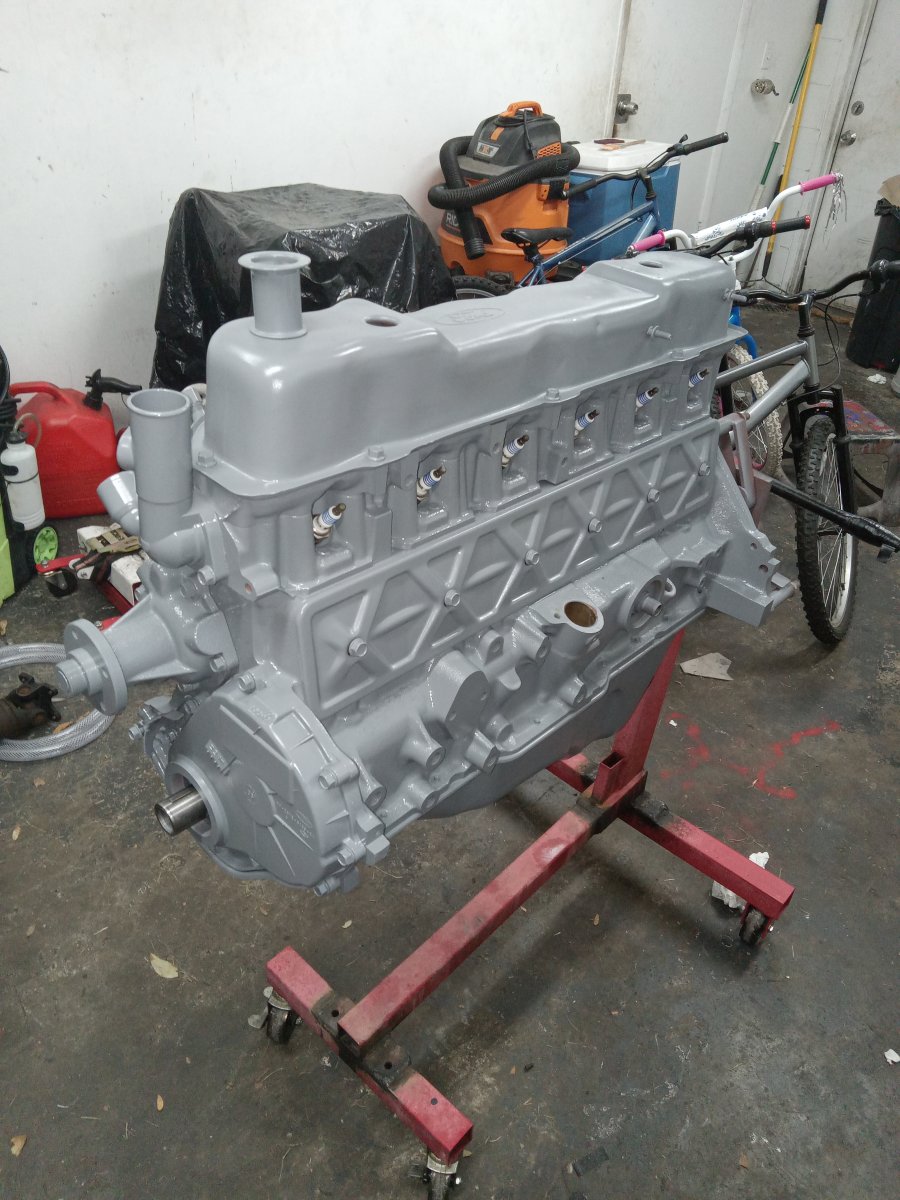

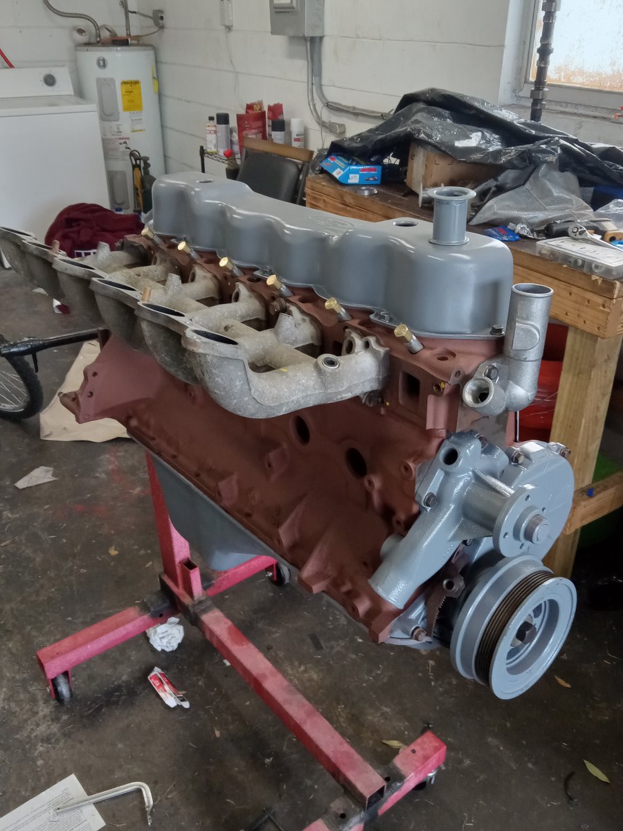

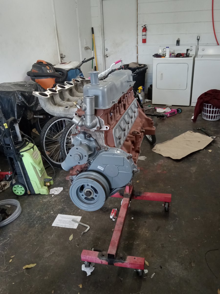

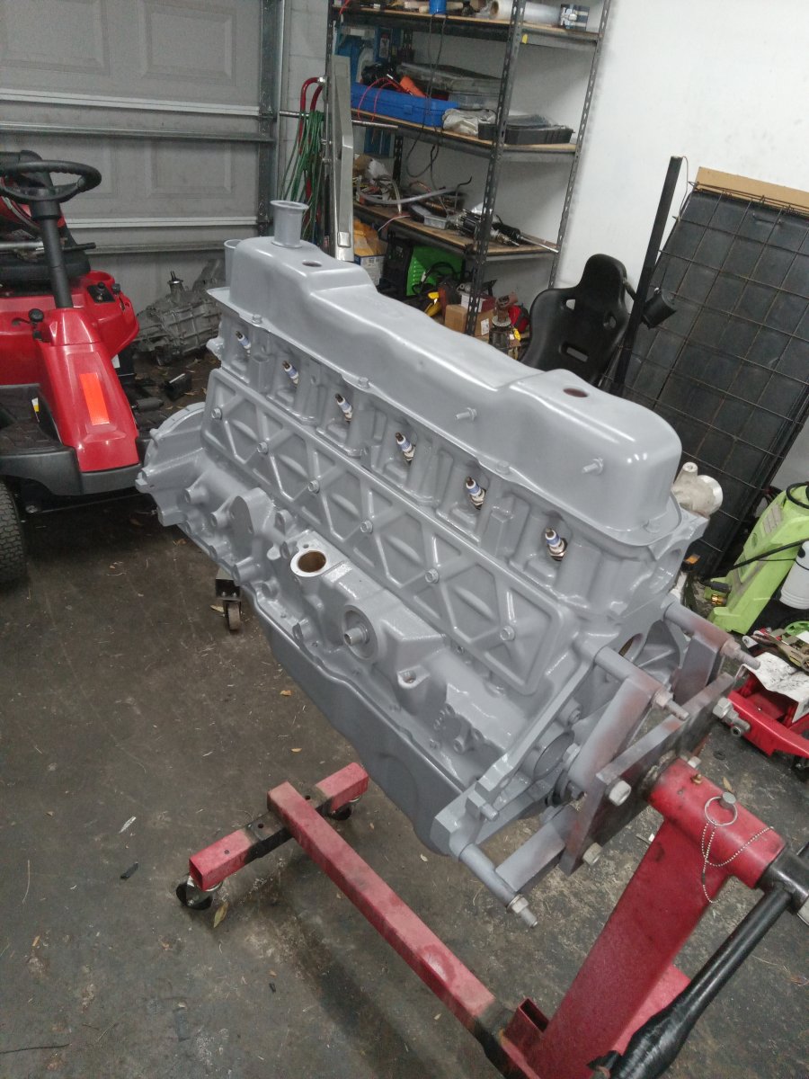

Threw some paint on the engine. since the Ford 300 was used in alot agricultural and industrial equipment i went with Rustoleum Gray.

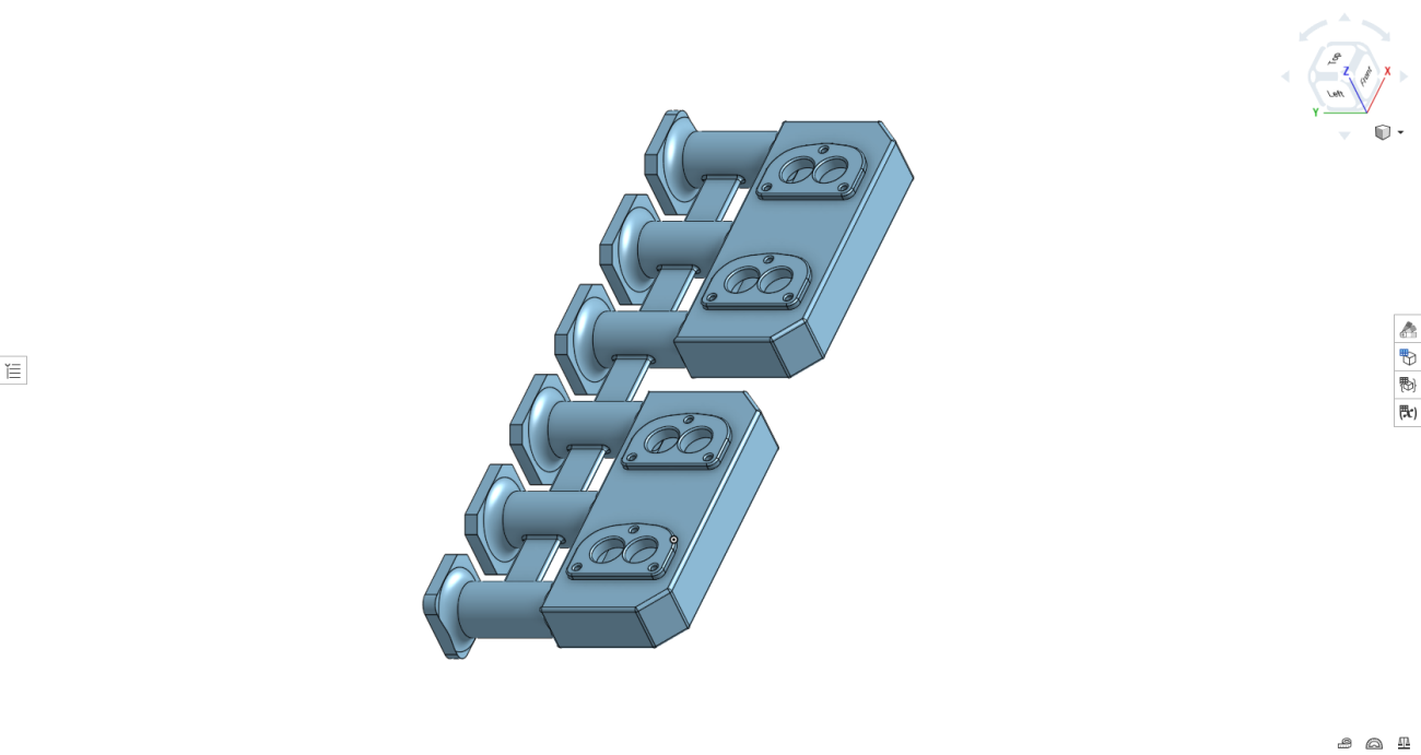

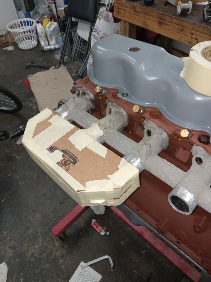

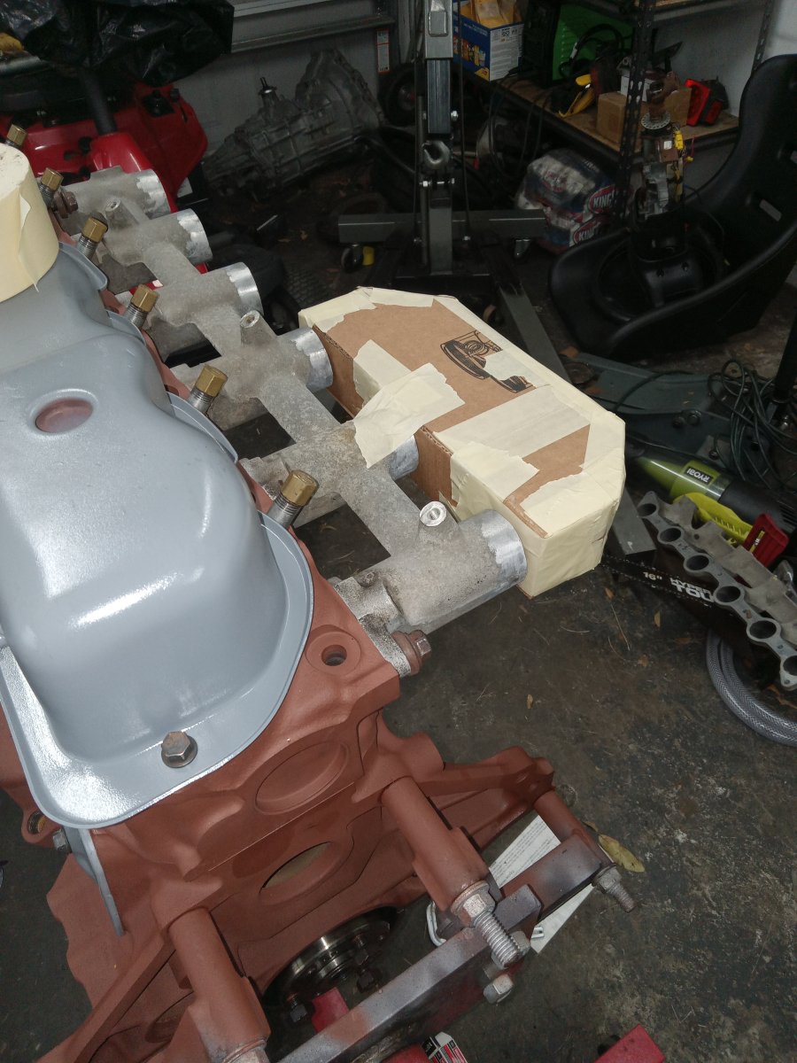

Here is what the intake setup will be. 4 Stromberg 97s, 2 carbs for 3 cylinders. its not the best setup but it will catch some eyeballs at a cars and coffee.

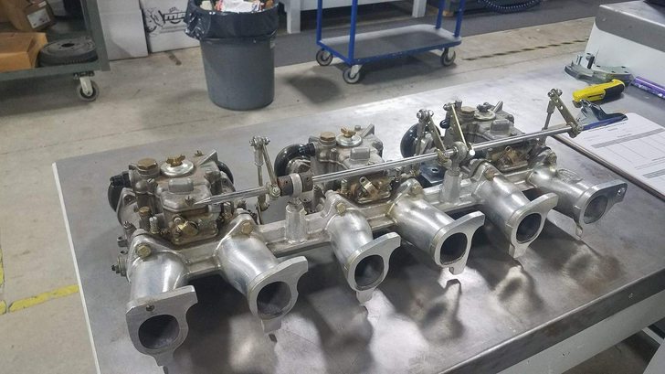

Weber IDF...
3 of them... a barrel per cylinder.
That's just the VW guy in me coming out...

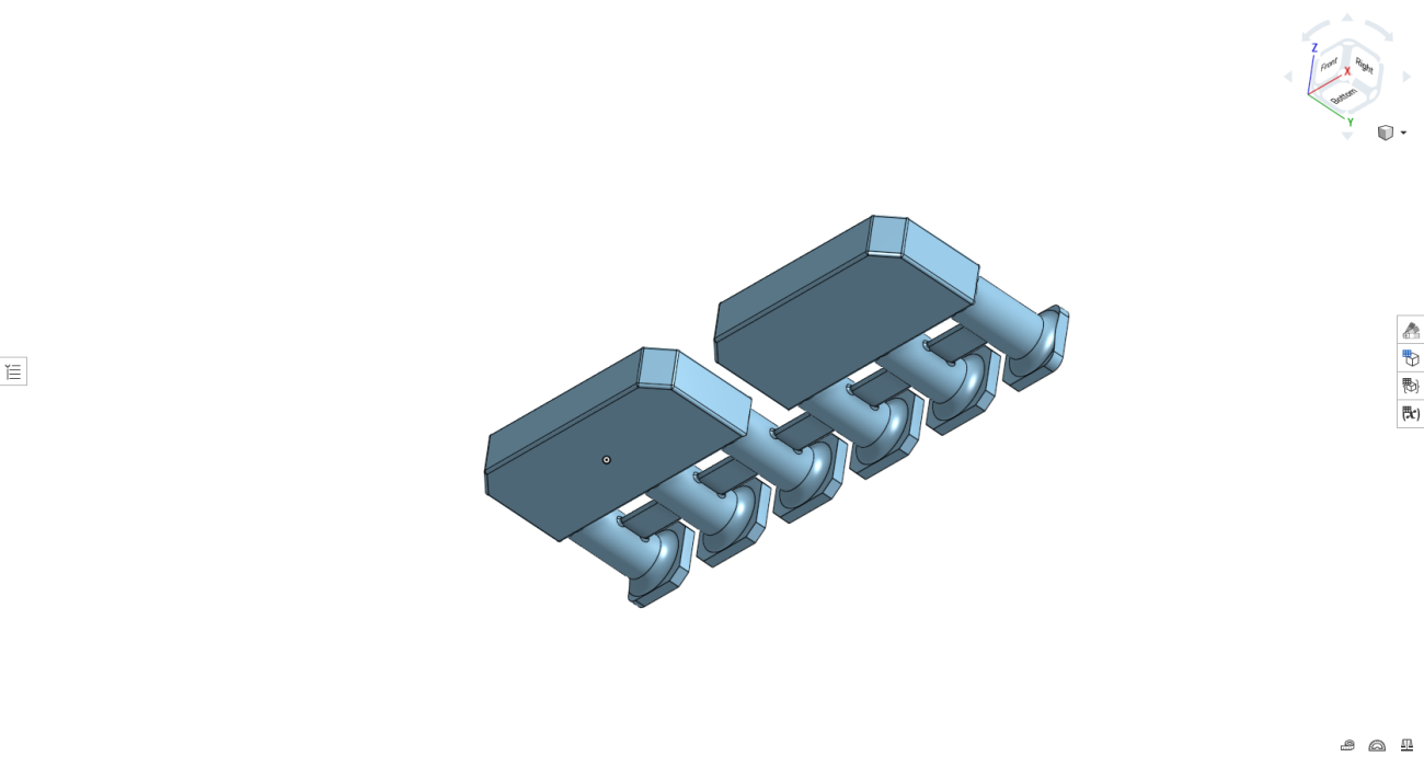

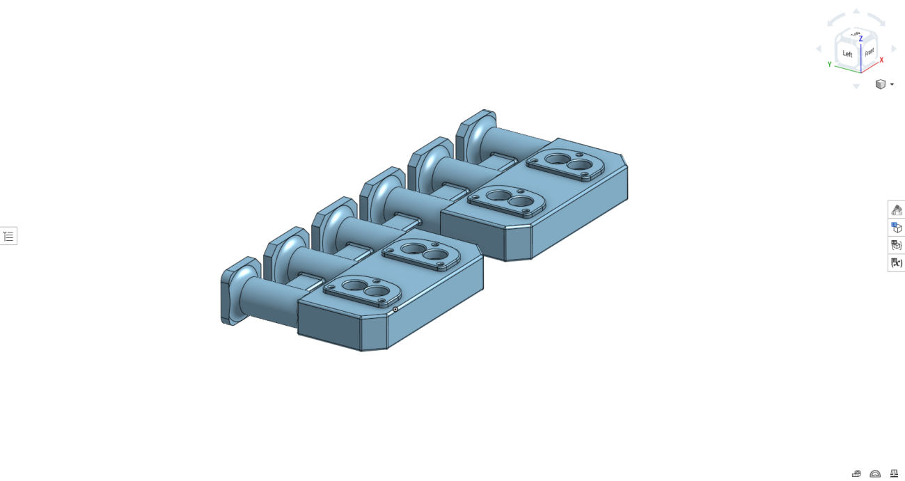

that stetup is the best looking one in my opnion. the only reason im deciding to go with 4 smaller carburators ( 2 per 3 cylinders) is that if one of the webbers goes out of tune or craps out, 2 cylinders are affected. if that makes sense.
here is example of how i think of it.
3 carbs = 600cfm total
3carbs - 1 carb =400cfm
VS
4 carbs = 600cfm total
4 carbs - 1 carb = 450cfm
and the loss of cfm is distributed between 3 cylinders insted of 2

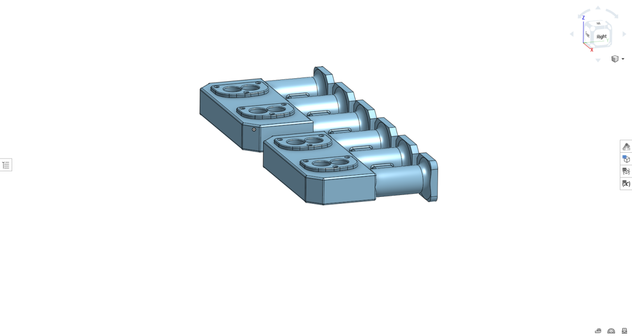

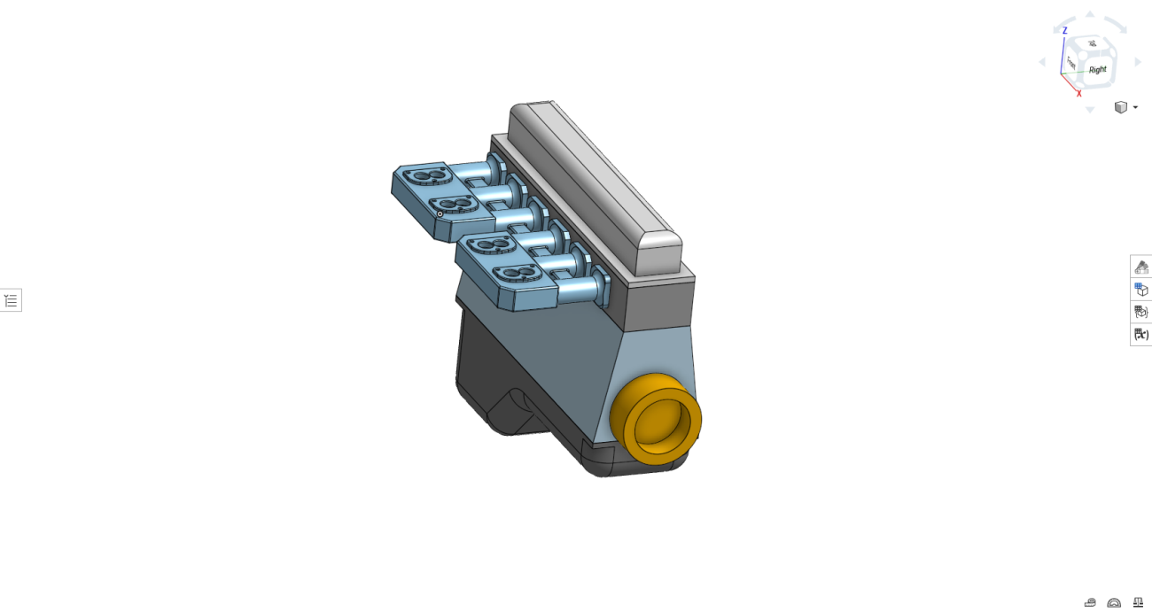

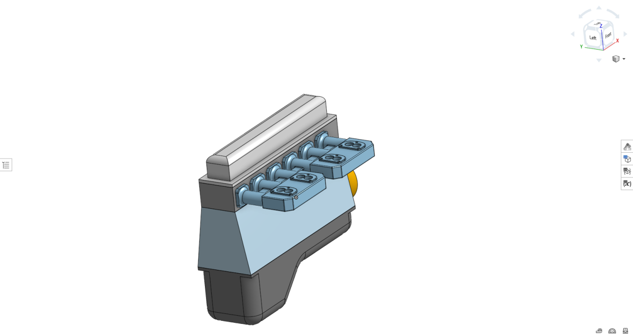

Here is the design im going with.
