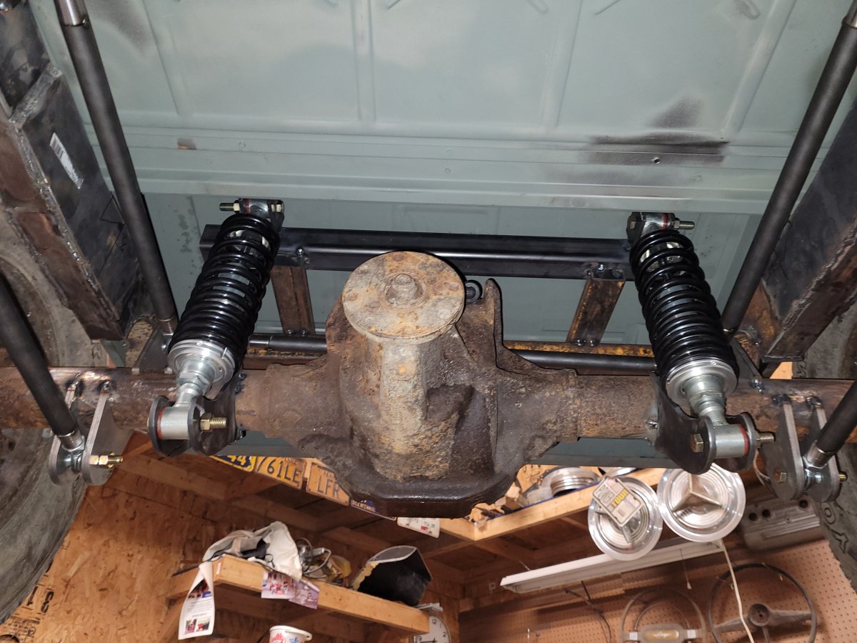

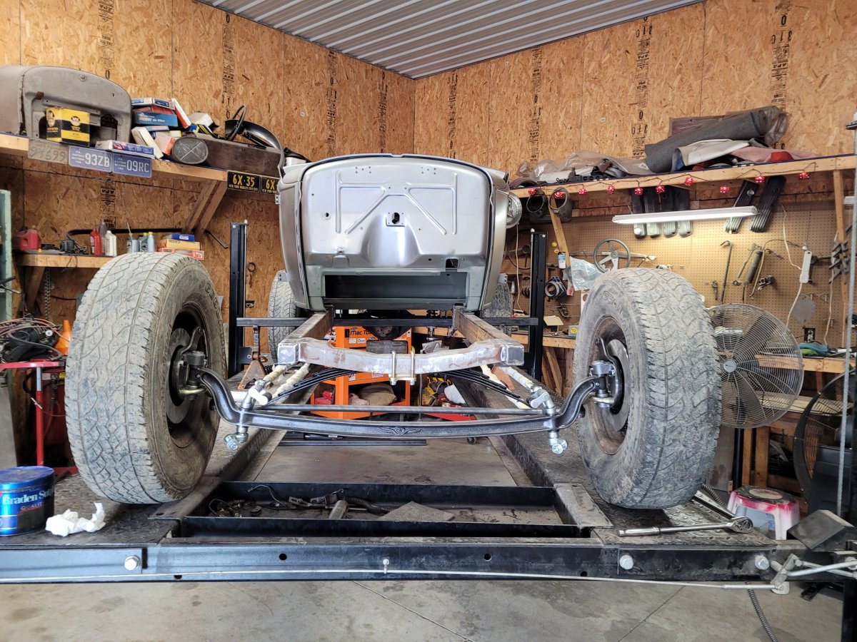

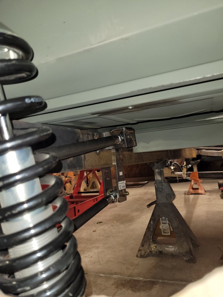

Did some coil over mock up gonna look for a good way to make the top mount without cutting my truck floor up.

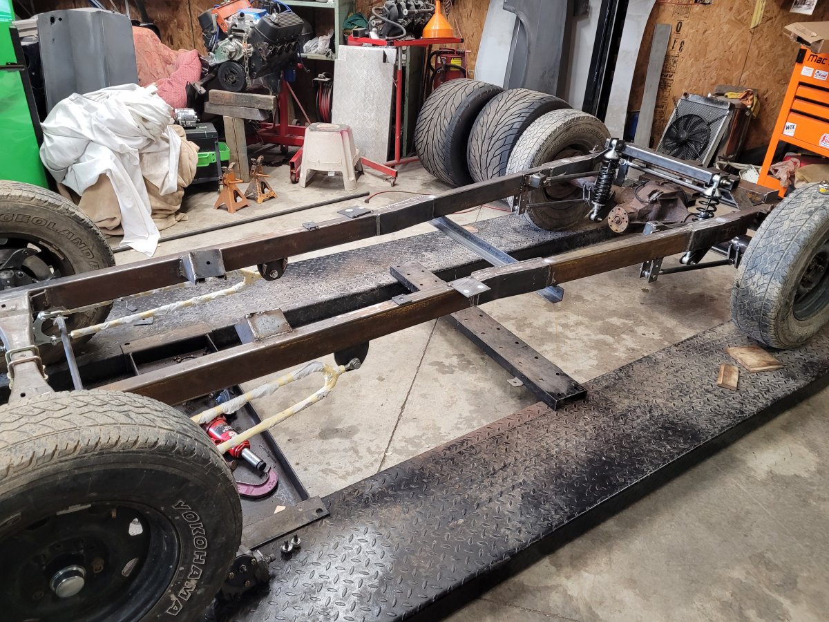

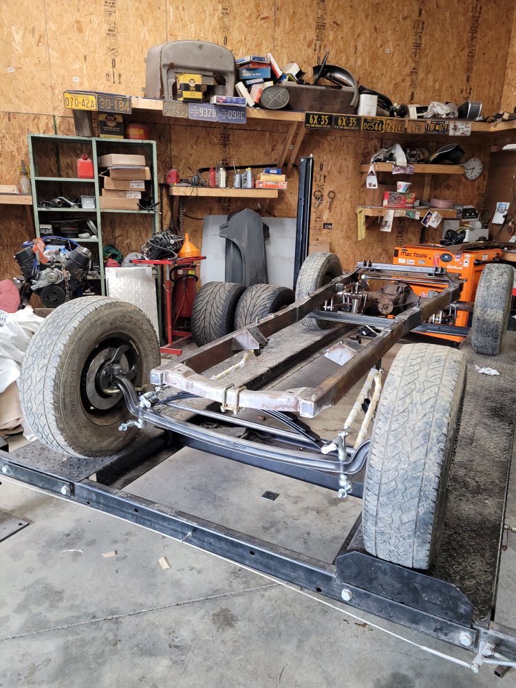

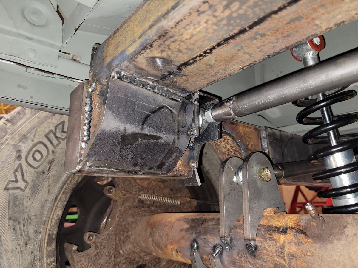

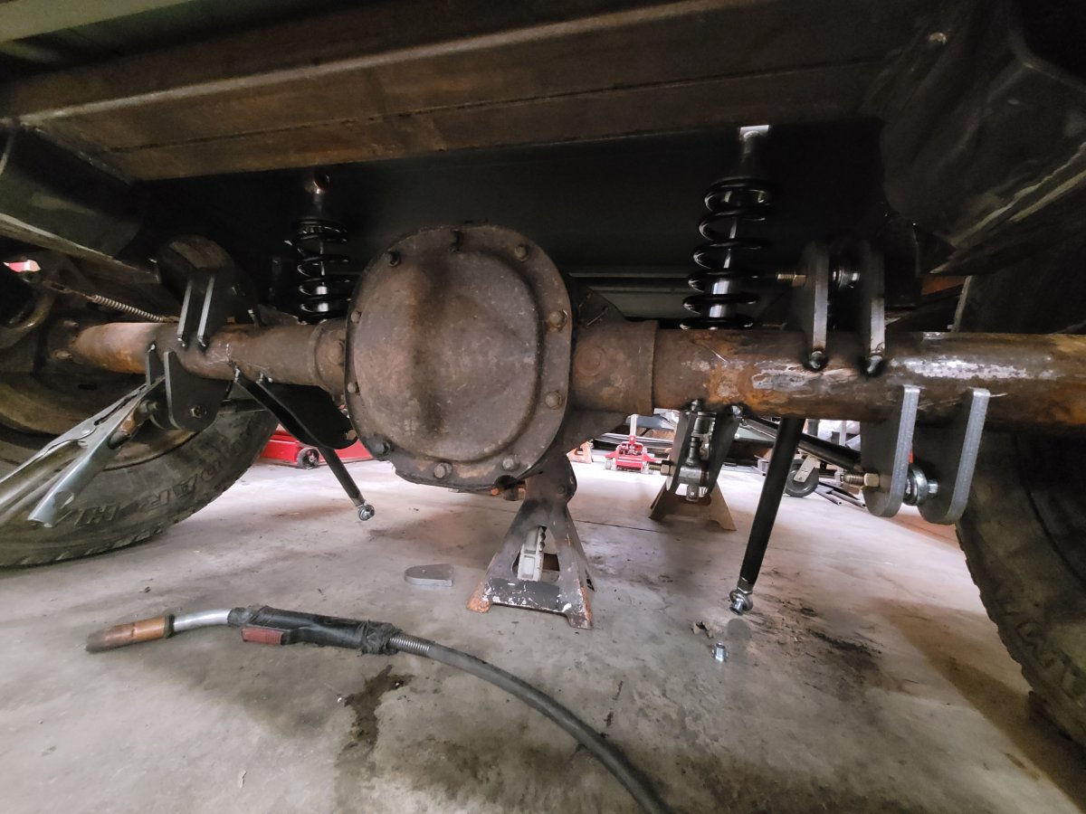

Another day more tacking.....

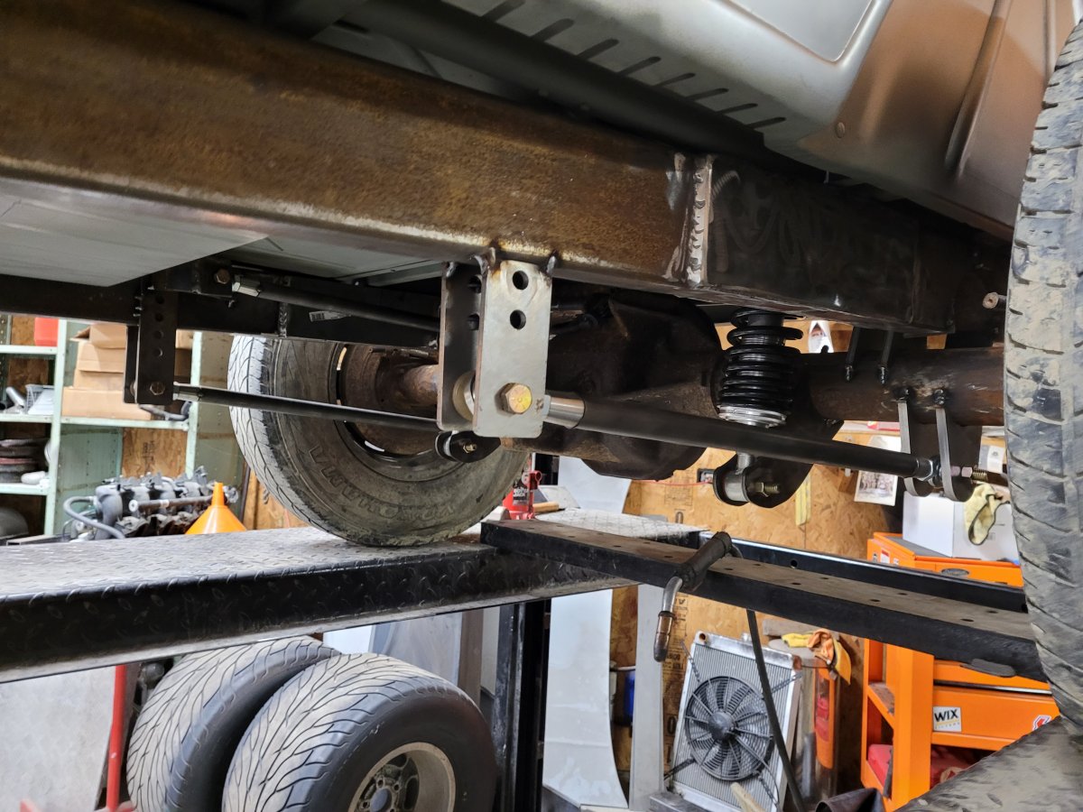

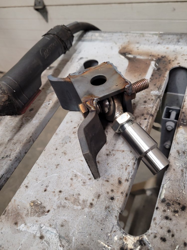

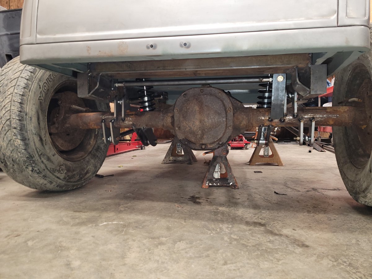

4 link, panhard bar, made mounts for the front of the uppers.

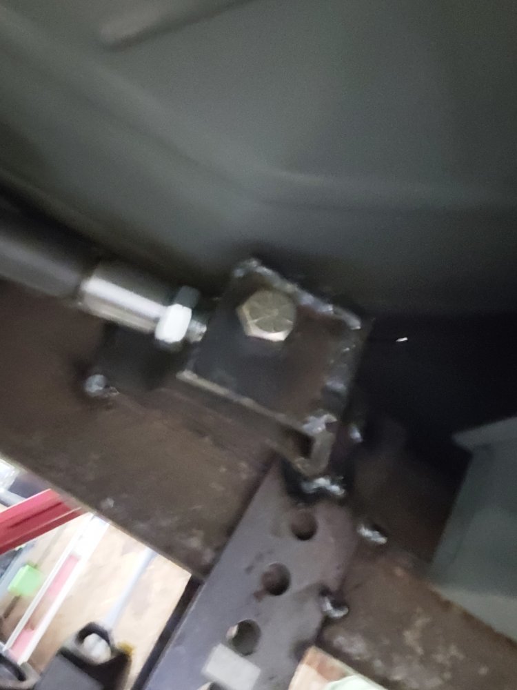

The welds in the third to the last picture looks really cold.

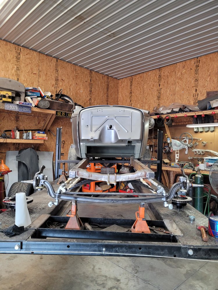

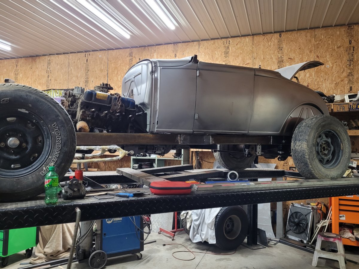

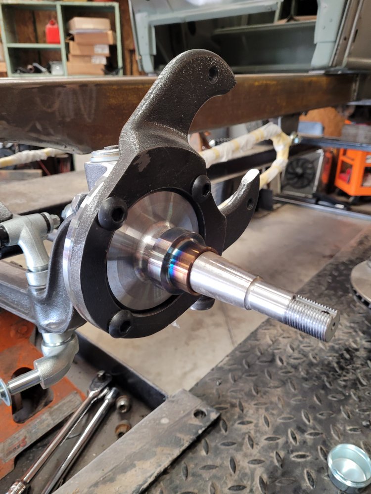

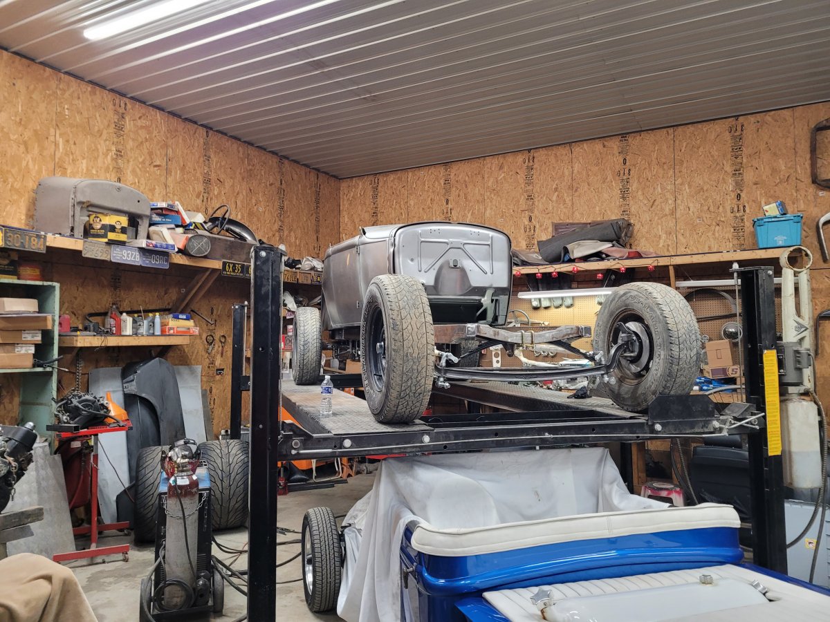

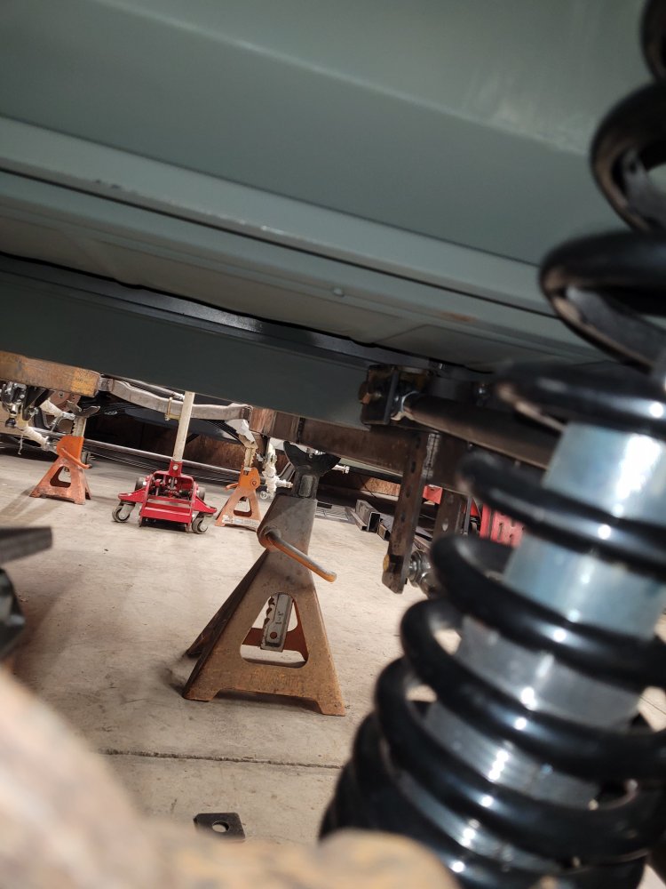

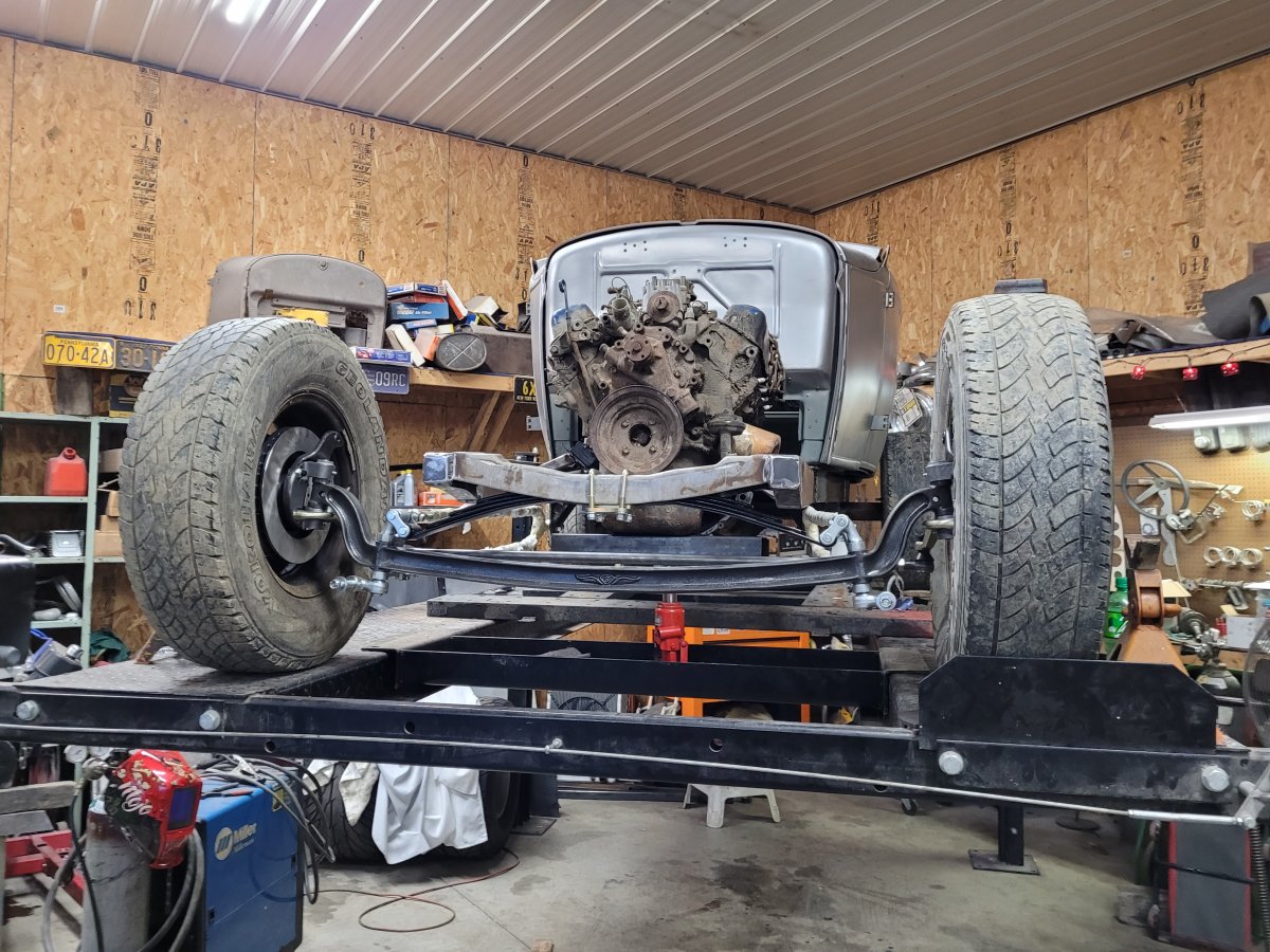

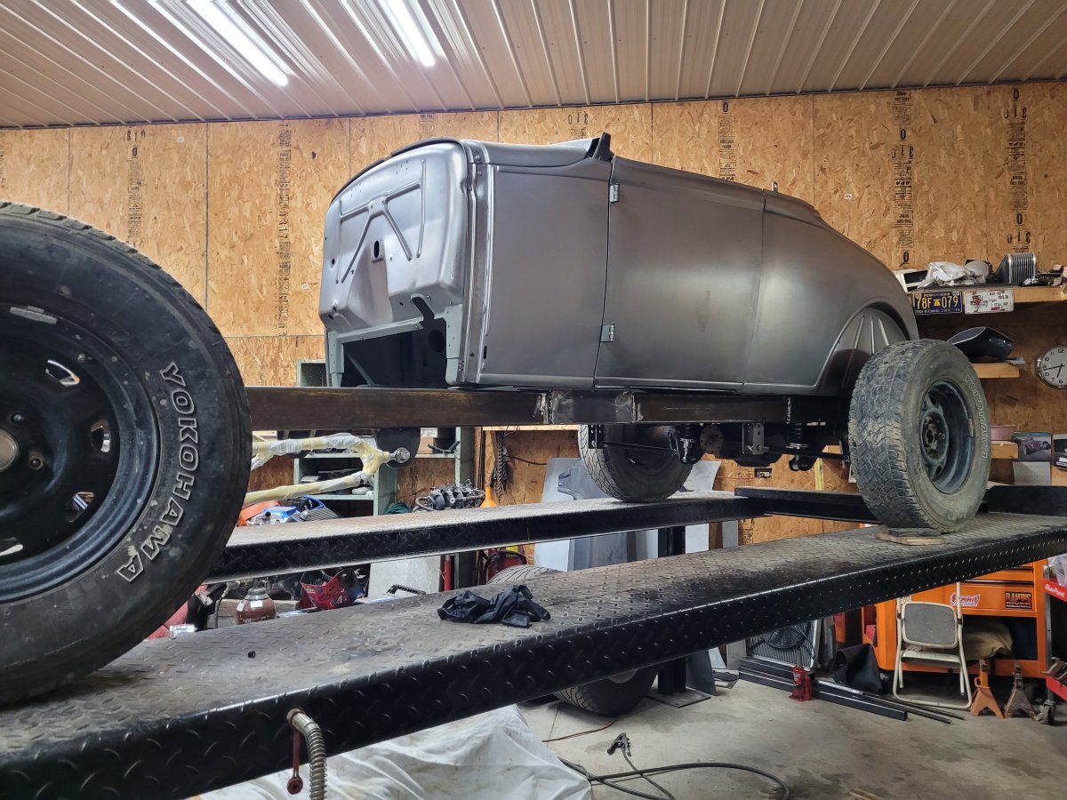

Moved it on the lift put the bearing adapters on the spindles also the rotors and bearings so it sits on the tires and started on the top of the coil mounts.

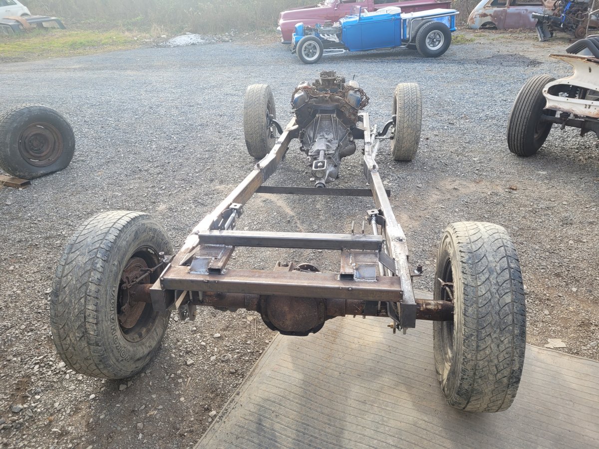

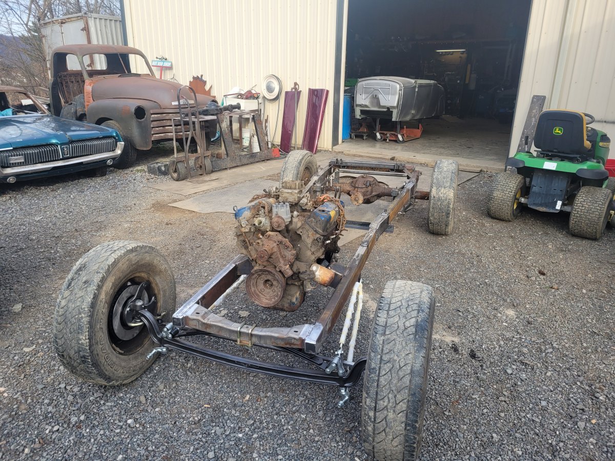

Starting to take shape, but before you go too much further, do you think it might be time to clean the frame and paint/coat it? In previous pictures the frame and other parts had lots of surface rust. Now's the time to do something about it before everything's in place and you can't easily access these areas.
The car gets almost completely assembled then taken back apart completely. after all the holes are drilled all the welding is done and grinding is done also after brake lines get mapped out and half a dozen other things that need mounted either in the frame or along side it. After all that it gets sand blasted and painted.

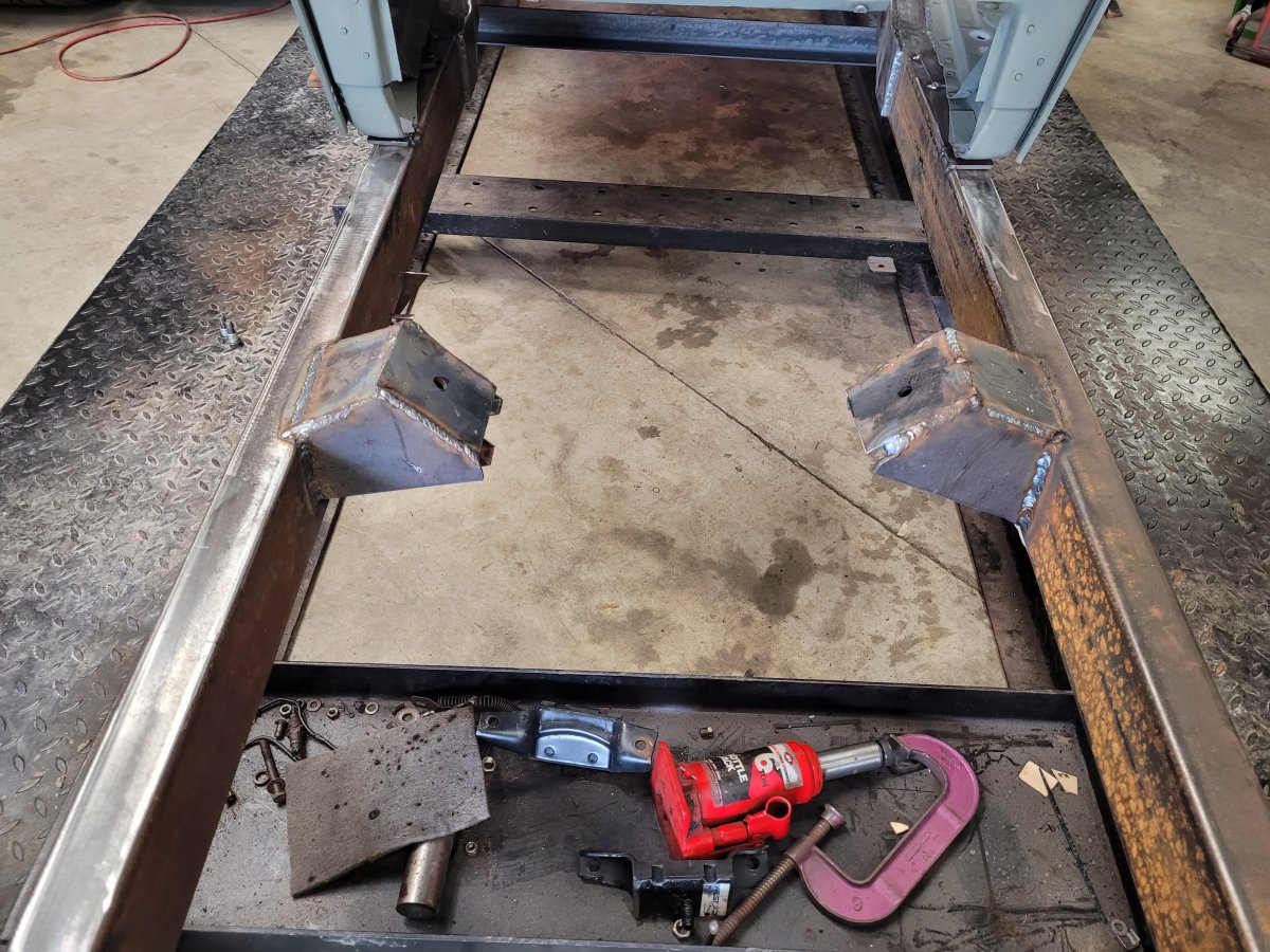

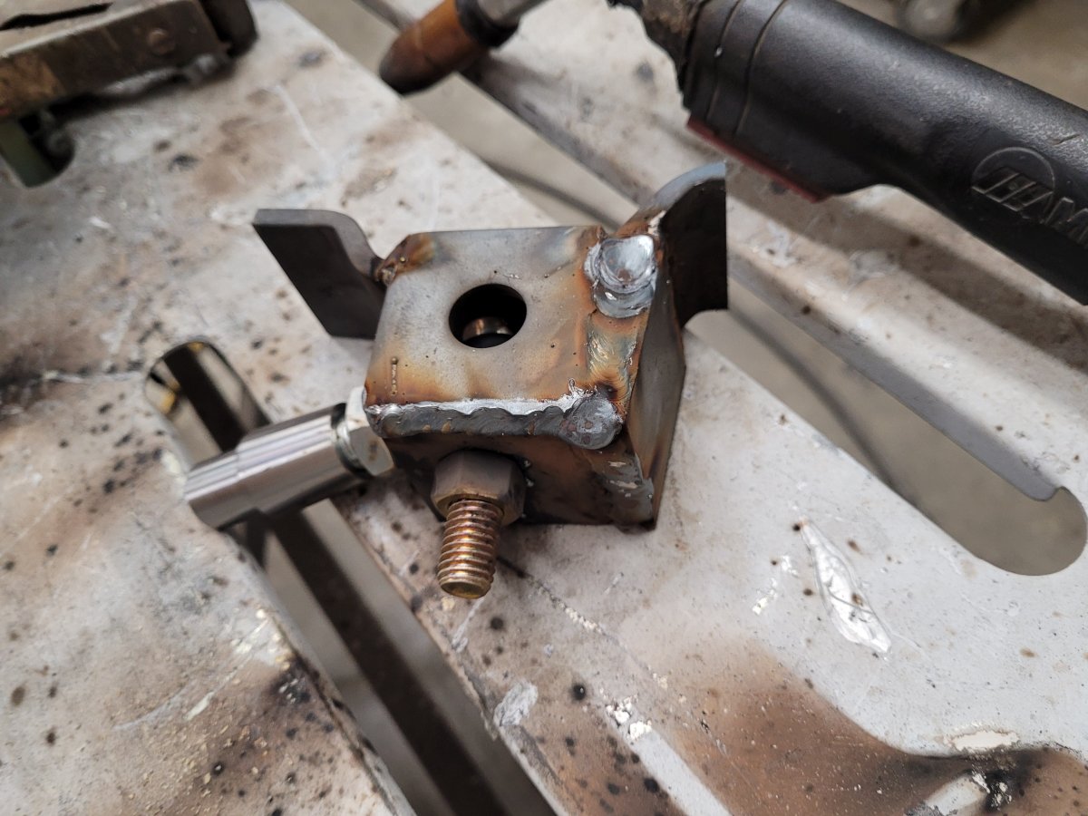

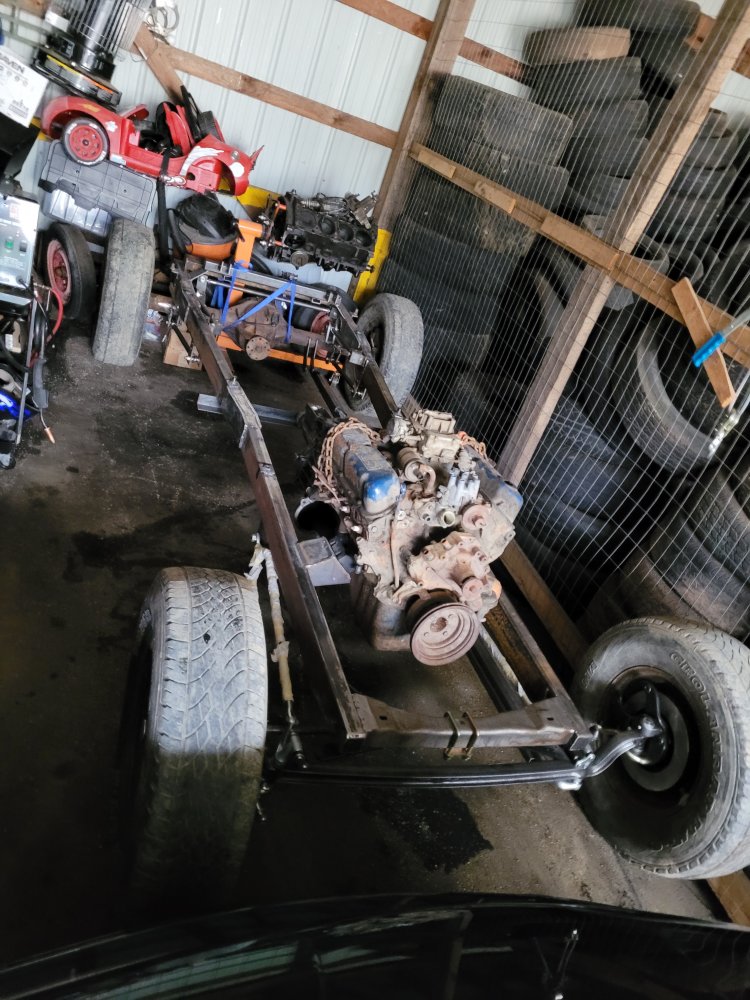

Started on motor mounts and a temp trans mount until I get the TKX. Made a jig style motor mount that gets a steel plated cover/reinforcement.

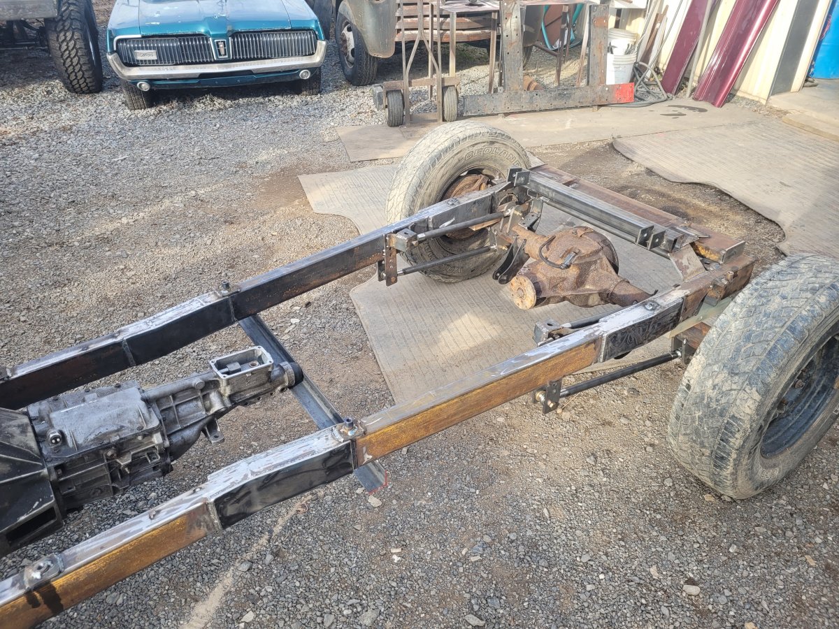

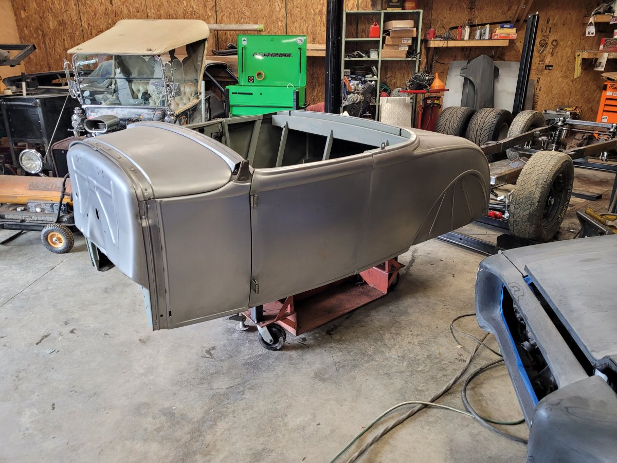

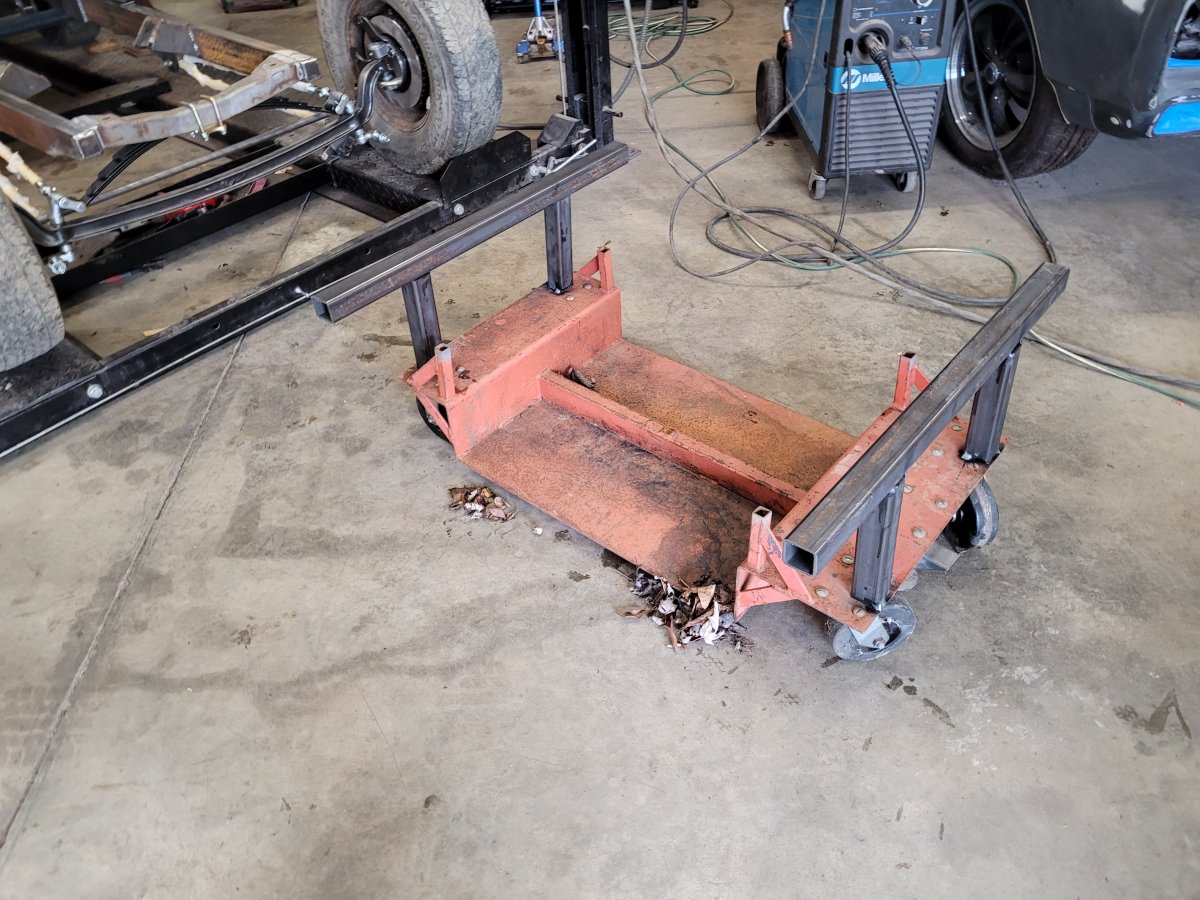

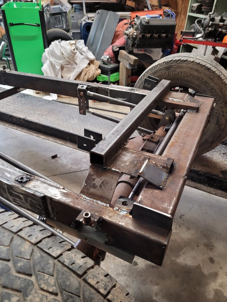

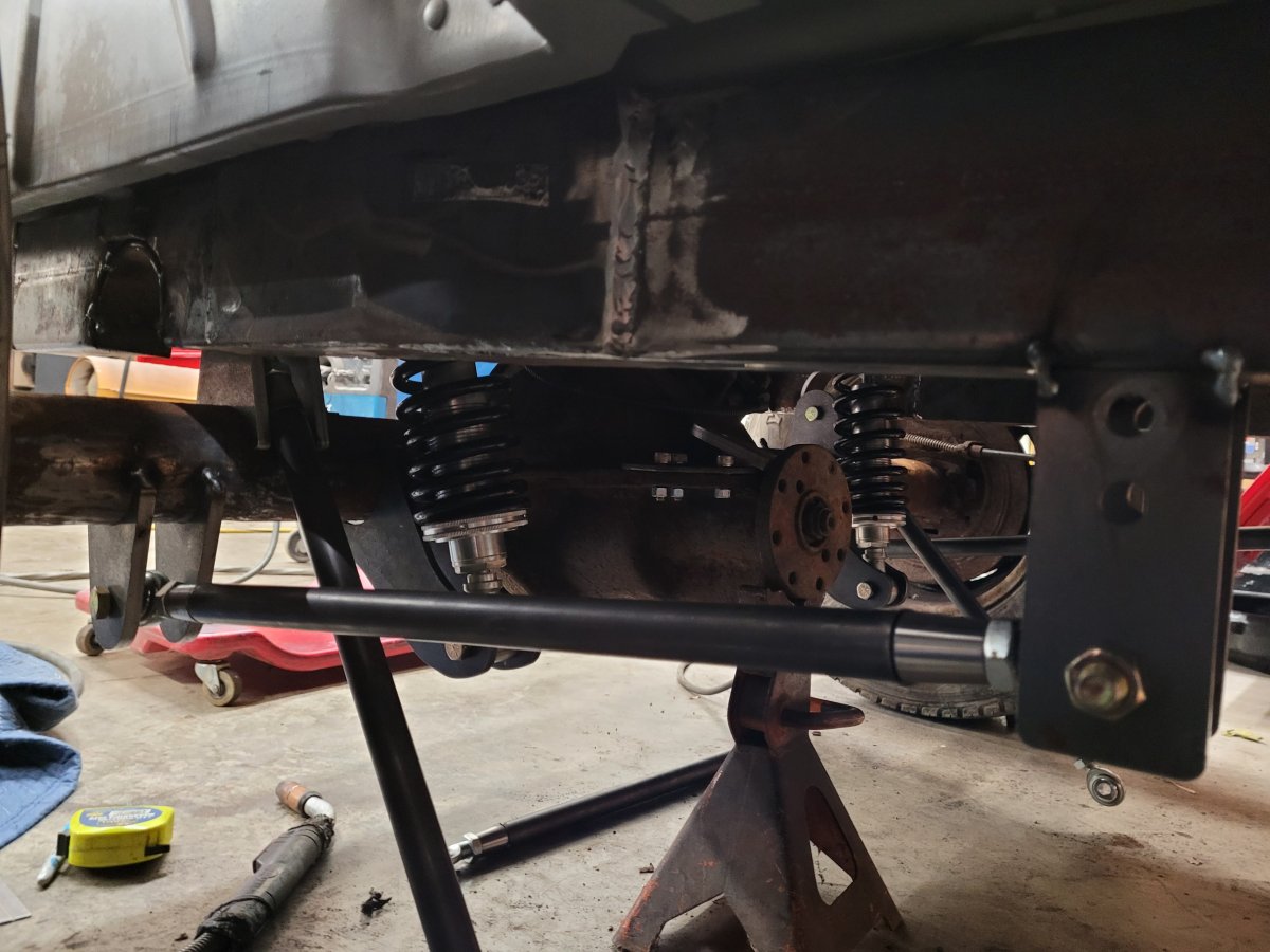

Did the body mounts and motor mount, did some more reinforcement of the coil over mount. Put it in storage for now until I get the rear blasted and get the tkx so we can do the trans crossmember and mafe a jig for the body so we can prep and clear coat.

I like the motor mount brackets you built, those flat biscuit mounts flat heads used were only slightly better than solid mounts. I also like that you pruned off the frame horns instead of having them stick out like so many do.
Are you planning on boxing your link mounts? Just a thought if you weren't already
I agree about the frame horns, that look is so much cleaner
