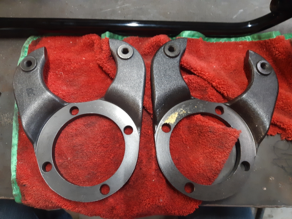

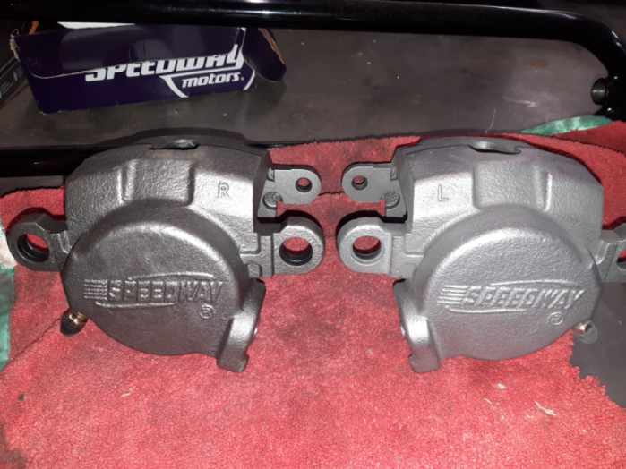

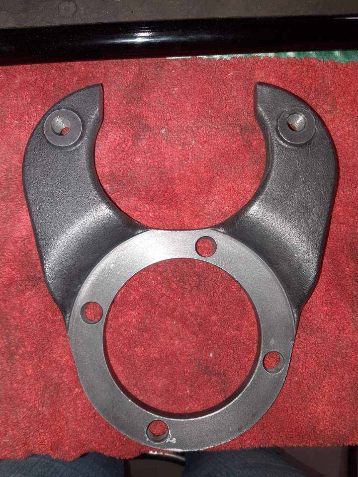

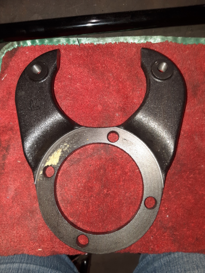

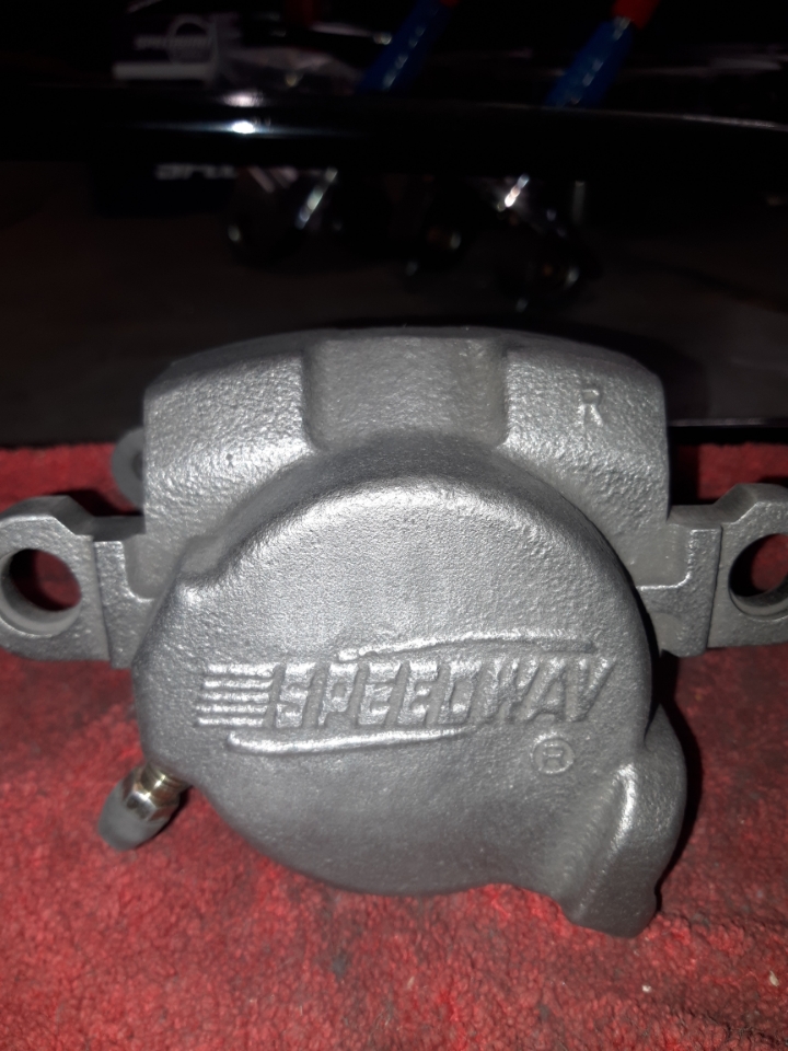

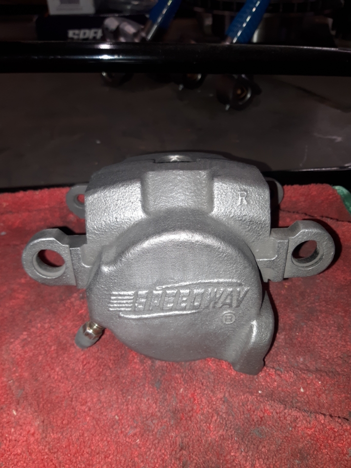

Had the woman scotchbright some parts for me today on her day off....
She wanted to be involved.... lol
So here are some of the parts she did before and afters....
66664
66665
66666
66667
66668
66669
66670

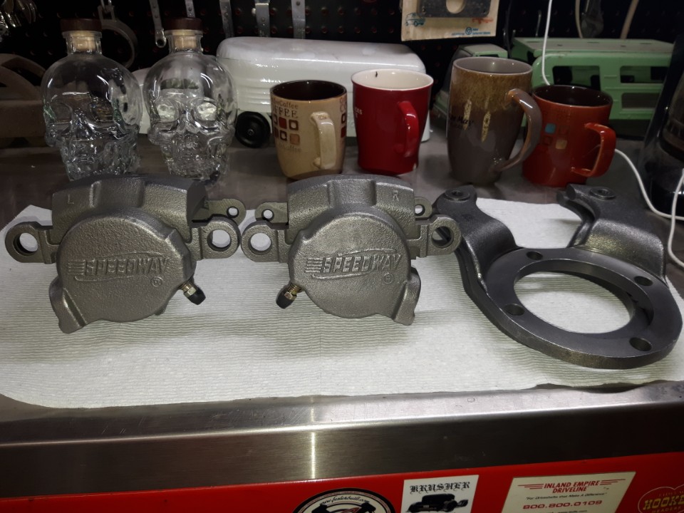

She took the pics, mounting brackets get clear coated, calipers and rotor hats go black, the front axle gets clear coated... along with the other parts for the front axle that wont get paint just heavy amounts of clear.
Going bare metal look on alot of the parts.

The last picture indicates you probably need more coffee...
I also see some cool old metal toy trucks... didn't think you were into that stuff.
My friend is, Thats his shop. My kid would destroy them if I collected them lol.

Had the woman finish prepping parts and she painted the rotor hats and calipers black. The front axle and brackets for the calipers got like 6-7 coats of clear.
