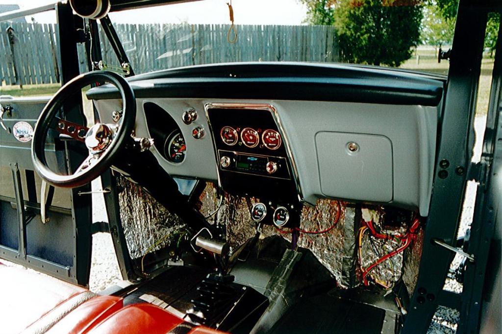

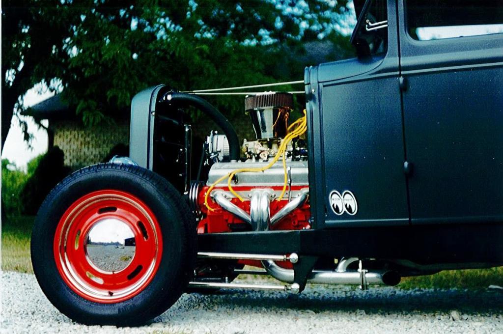

I've always wanted to build a street rod, start with frame rails on jack stands and end up with a car, but I knew I didn't want to keep a street rod clean so I built an orange Ranger.
65800
65801
Believe it or not my buddy drove this one in a few really bad snow storms from PA to Detroit and ran the hell out of it daily for awhile, its finally showing its age in some areas but it was built I think in 08.

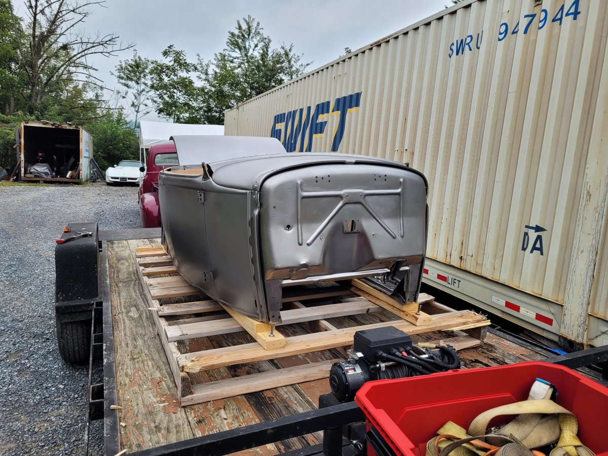

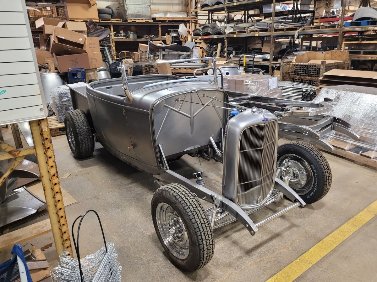

A sneak peak at the body
65813

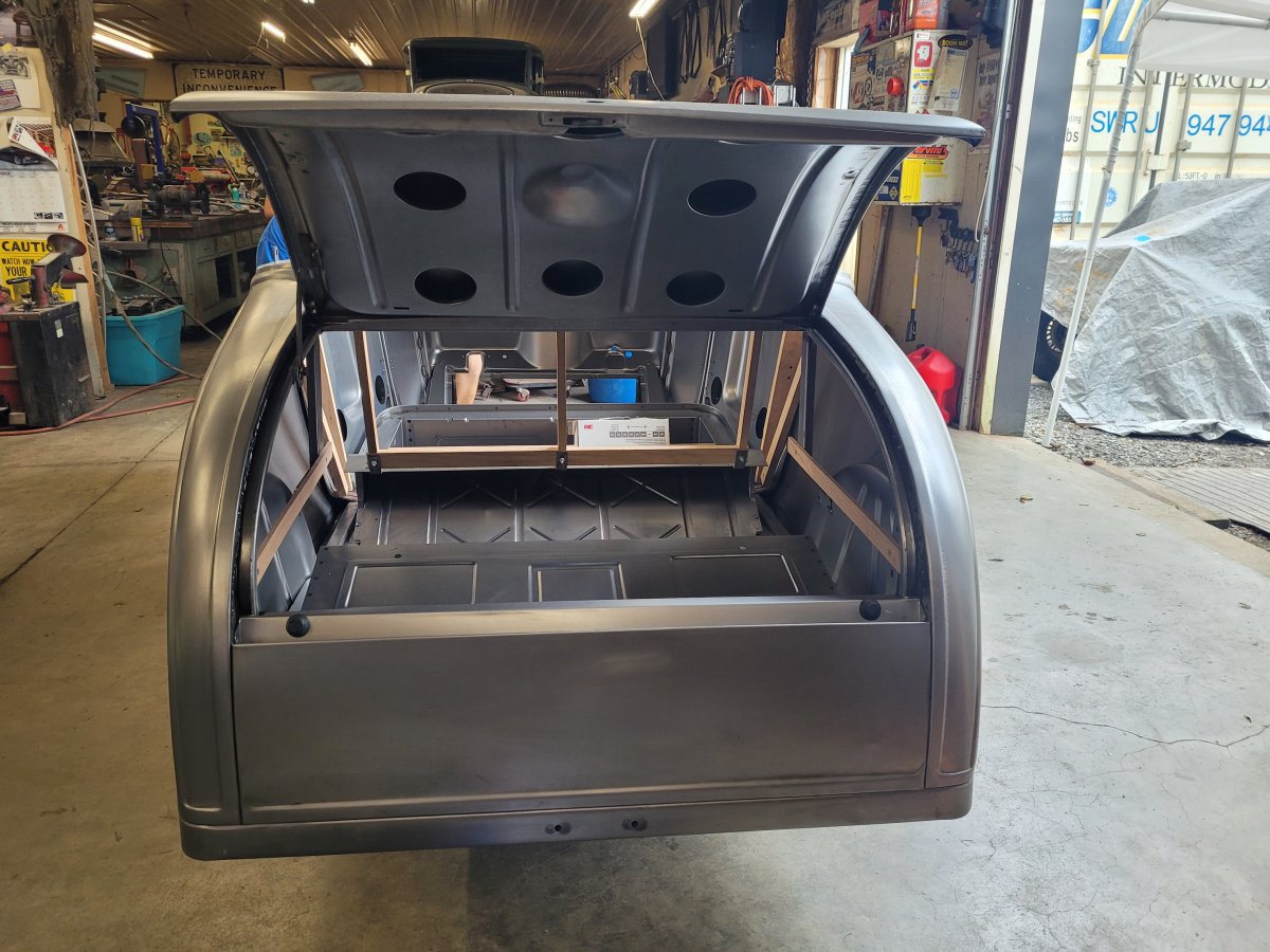

a roadster pickup they are building for someone.

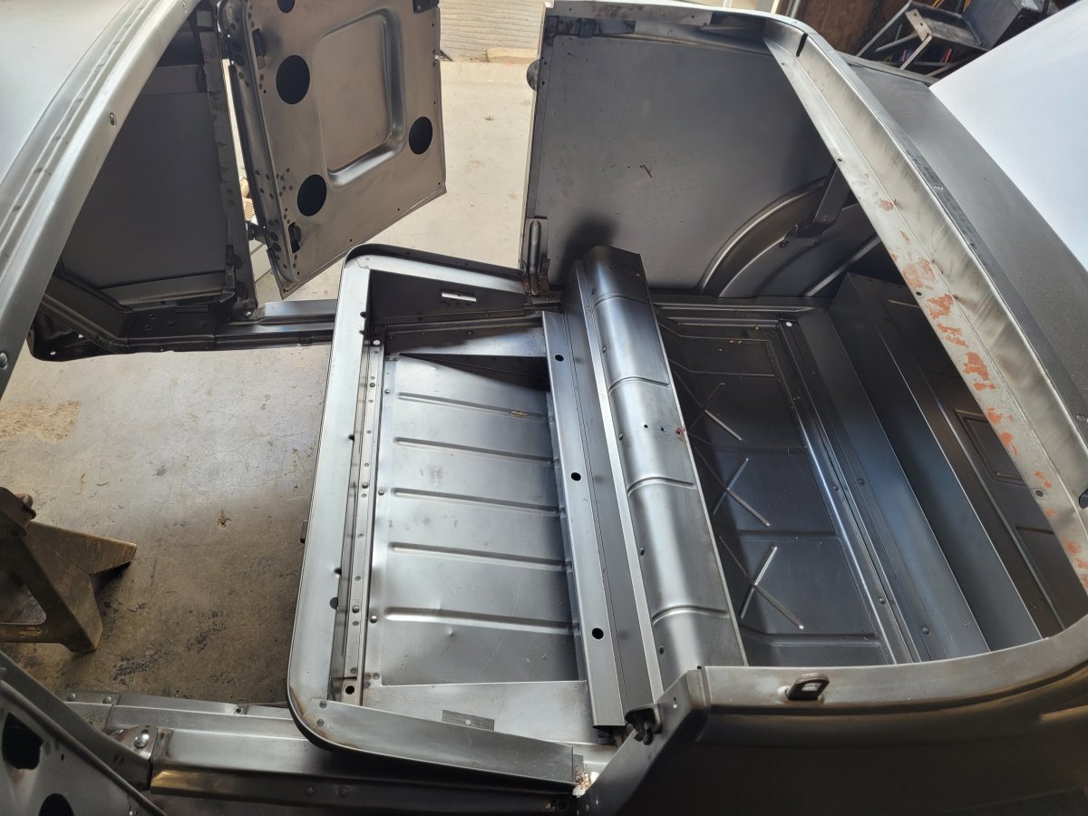

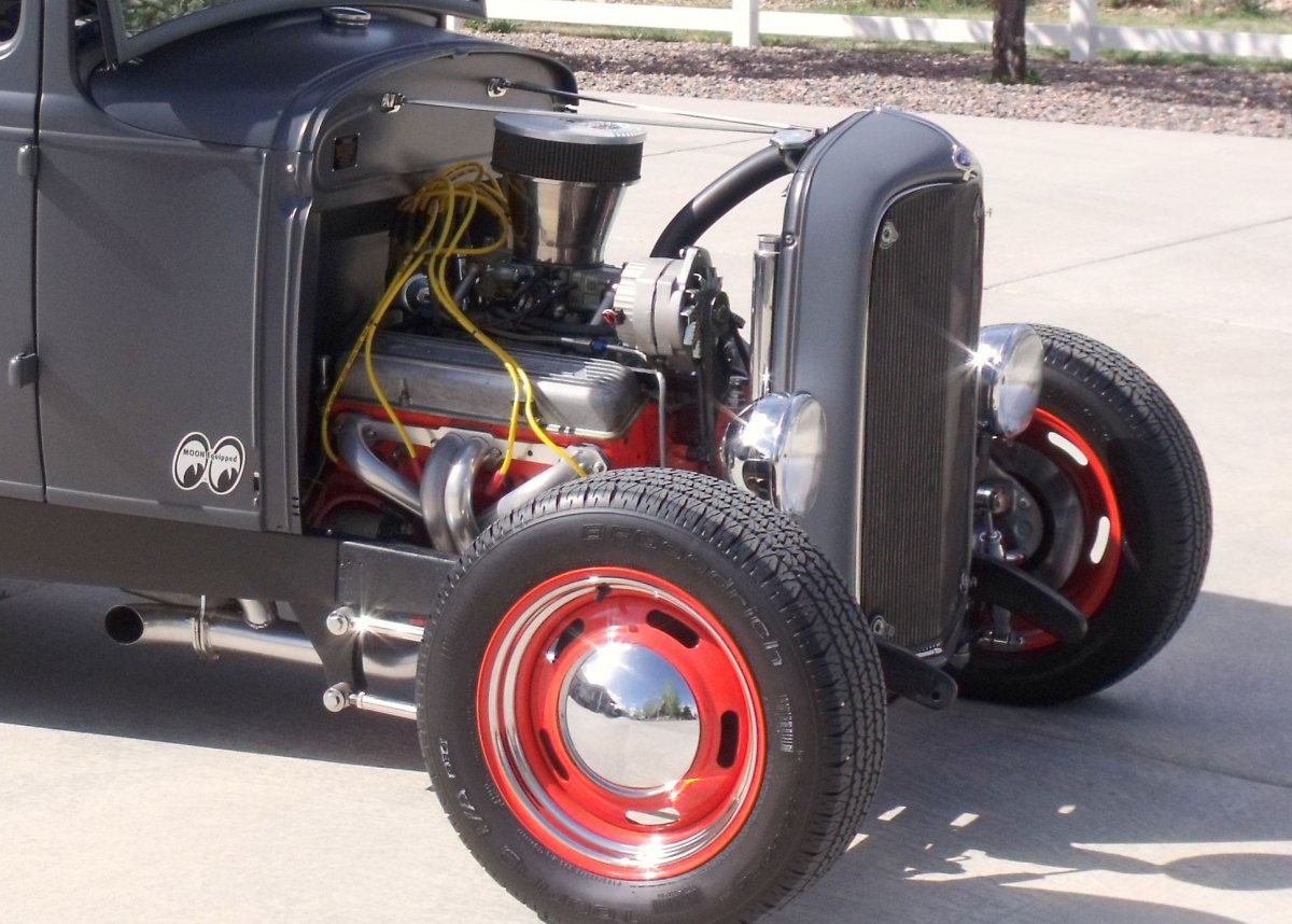

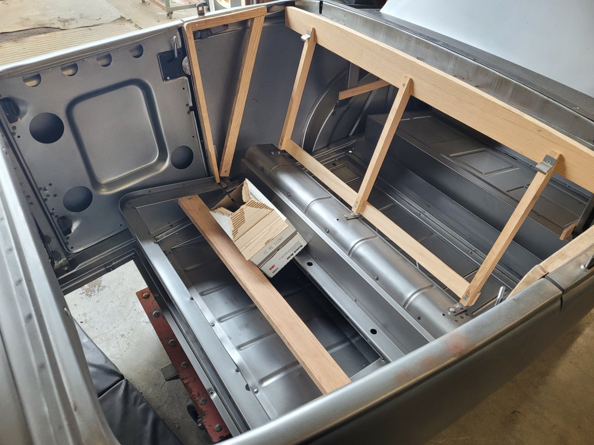

Curious why you didn't get the recessed firewall? Looks like you'll need to modify the one on the car, especially if you want to maintain the stock hood length.
I used a "Bitchin" firewall on my Henry Ford original steel Model A.
30-31 Model A30-31 Model A
Brookville body, I got a hell of a deal on it. Posies in Hummelstown Pa had a guy come in and say he wanted them to build one for him so they ordered it. Got ready for shipping and he ghosted them. I wanted a 28/29 at first. He said he had this 30/31 still in Ohio and the rest of the story so I jumped on it. 🤷🏿‍♂️
I making a hood from scratch also, using a 32 grill and if I can find one a Duvall windshield..... hardest part to find btw....
I'm sure I could do that but I like the fire wall the way it is rn
I'll have to trim it anyway to make a TKO600 fit

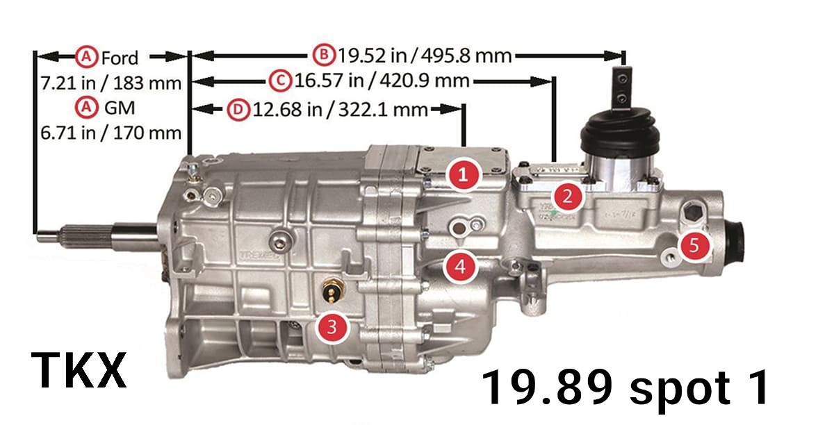

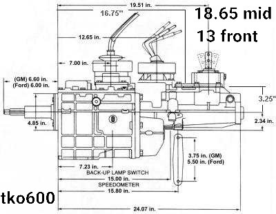

Also what trans are running?
I have a problem now I was gonna go TKO 600 with the front shift so the shifter comes up more near the dash, but Tremec discontinued it. And I dont think a T5 with a s10 tail housing will come up where I want it. Yet alone hold up to a to a 408 5.8 base stroker for long even with Astro gears....

I liked the look of the stock firewall too, but with a V-8... well... as soon as I sat the 350 SBC in the frame rails I could see a new firewall would be the best approach. It was an easy install. Drill out the stock spot welds, clean up the cowl belt, slide in the new one, and mig weld it in place.
Back in the day... guys welded a steel wheelbarrow tub in, to recess the firewall. Good stuff.
Our Model A has a '72 turbo 350. The body didn't have any floor in it when I bought it. So I waited until I had the frame and drivetrain fab'd up and then built the floor pan to clear everything.

66345
So If I went with the TKO 600 with the front shift thats where it would have come up.
66346
T5 with s10 tail would be about 5 inches back from that
66348
But the new TKX would be an inch further back with the mid shift on... no front shift..
66349
Ruff guesstimate anyway....

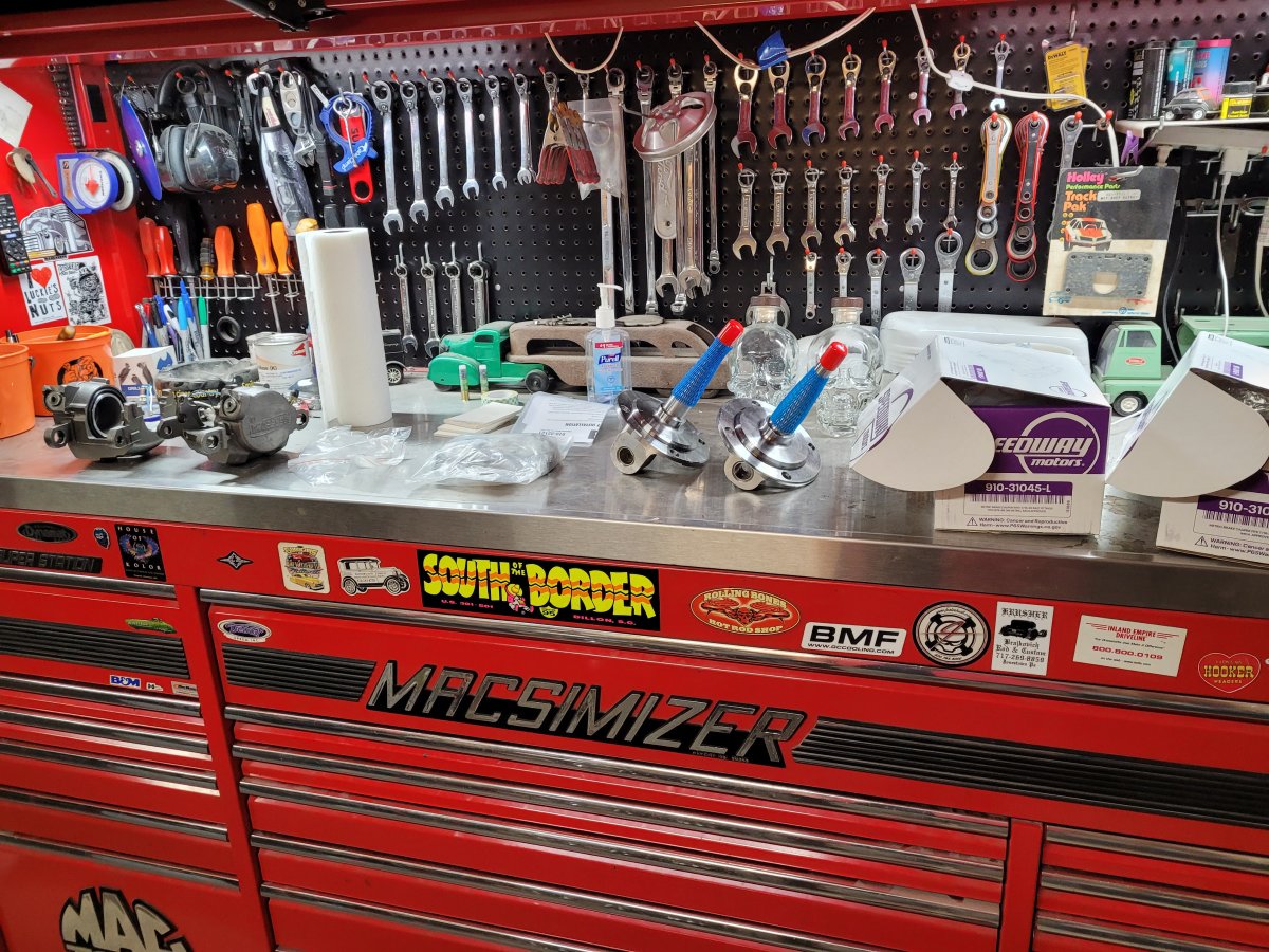

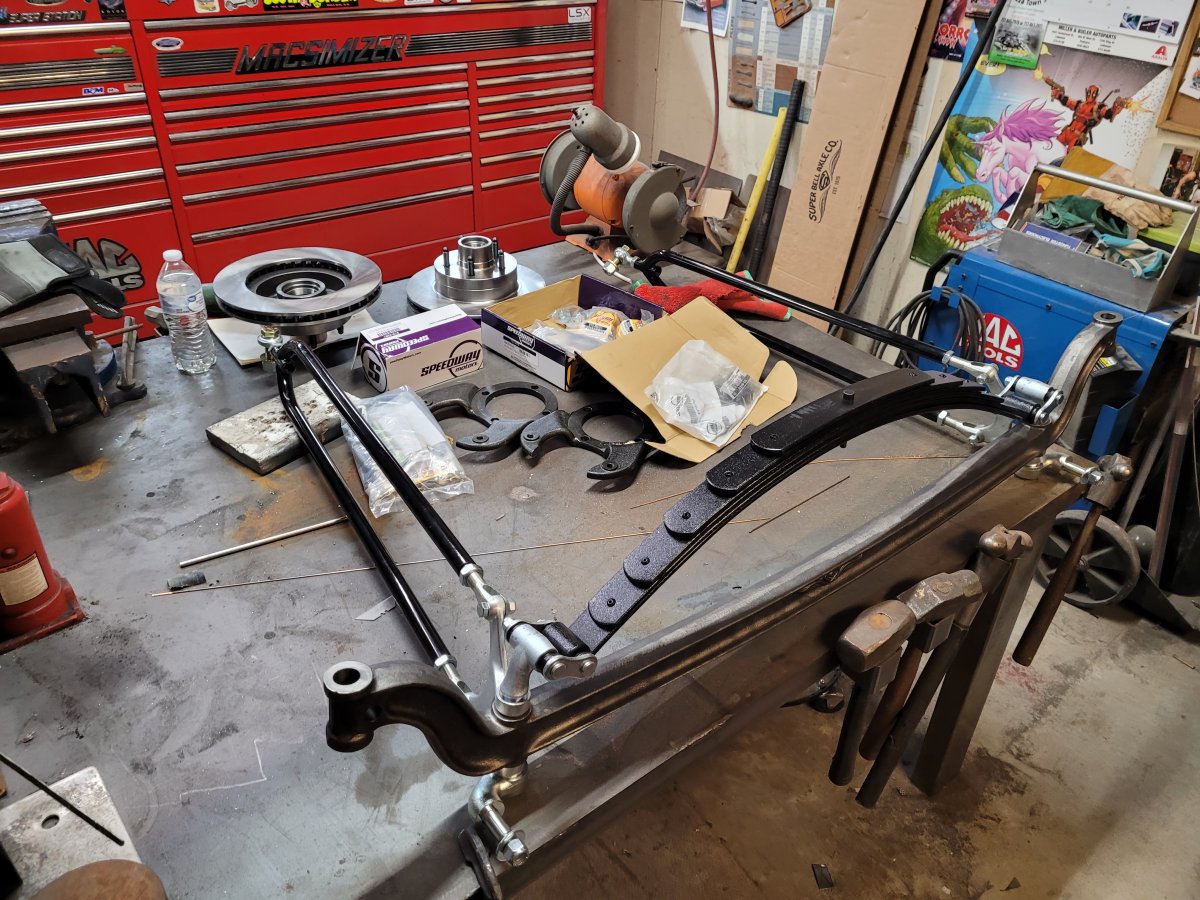

Some more parts came in and axle is going together.
Looking good.
  • What type of steering box are you planning to use? Vega?
  • And are you going to use a front panhard bar?
  • Have you thought about drilling the front I-beam?
30-31 Model A
Looking good.
Im staying solid I-beam, Mustang steering box, and I'm not sure about the front panhard yet.
Picked up a 20 feet peice of 1" OD .950 wall .0795ID Chromoly tube to make my 4 link and rear panhard bar. That cost $148 and some change.... well that stuff got expensive.... but I should have enough for make a front panhard also if I dont mess up....
