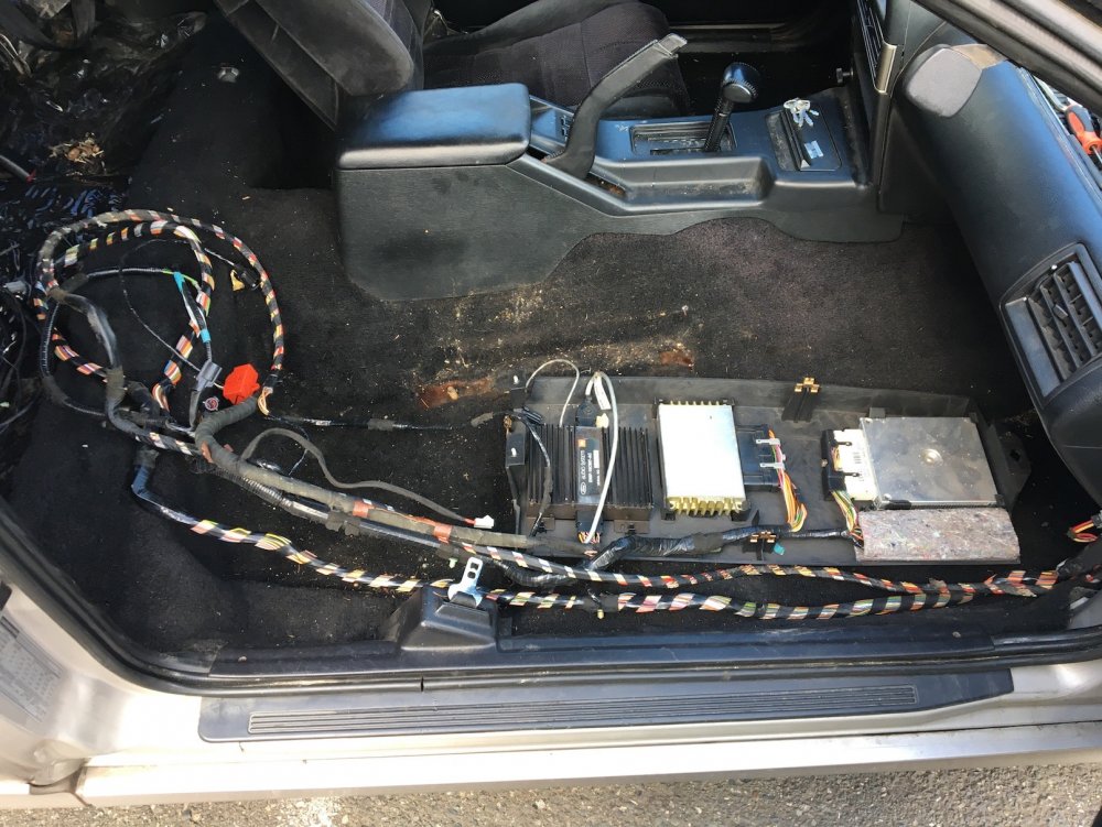

Probably the part of this conversion that will challenge me the most is the wiring and electronics. I have both the Chilton manual and an original Ford repair manual, so I knew that the computer lives in a tray under the package shelf. It seemed like the best point to start so I began disconnecting at the back end, fed the harness through the rear seat structure and eventually had the complete tray assembly in the passenger footwell.

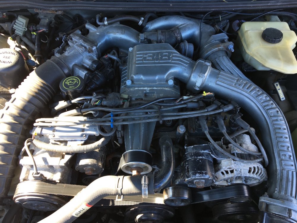

Next I removed the radio, AC controls, instrument cluster and a few more items that will either be used or sold. The car was still able to start and drive at this point, so I moved it to the corner of the yard where the boss is letting me take it apart. A quick goodbye burnout happened before I pulled the battery and ended its days!
Now all I have to do is remove all this lot:

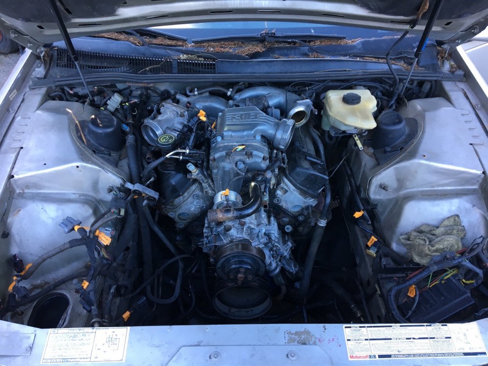

After lunch, I began unplugging, disconnecting, unbolting and removing everything from the front of the motor. Cooling system, intercooler, ignition, AC, PAS and alternator all came off and when it was time to pack up and go catch my bus, it looked like this:
25495
With all that stuff taken off, you can actually see the engine!
Unfortunately, a many of the harness connectors have been roughly treated in the past and have broken tabs or housings. Hopefully I can either replace them with new ones or find the same ones on the 3.0 harness currently in my truck. There are also a couple of fairly bad repairs from its past that will need to be put right before my OCD will allow the parts to go into my Ranger.
I took plenty of pictures, labelled all the connectors with tape and put as many bolts back into the threads they came out of. Next up for removal will be the supercharger and intake assembly.

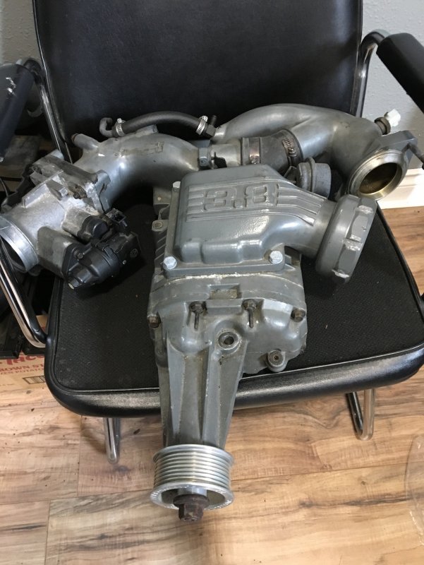

The countdown is on to get the Thunderbird stripped and off to the junkyard before next week, so I'll be going into work early this week to make sure I get all the parts I need. This morning I removed the windshield wiper assembly and cowl vent cover to allow better access to all the vacuum lines and small hoses up at the back of the engine bay. I carefully photographed the area and then disconnected and labelled the necessary connections for the supercharger. The throttle cable unclips from the bracket and although the 5 bolts holding the supercharger to the intake needed some careful undoing (A little dissimilar metal corrosion), the unit came away without any real problems. The boss arrived to see how I was doing and then we went inside for our Monday morning meeting. I had my prize for the day!
