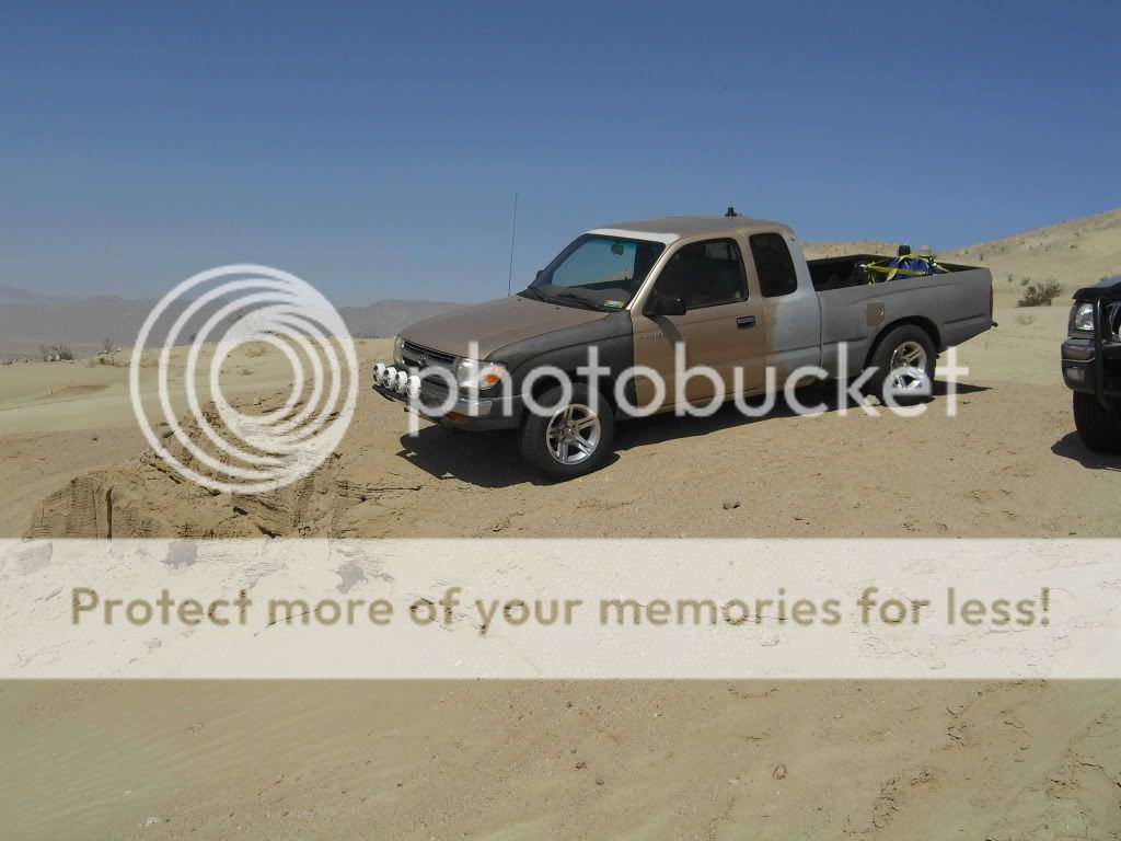

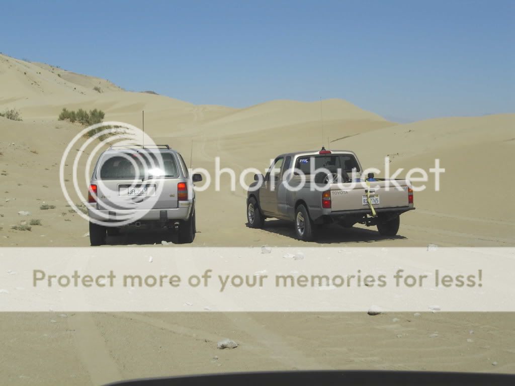

haha not at all, I just know its limitations, flexy is sexy and the TTB has issues in that department.
Enough flex for yah? ;)
Its enough stuff and droop for anyone but unless youre jumping the truck you will rarely (Ive seen one major droop pic, guy was cresting a berm) get a similar picture to the ones you have above... The TTBs design makes them a big independent axle which has its benefits but a solid axle has the upper hand when rock crawling. Run the TTB till it blows, it will take an amazing amount of abuse.

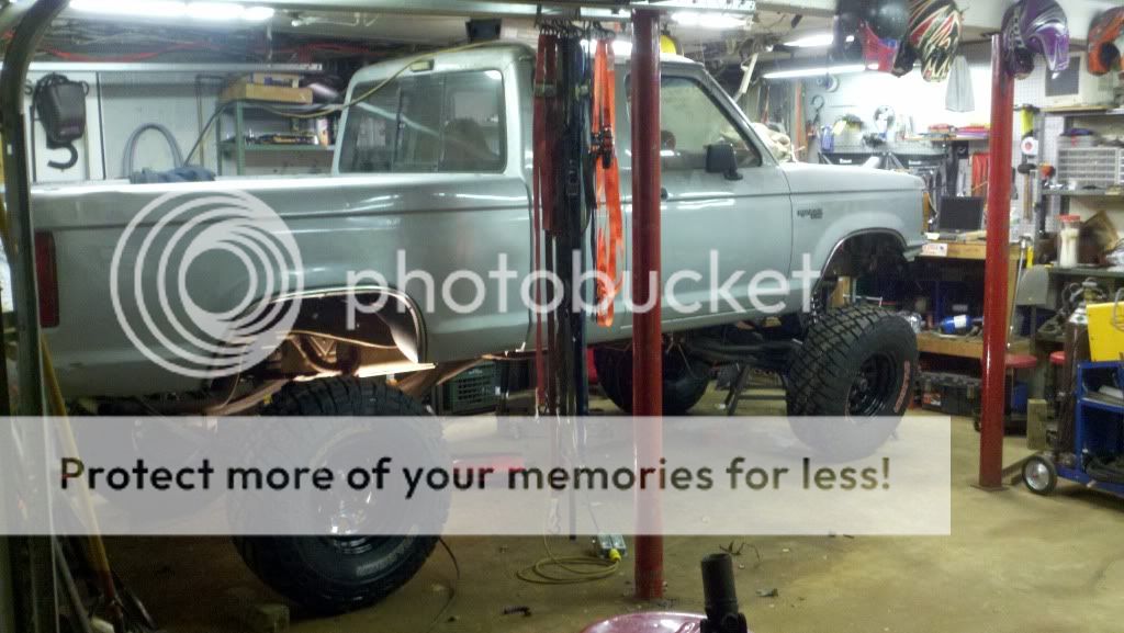

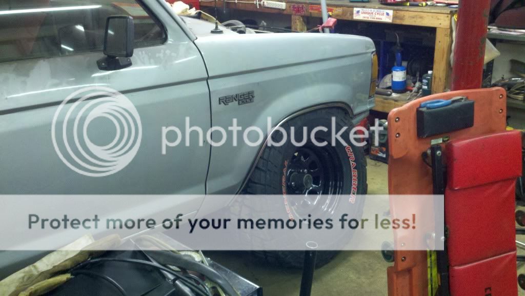

Yeah that shouldnt break! Lets see the pics of her flying!
The highest it has gotten so far is on jack stands for now! Im working really hard to have it done by memorial day weekend....
