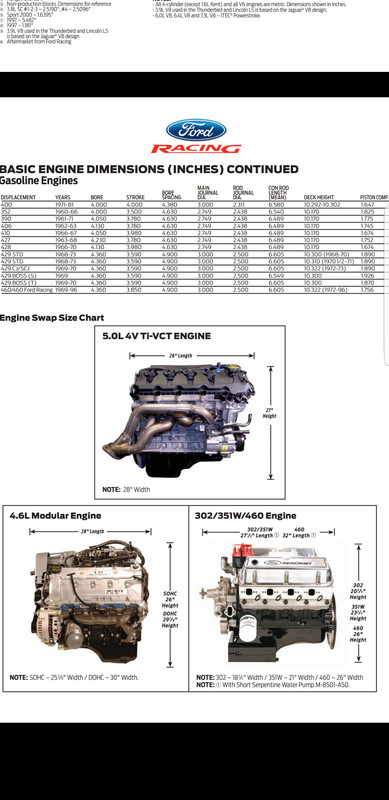

3.0 to 4.0 or to 5.0?
^^^ Have a link to that chart? The text is too small to read.
Its a PDF, google "4.6 vs 460", first result

I'm not wanting a stupid fast street racer, just a stronger motor than before. 4.6's are way more available than the 5.o explorers. that's all.i can get a 5.0 out of a t-bird. can get the whole car running for about 500 bucks. expos go for twice or triple that around here.
Just be prepared if you get a 5.0 out of anything else other than a expo plan on shortening up the front engine accessories. The expo 5.0 has custom brackets from the factory to make it shorter. The 4.6 is a great option but I have not seen one without deleting the a/c. I did see one with the heater still working.
Stock for stock a 4.6 is the same physical size as a 460, requires more wireing, and makes less HP and waaaay less torque, and pry weighs close to the same.
A 4.6L weighs nothing close to a 460 big block, in fact a 4.6L weight less than a 302.
It has a similar size on the outer dimensions, but the block uses a lot less material, and the heads are aluminum, that cuts a lot of weight. If the 4.6 had been done on a smaller V it could have been the same size, or a little smaller, than a 302.
But it wasnt. So you still have to do the same amount of chopping to get a 460 in, just run 3/4 ton front springs.
Not to mention even your weezing 70s 460s were making 365ftlbs, to my knowledge no garden variety 4.6 even comes close. Not to mention you can build a fire breather alot cheaper and eaiser with a 460.

The 460 is longer though, in a tight RBV engine bay length gets tight faster than width. Coupled with the weight I would pass on a BBF.
Still shorter then a 300 I6.
Either way, for the OP, just go 302
Yeah but if you don't move your firewall back 300-6 leaves you 2 inches to put fans, radiators, and any other coolers you may need in the engine bay.
