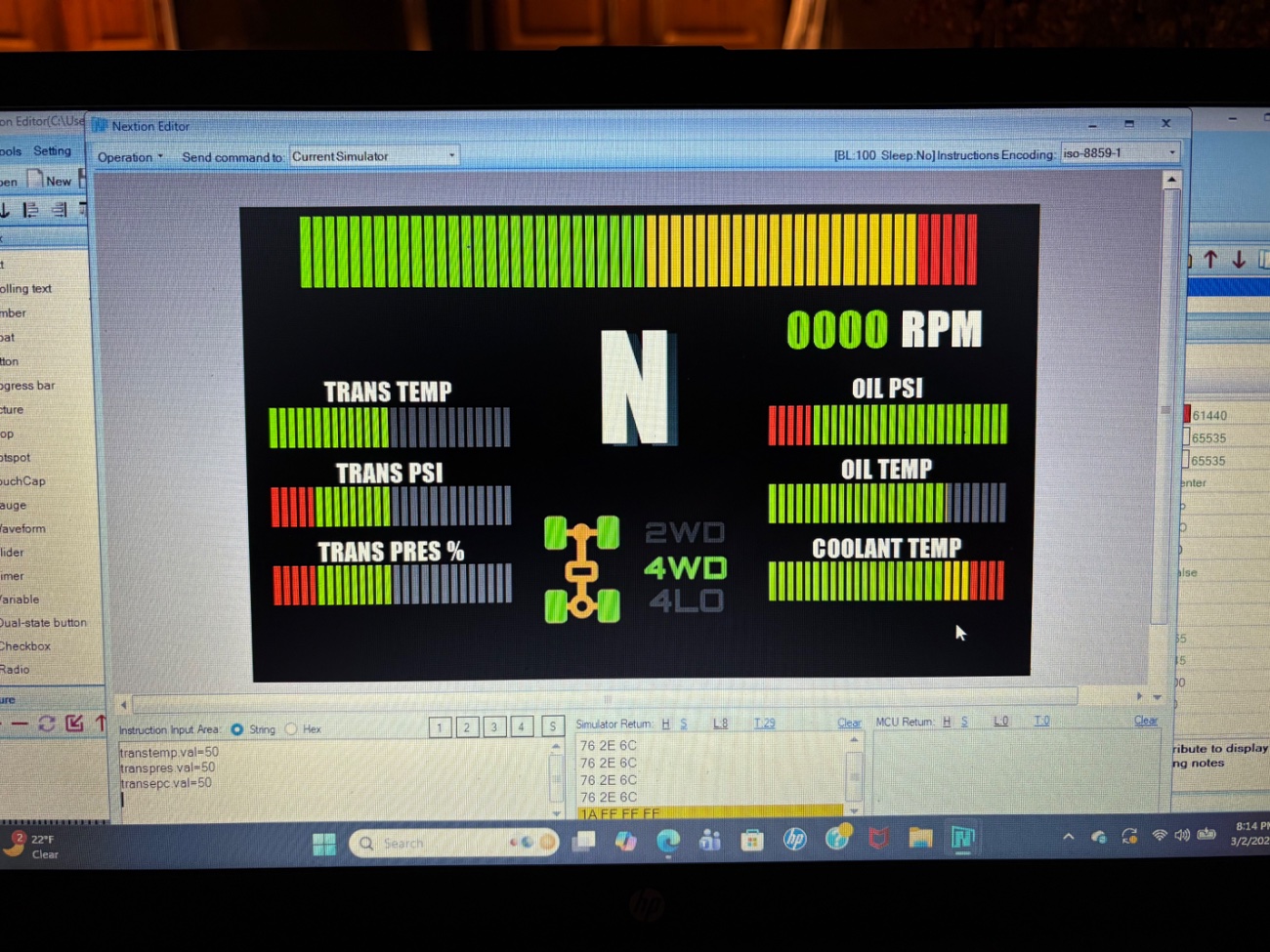

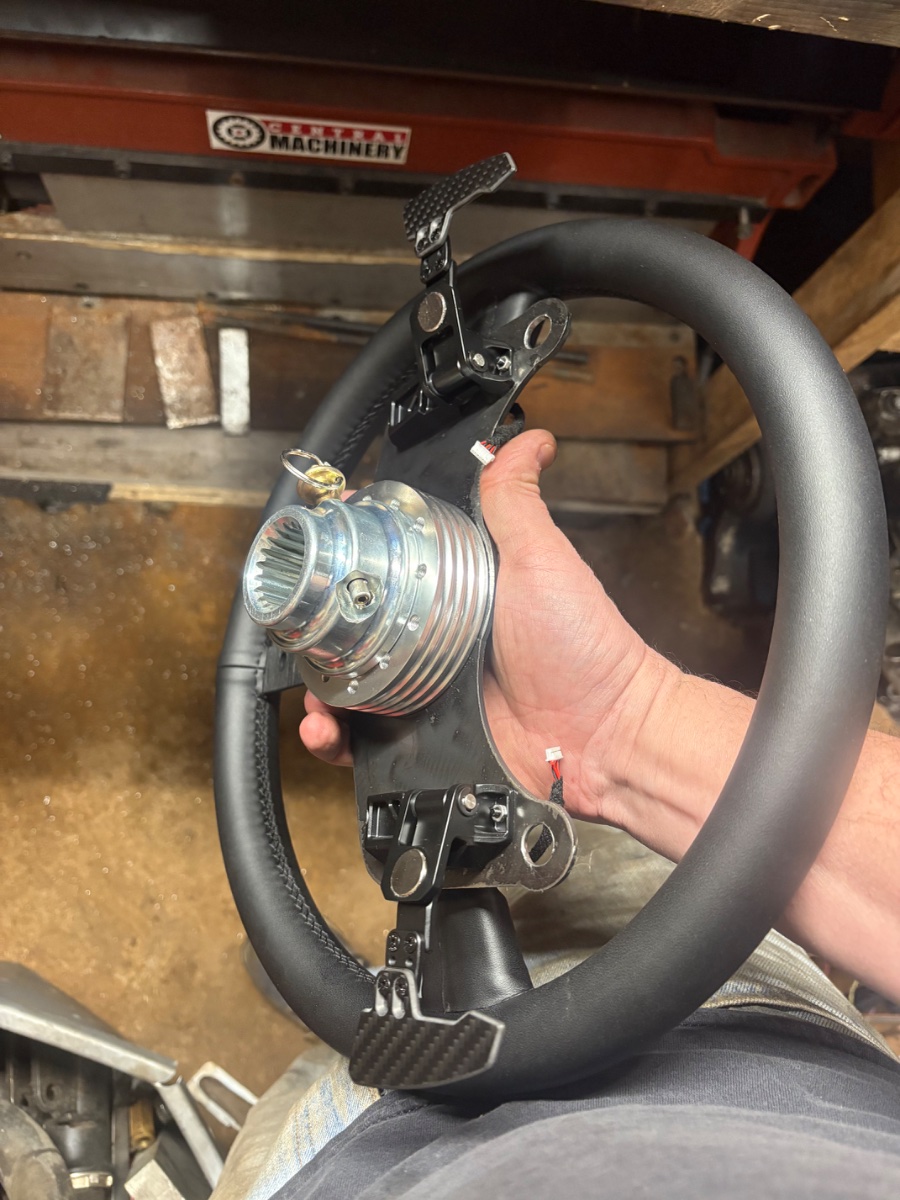

Tested the trans controller with the lcd keypad and it shifted flawlessly up on jackstands! Now, I’m putting together a much more integrated system that is gonna look and function high end, but will get it done for shockingly little money! Proper magnetic paddle shifters. Digital display for engine vitals, gear selection, RPM, shift light, even electronic transfer case control.
Here’s a pic of what I have done so far for the user interface on the display
  • 3.0 sho in 4x4 99 ranger
Love getting to see progress on this truck every now and then, great inspiration for me to get back out there and work on my own rack.
Keep it up brother!
noice!!

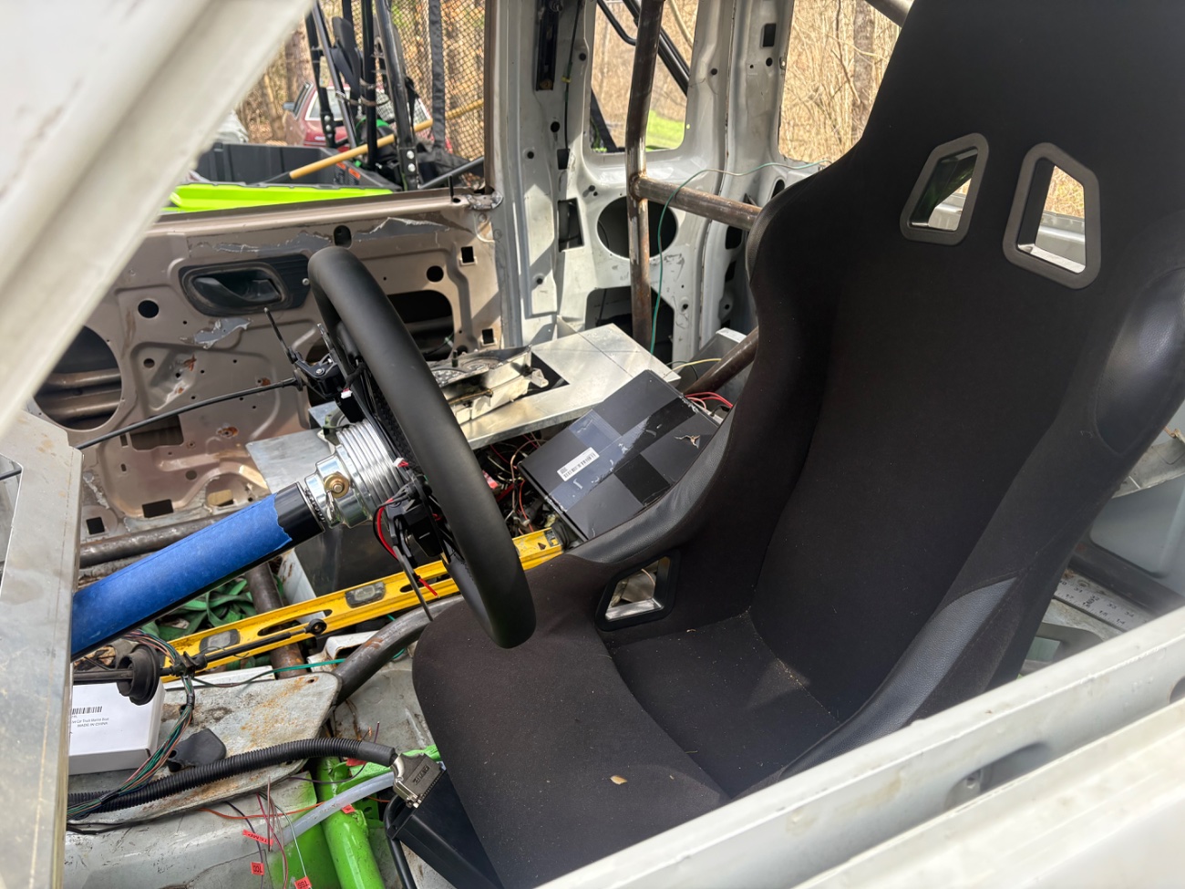

Some dash revisions
If they only made these in neon green!!

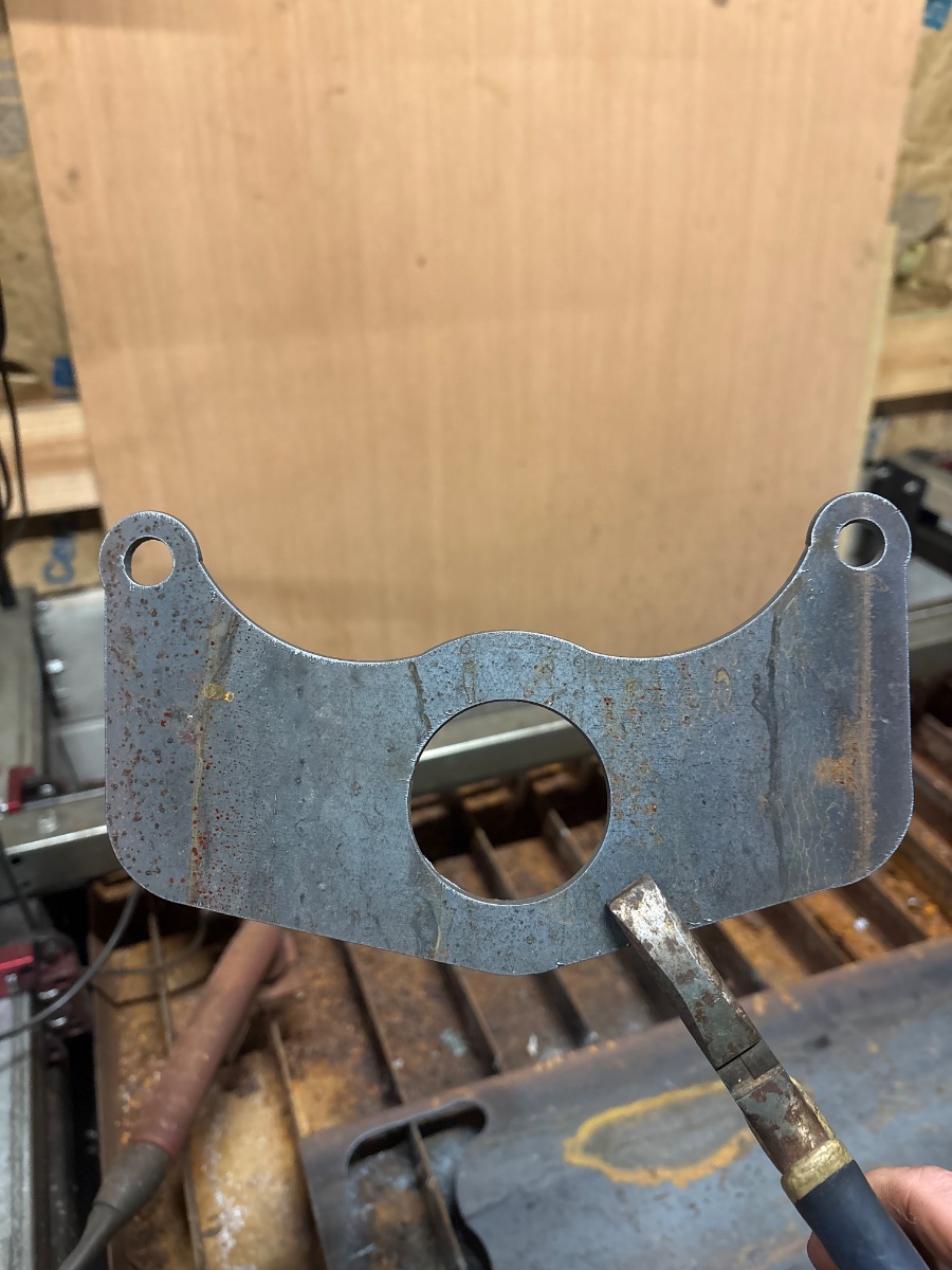

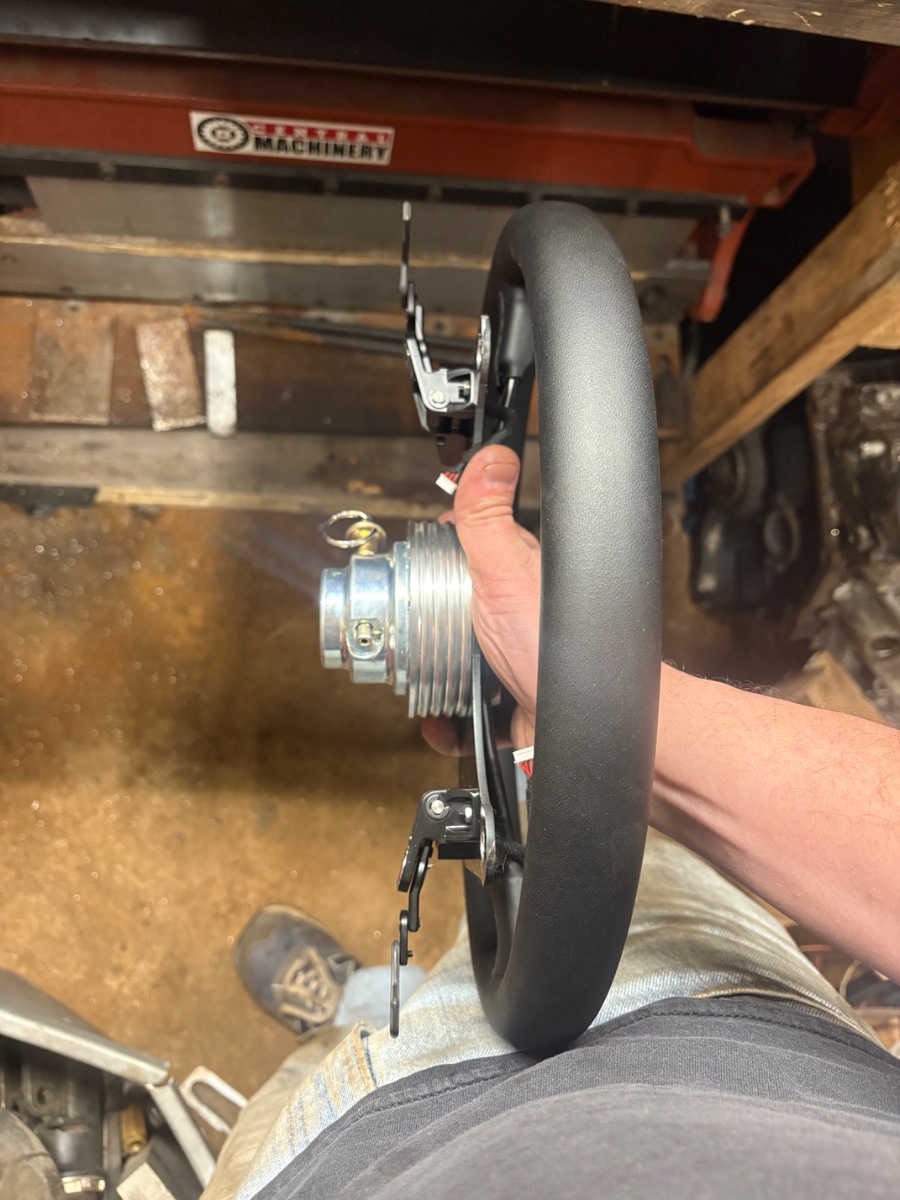

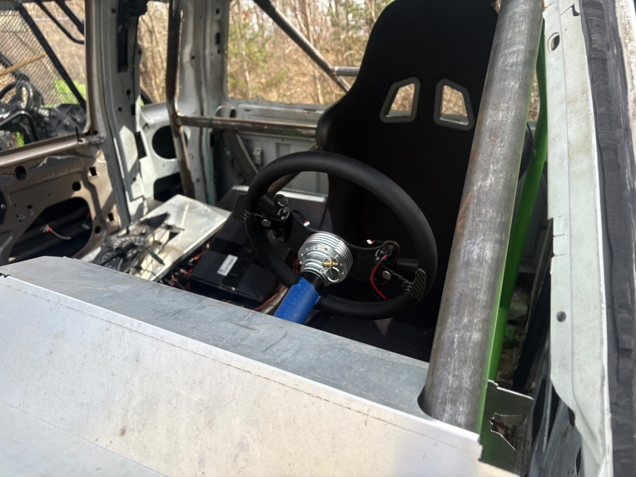

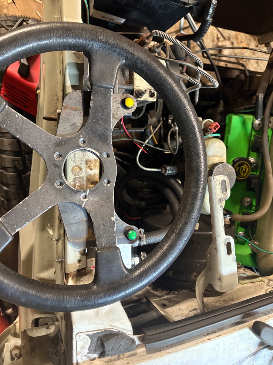

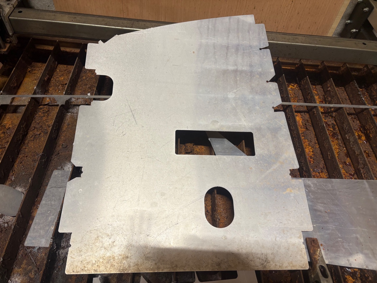

Paddle shifter plate. The buttons you see are NOT the shifters. I added them to be thumb buttons for menu selection on the screen
This is insanely wild in a really good way.
wait, quick detach steering wheel on something that isn't a stock Honda Civic? That's allowed? :)

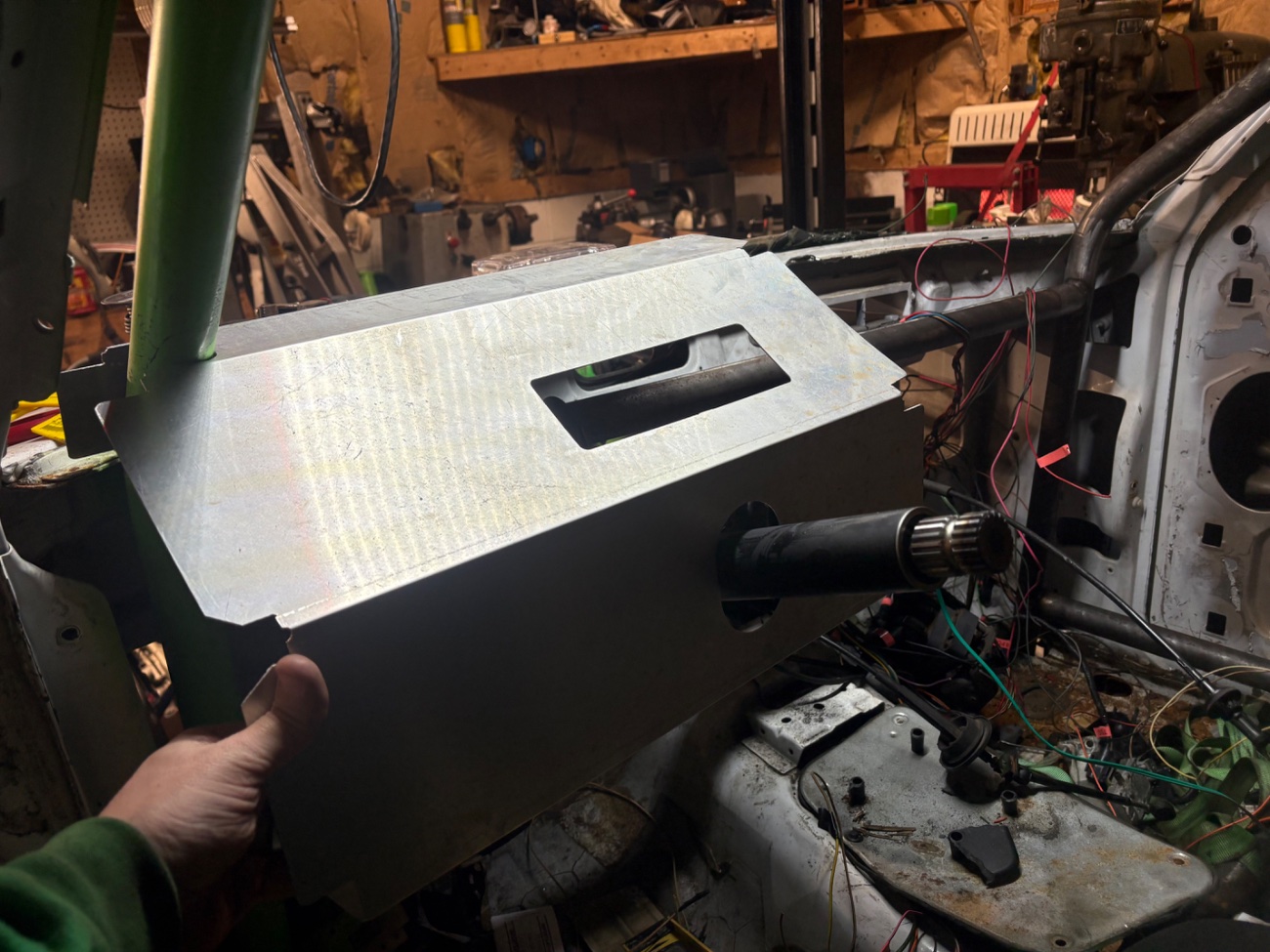

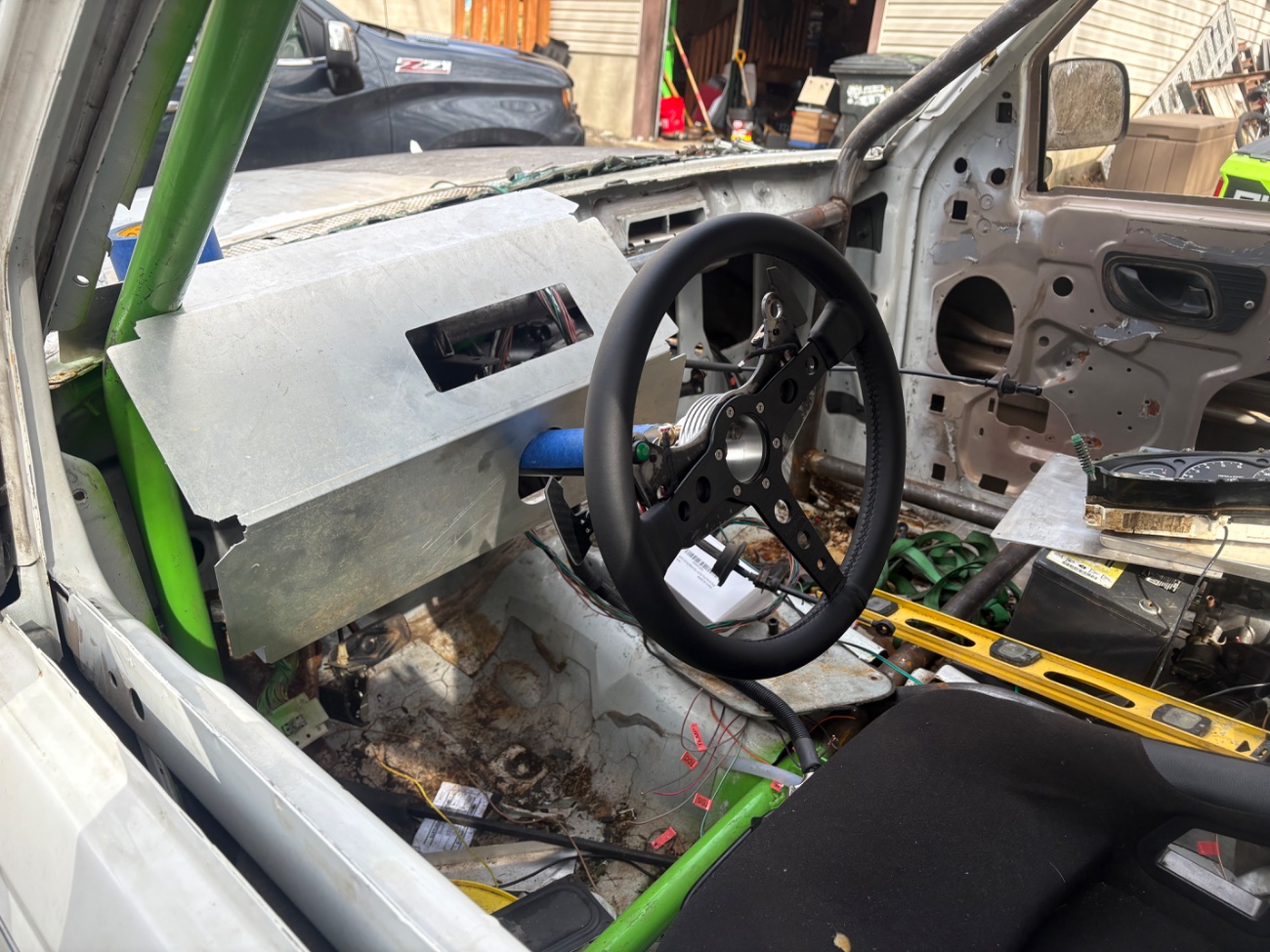

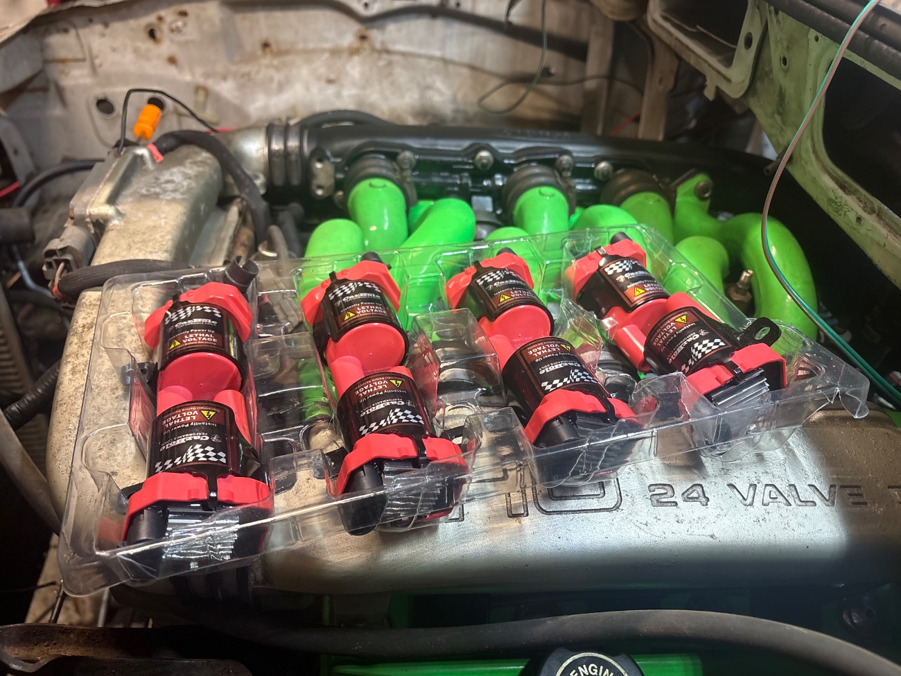

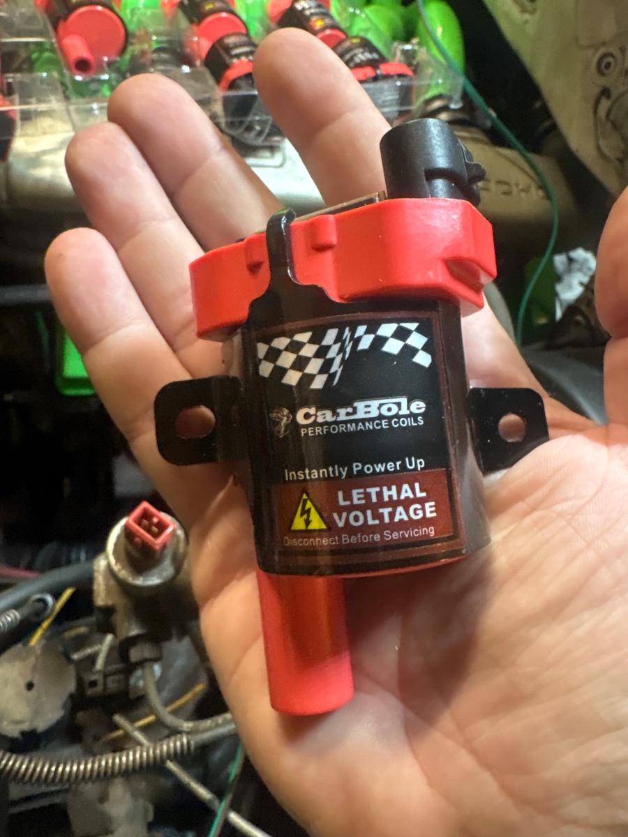

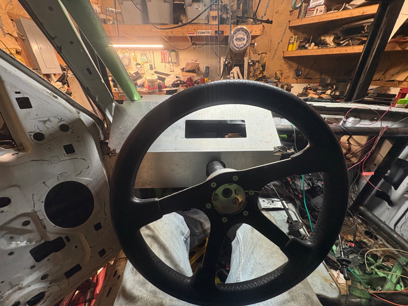

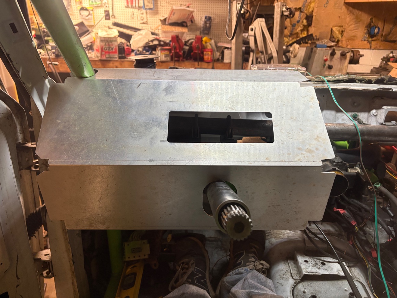

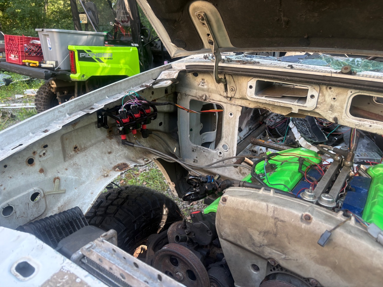

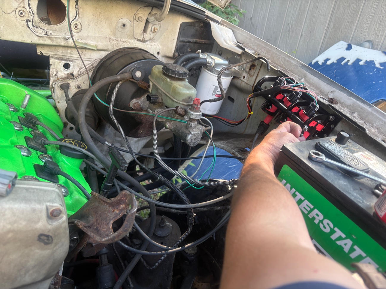

Been a while, huh? Back injury and marital separation will do that! But back on it just a bit the last few days. Finishing up the megasquirt install (might be some power gains there from ditching the maf all together, plus optimizing fuel and spark tables for performance. No concern for emissions, fuel economy, etc ) and all the rest of the wiring. I wish i had some really sexy interior pics to show, but i have the dash back out while i fabricate the aluminum doghouse. But heres a couple silly pics. The LS coil install and the headlights keeping my green theme alive!
