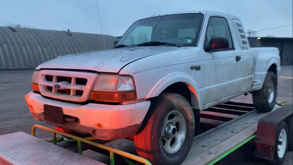

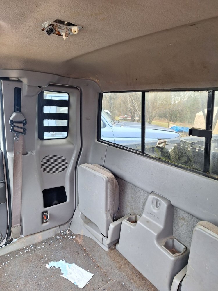

So I committed to buying the 3.2. I had previously decided I didn’t want it as I already have the 3.0 from my buddy, but I figured it was cheap enough to warrant it for whatever parts are interchangeable, not to mention wiring etc in case I don’t go with the megasquirt (though I am leaning that way). Having said that you could guess I have decided to go with the sho swap instead of the 2.3T as previously discussed. The deciding factor was the race I just attended two weekends ago. The class the 2.3T would put me in has very few competitors and they are all LS powered vehicles (4.8 through 6.0). The 3.0 sho will put me in the second to bottom class, competing with stock 4.0 Cherokees and lightly worked V6’s. Plus that class tends to have 10-12 competitors per race so more seat time and potential points if this setup proves competitive.

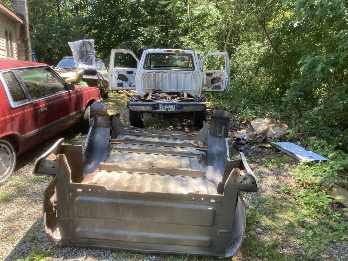

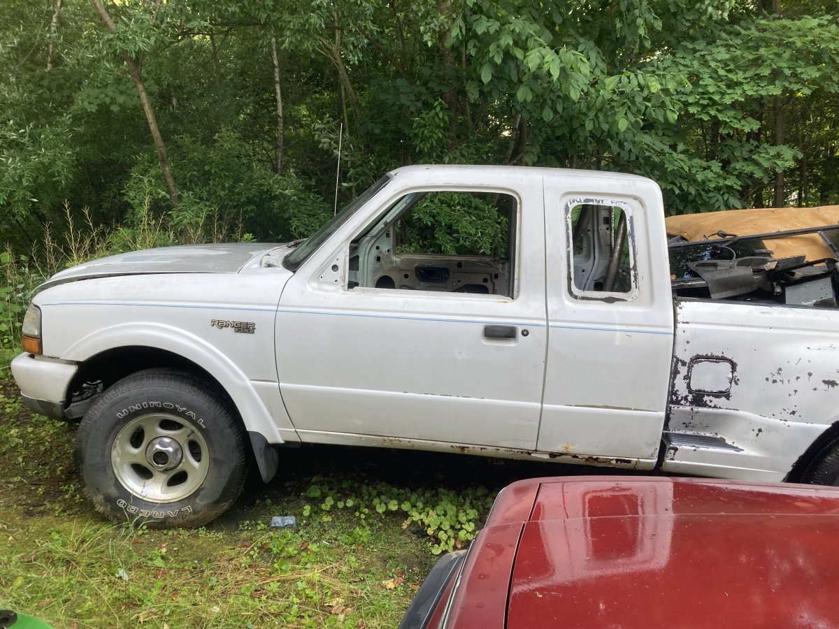

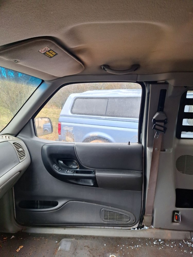

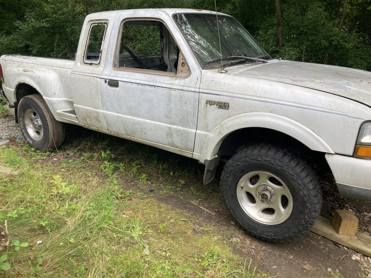

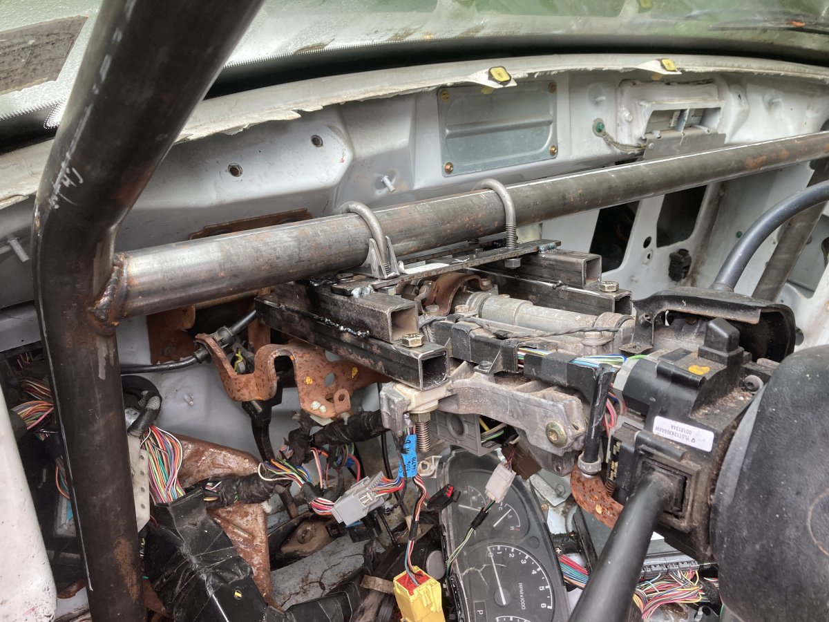

I’ll be putting up a video on my YouTube channel soon going over some basics of the Ranger build. For now I’ve been stripping the truck, pulling the glass, removing the bed (which will go back on) and building and installing the cage (I built a tube bender for just this purpose). I’ll likely get the Ranger race ready with the stock 3.0 Vulcan in it and run it at a race or two to ensure it’s performing as it should (though it’ll be woefully underpowered and not competitive) before starting on the sho swap.
To my knowledge no one has completed an sho swap in a 4x4 Ranger (except for old pics of some trophy truck I found on the internet with no details etc). As I’ve mentioned previously in this thread, I’m fortunate that since it’s a race truck I’m not as confined with certain elements of the swap as a daily driver. For example I have no intention of flipping the intake and will instead be cutting a hole in the firewall for the portion of the intake occupying that space. This works for me anyway as a lot of racers end up putting a 180 degree elbow on the throttle body anyway to keep the filter away from the mud and water. In my case it’s already where I want it. I also don’t have to deal with the encumbrances of heat or AC or stock battery location, etc. I’m looking into possibly picking up a M5OD to swap, though I’m also seriously considering keeping the 4r44e and have read the schematics to put together a “manual” controller for the trans. Will it need a different stall converter? Yes. Will the increased RPM destroy the transmission? I don’t know, maybe. I kind of don’t care. If I got one season of racing out of that trans I’ll be happy.

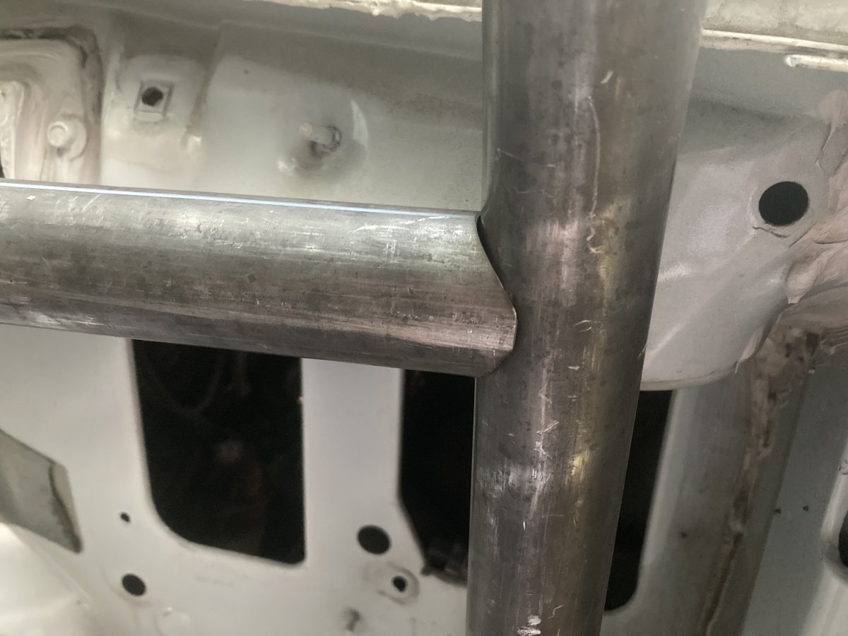

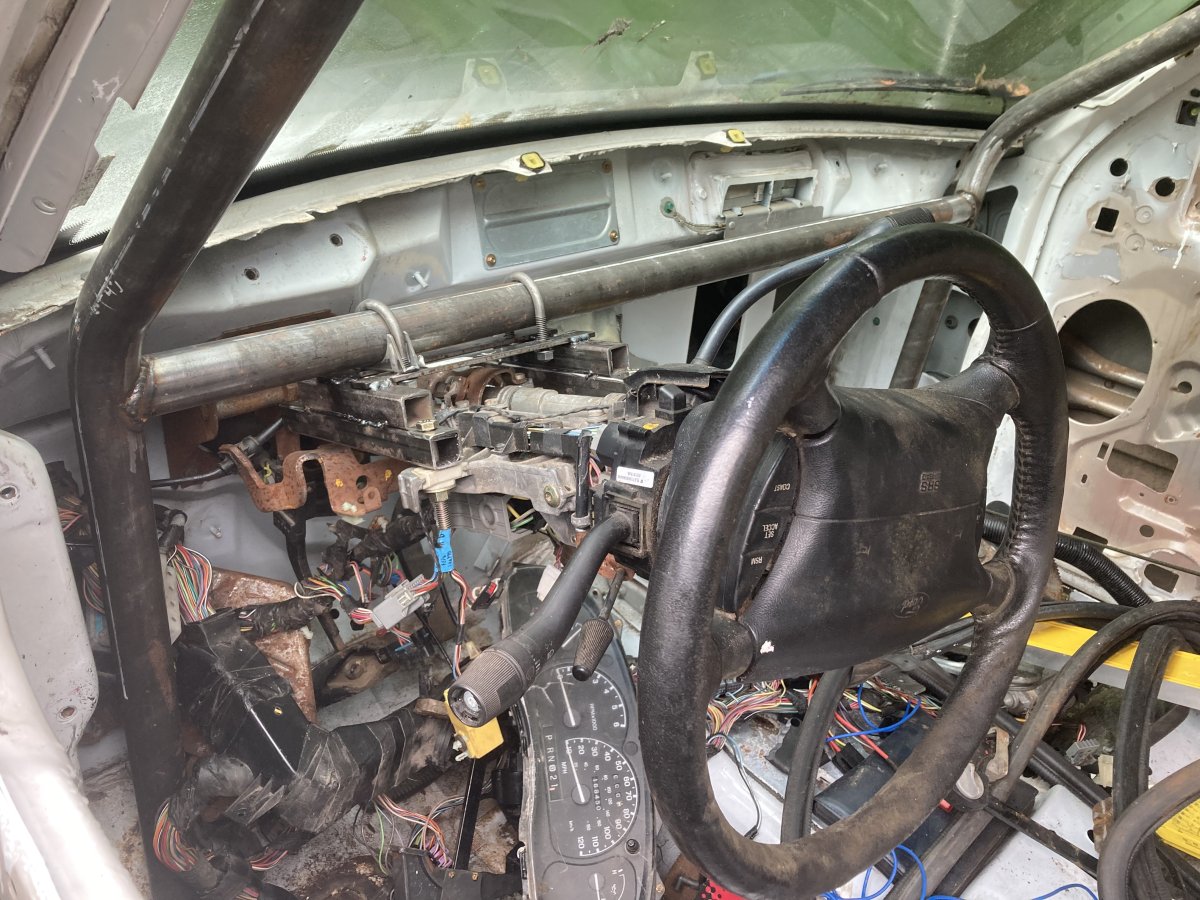

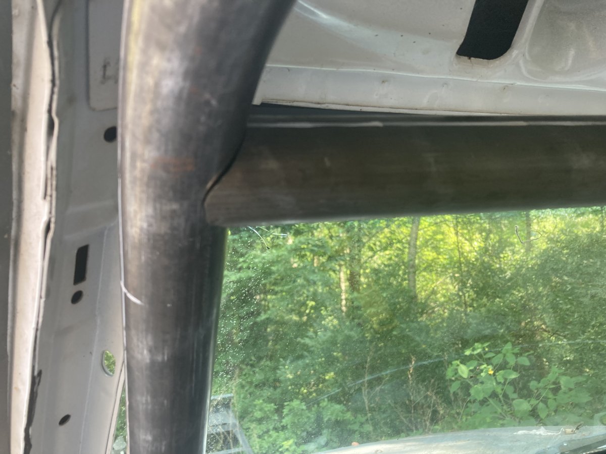

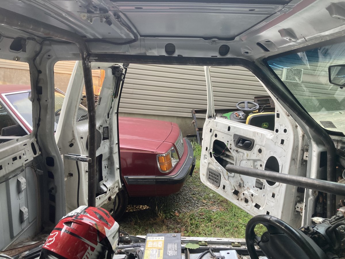

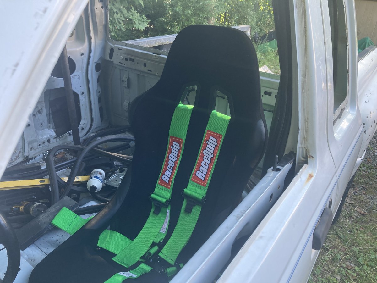

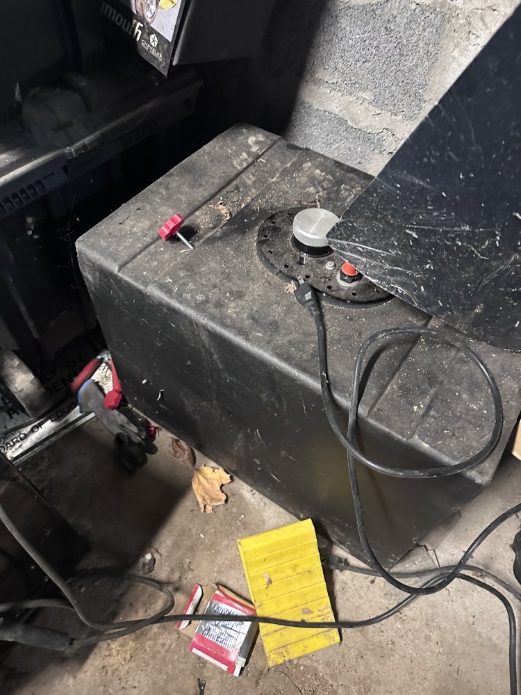

Coming along on the roll cage. I’ve been averaging only about 5 hours a week in the garage so progress is slow! But cage is nearing completion (inside cab, not counting bed bars and firewall to front frame rail bars). Got steering column to cage mount made and got the mud terrain tires mounted. Went with stock size 245’s. Next step is getting the seat mount in which will be custom to allow height adjustment fore and aft as I don’t know exactly where I need it to land for good position yet ample clearance helmet to cage. A good buddy of mine hooked me up with a never used fuel cell for free too!

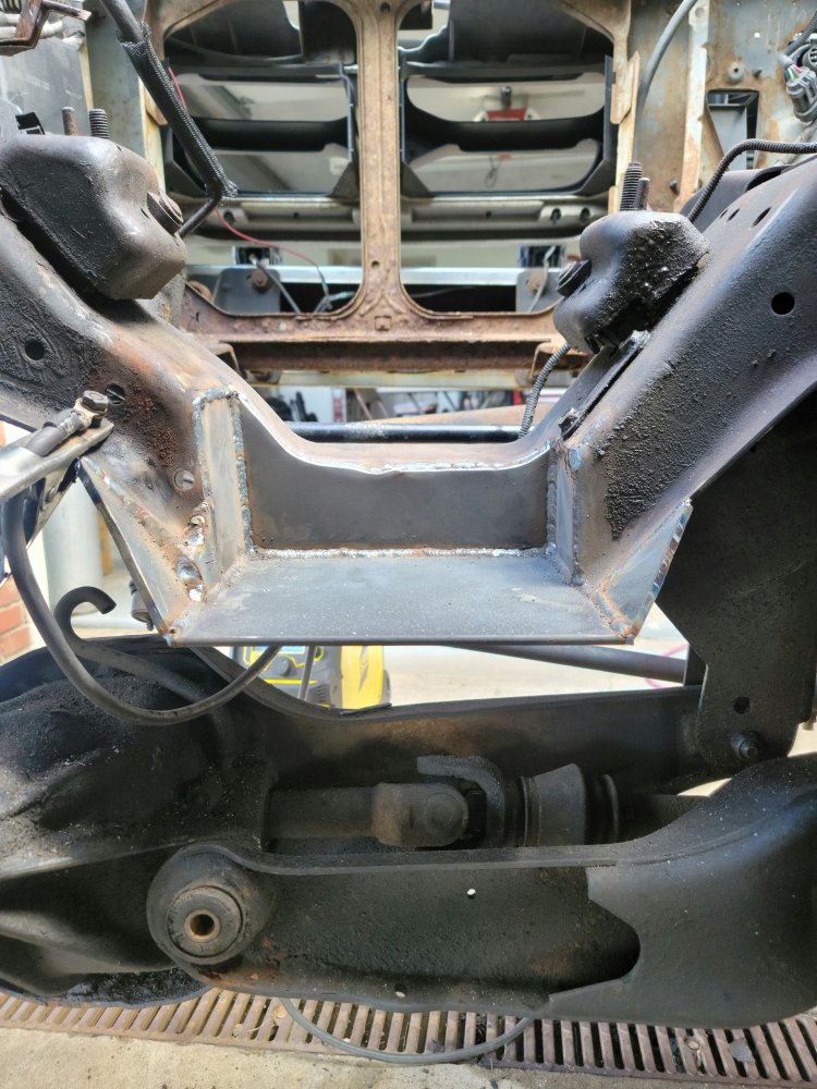

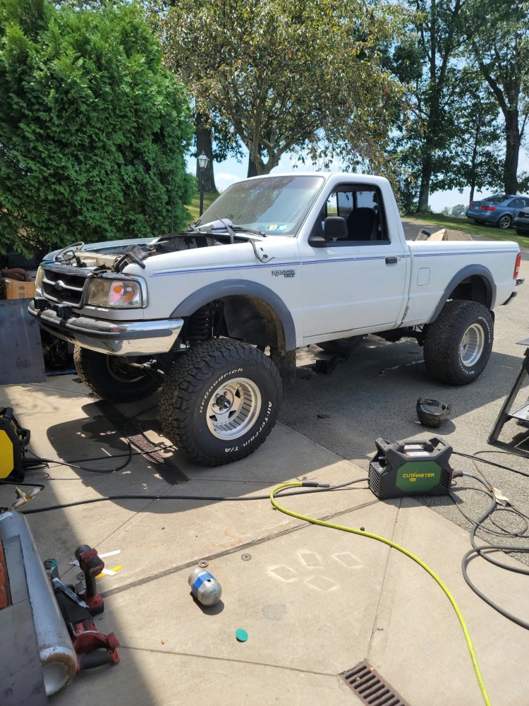

It's definitely a a doable swap, and it may actually be easier on an IFS truck. I chose to cut my front crossmember to clear the oil pan instead of building a custom pan. You will absolutely have to cut the firewall, the driverside head wants to live where your gas pedal is. Flip the intake around and make some phenolic spacers, and I opted to delete the crossover on the intake to clear the firewall. Overall it's not a bad swap if you have some fabrication/welding skills.

Nice job Lowranger! I wasn’t sure if anyone had finished it in a 4x4! What did you do about driver side exhaust and steering? I’m considering just moving the steering shaft since it’s a race truck and possibly using the stock manifold if possible.
