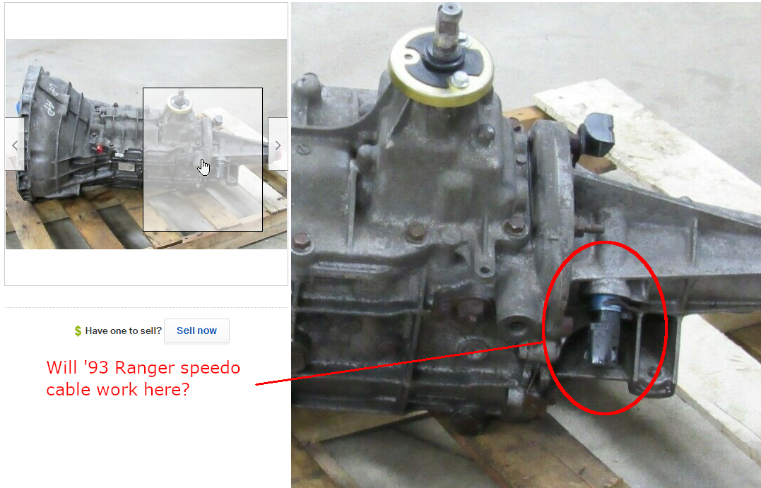

      • I thought these transmissions do not have speedo gears. Looking at pictures on eBay (linky linky), I am wondering if some years did, in fact, have a place for a speedo gear. Would my cable work in this case?

Does anyone know if '93 Ranger speedo cable will work in the 99-04 M5R2?
