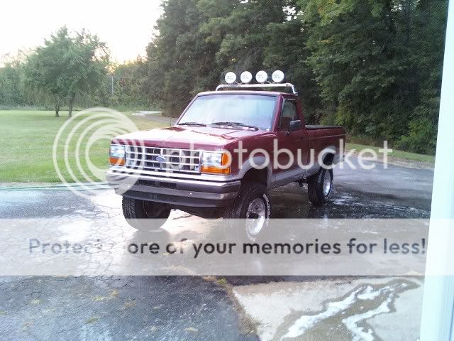

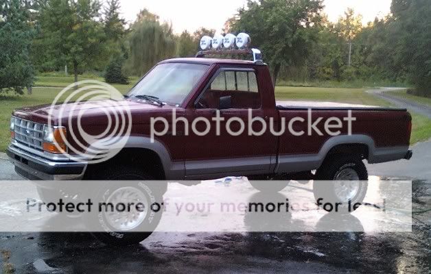

I bought a Rough Country 4" lift. I was very easy to install while making the swap. All the bolt holes lined right up. At the advice of the buy I bought it from I put 2" welds along the seams where the lift and the original parts come together. We put 31,s on the truck and we all love the way it sets. Not crazy high but you deffinately know it is lifted. I will try to take a pic of it tonight and post it up.

Here ya go. Sorry for the crappy cell phone pics.
I like it!!

It IS a 4wd now. :headbang:
We swapped all the drivetrain and crossmembers out of an 88 into this!

I like it!!
Looks good, just enough lift.
