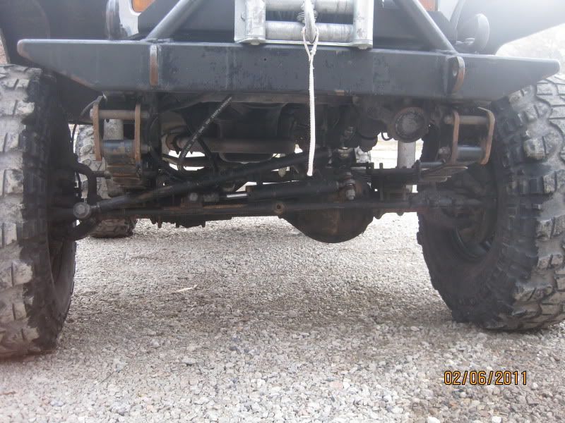

the leaf axle is 31 in.....ranger frames are not really very square....i dont have all of the frame dimensions in front of me, generally you simply make offset pads on the back side of the axle and a spreader out front so you have your 31 in center. i have also seen coil axles converted to leaf and spring over which involved a truss that put the driver pad right on the piglet and was centered under the rails conventionally which is pretty slick all around but makes the steering a little more work.....
this is typical spring over, the shortcoming should be obvious.
here is a 650 dollar can of turd polish which takes the pain out of the steering situation.:icon_rofl: http://www.ebay.com/itm/New-TeraFle...Wrangler-YJ-TJ-XJ-LJ-MJ-1813000-/310605900698
there is a seemingly endless amount of turd polish for the dana 30....
