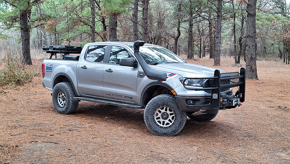

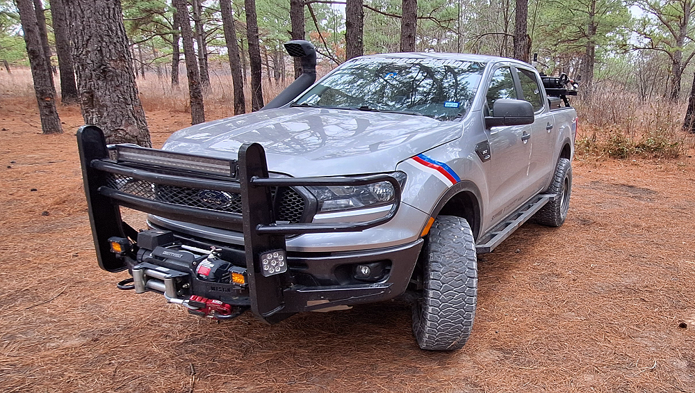

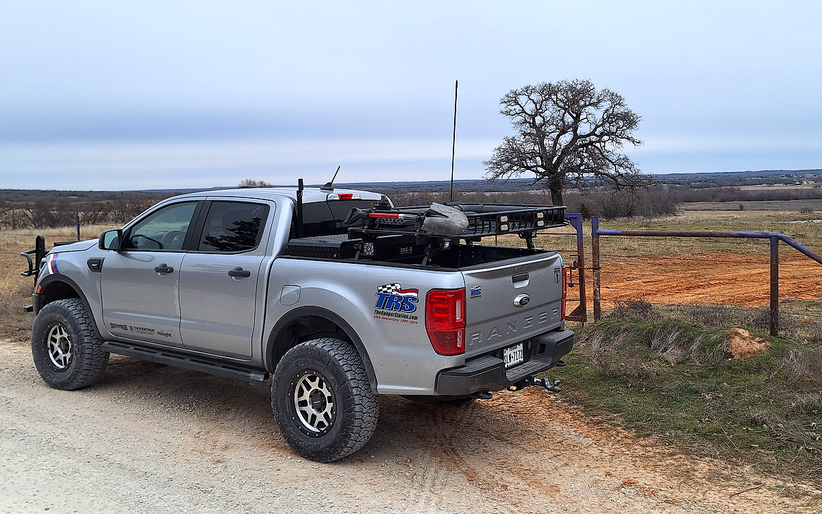

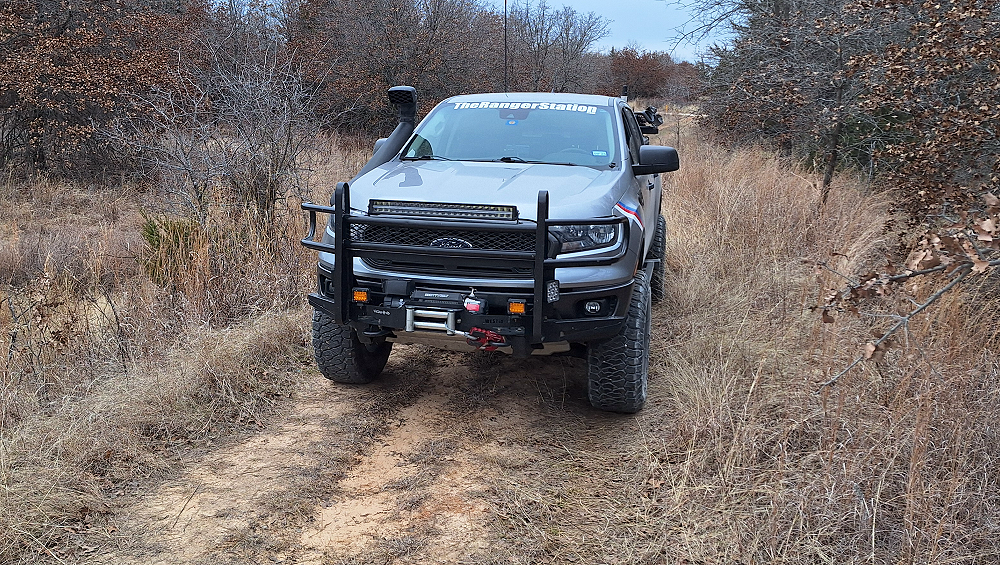

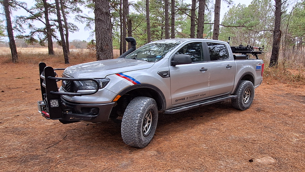

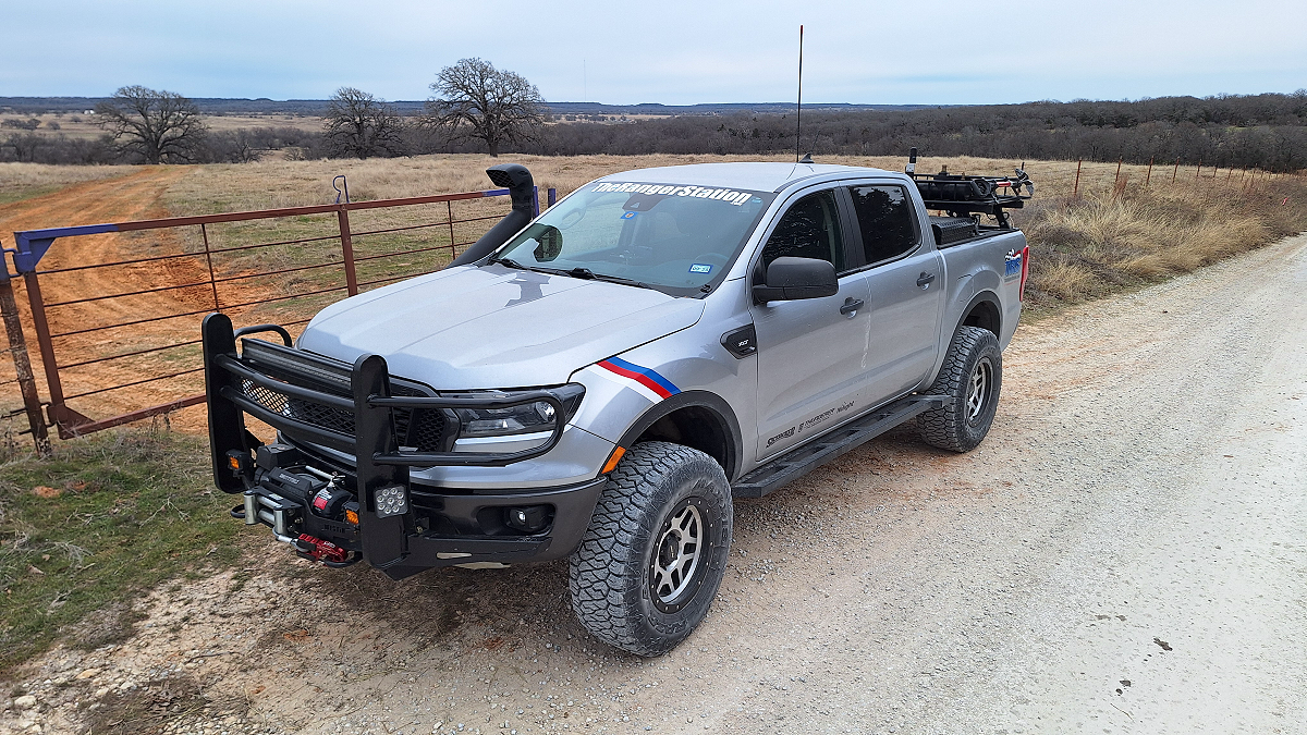

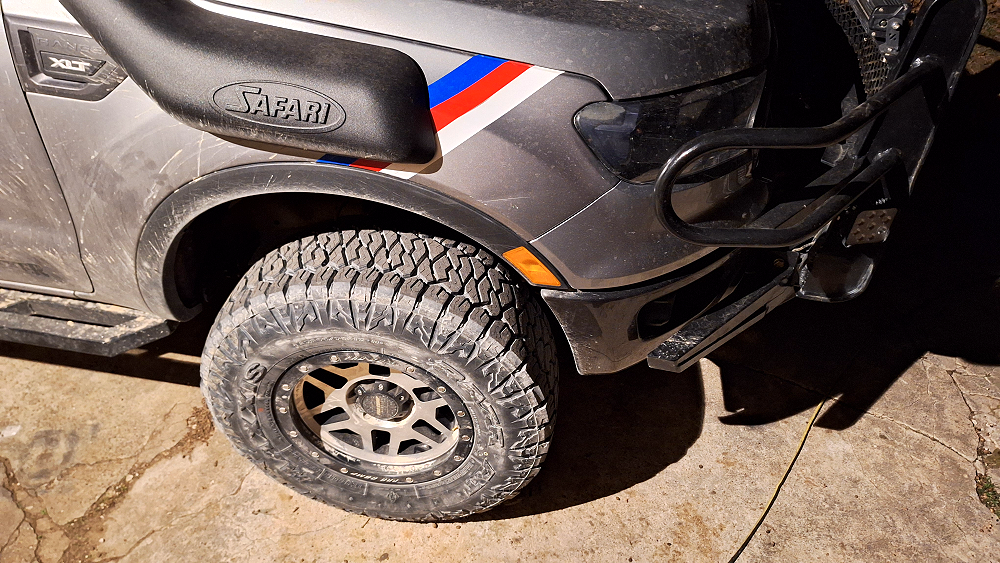

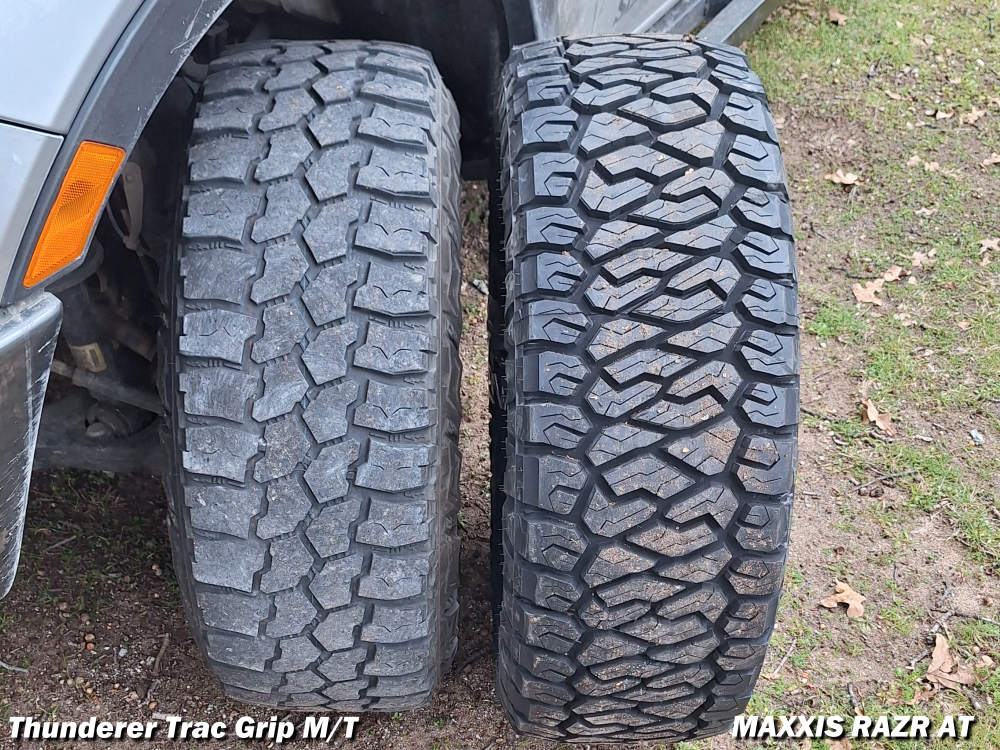

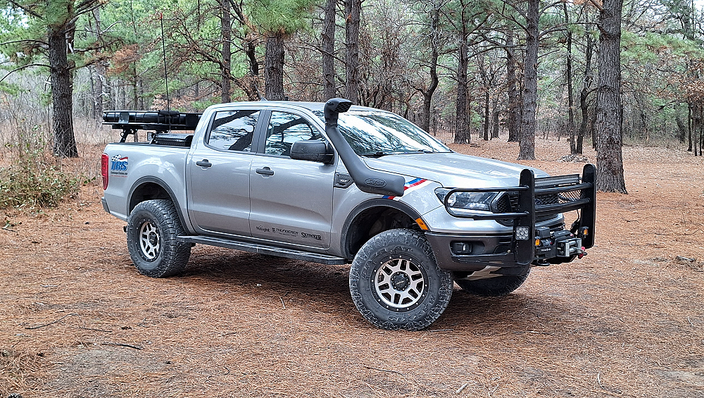

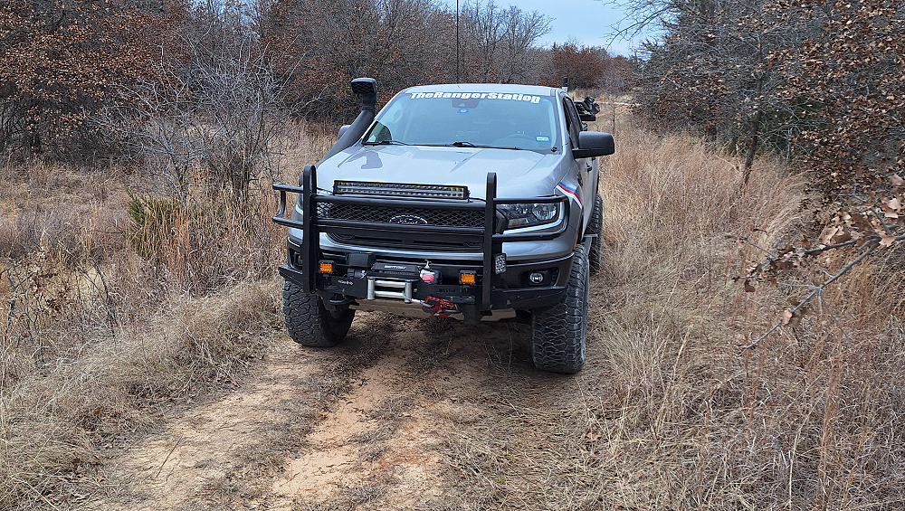

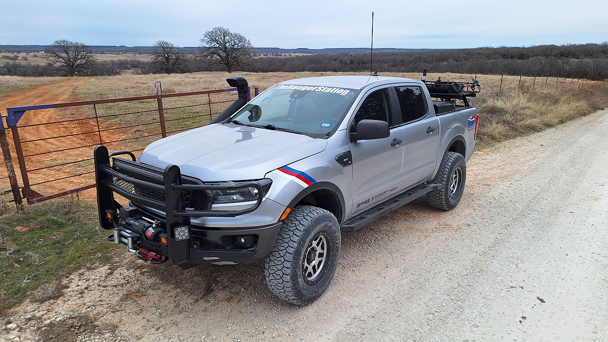

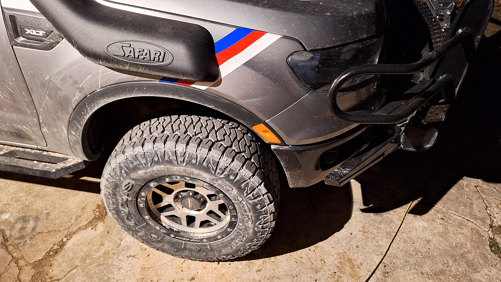

I got the LT295/70R/17 Maxxis RAZR AT's mounted today.
The guy mounting them said they only took 3/4 of an ounce to balance (so much better than the 28 ounces). I can't believe how much quieter these tires are. Way smoother too. When I left the tire shop, I pulled into a gas station to get gas, and I had become so use to the rumbling of the old tires that I felt like the truck had stalled, and I was floating in because it was to quiet and smooth. I couldn't resist hitting some gravel roads and a forest area to get them dirty and take a couple of pics.
I'm anxious to take them off-road.
I still get a little vibration up around 75 MPH, but it seems like it might be in the rear somewhere.
The difference between ATs and MTs on road characteristics is night and day. They look good on there. Look quite aggressive for a AT too. Looks almost like hybrid tire. I know you will shoot honest feed back on them and I look forward to seeing reports on wear and offroad capabilities. Congrats I know when I first put the ATs on it was like driving a new truck on the highway again. The Geolanders are still pretty quiet on the highway right now. We will see how they do as they wear down.
