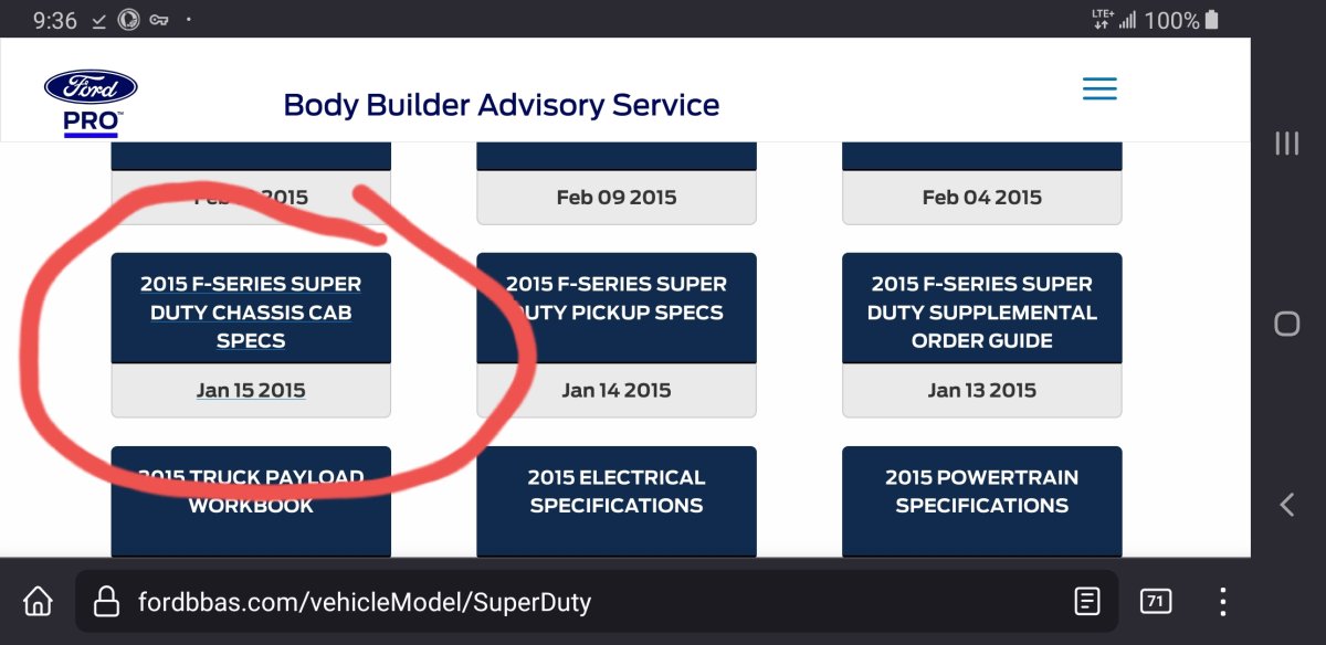

@alwaysFlOoReD : I would have sent him to the 2015 BBLB - Super Duty F-Series publication: It has the dimensions for spring CL for Pickups (45") vs Chassis Cab. (40").
@Northidahotrailblazer : With F-350, you just need to be careful that you get an F-350 Pickup Axle and it is basically a bolt in.

Have a link for the bblb?
@alwaysFlOoReD: It was the row above right hand publication in the screen capture you took.
