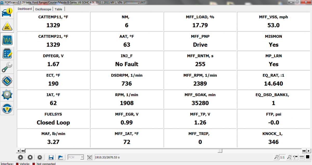

Plugged forscan in last night. The cats supposed to be this hot?? Had been running 20-30 mins, no power, and mostly state road driving.
Cats dont function below around 600f, I'm not a scientist but I think 1,400 would be on the high end of the normal range... but still in the normal range.
Looks good to me too. I had an issue in another vehicle and I looked this up awhile ago. Normally most are in normal range I think up to about 1600F. May vary depending on vehicle I guess.

Very nice display--Cat temps routinely operate to 1600 degrees-- This info your displaying, for a snap shot, looks fairly normal.
What are the long/short fuel trims percentages, currently?? And can you display "graph" readings on the upstream, and down stream o2's??
