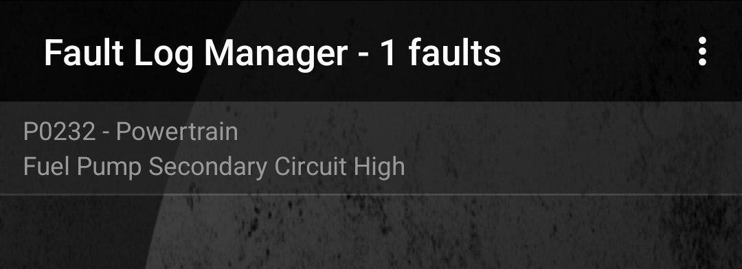

Parked in my driveway with everything working fine last night. Went to leave the house afternoon and wound up with a no start.
Truck turns over fine, but it seems like I'm not getting fuel.
2011 Ranger 4.0l Manual - no start
Scan tool registers P0232... can't remember if this 8s dead relay or dead pump.
Input appreciated before I take the bed off out of frustration 🙃
Swap the relay. You can use the WOT AC relay for testing. Also, with the relay removed, jumper across the pin sockets for the NO contacts to see if the pump runs.
Yeah... dead pump.
Well. The lifespan of this Kemso was approximately 6 years.
At least we now have a data point on them.
Thanks, Ford!
