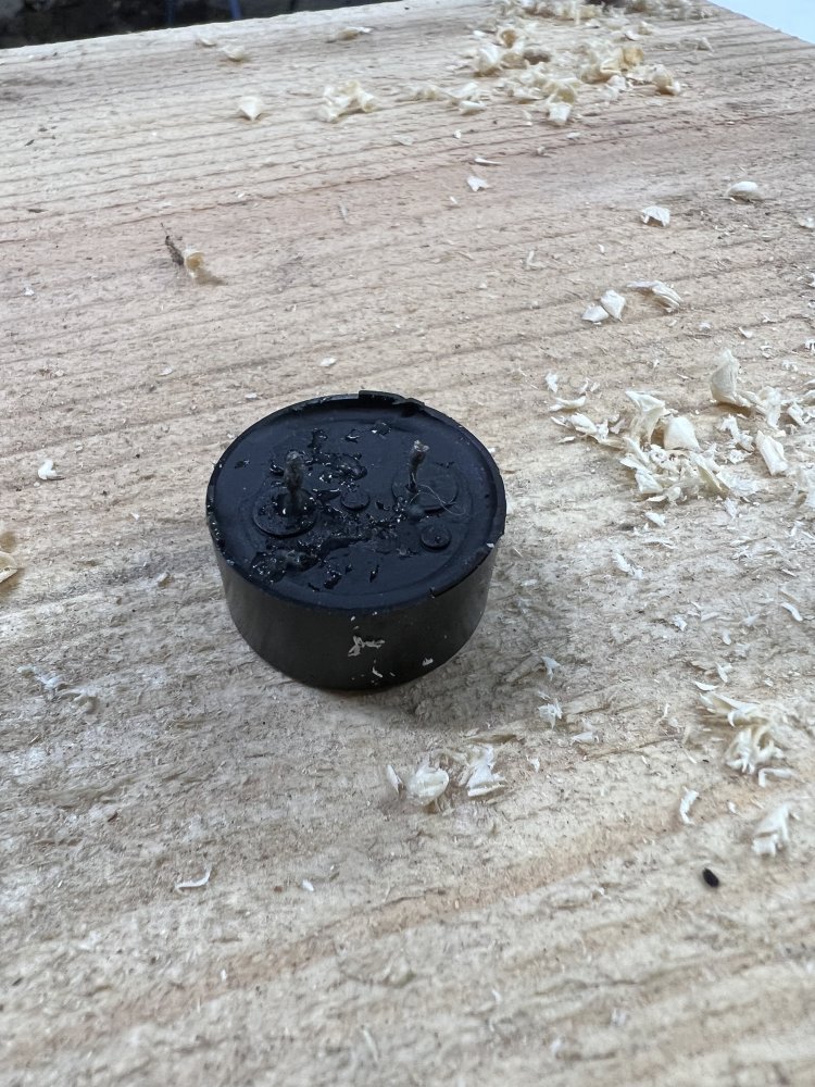

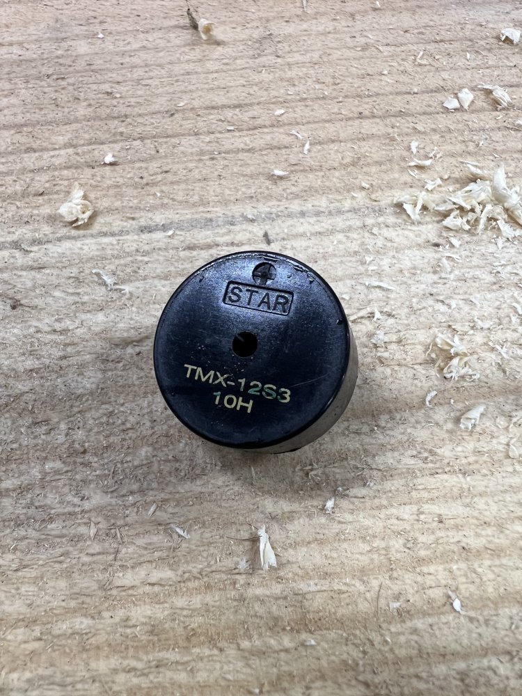

I have a 2011 Ford Ranger and I disabled the Open-door chime noise which is located behind the instrument cluster. After I removed the piece that made the noise, I put everything back the way it came out but now my speedometer doesn't work at all, and my tachometer will work for a little while then eventually quit altogether. What would I need to do in order to get them working again or is it something I won't be able to do at home and need to take it to a dealership or mechanic's shop?

Well I did remove this circle object from the switch board that made the door chime sound but I was extremely careful to not interrupt anything else.
