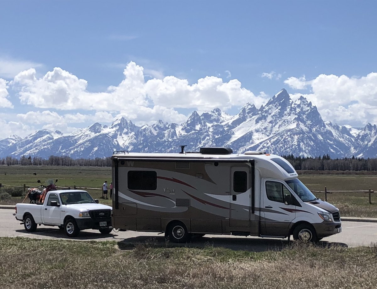

Much appreciation to each of you for helping me. Cheers. This is how we got around last year. No kayak, it was still snowing in the Grand Tetons!
