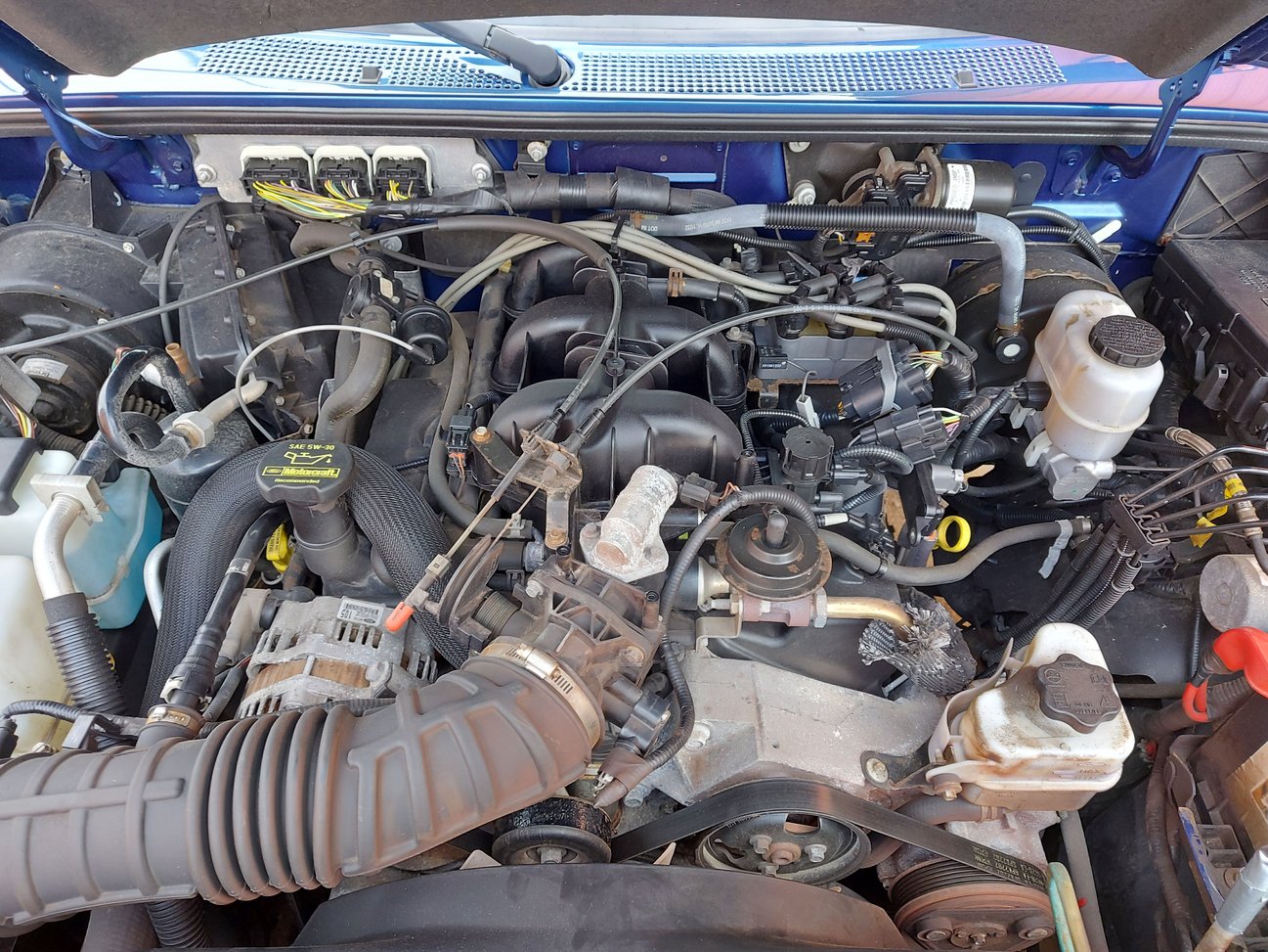

#4, ECU Issues. Again this is a a big ??? for me, as I *did* remove the ECU connectors underhood to get the main harness out of teh way to get the upper intake off to access the lower thermostat housing. See
for what I sorta did - my ECU had 3 connectors without a bolt holding them in.
My ECU connectors look like this
2010 Ranger 4.0: Noticeable drop in fuel economy

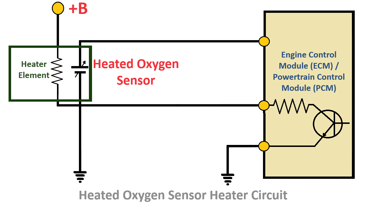

To see if the ECU is the culprit - and again I am no expert on the post 2nd gen stuff - I would see what voltage you get at the o2 sensor with the sensor disconnected (if I remember the proceedure right).... this is where we need a more modern expert to verify/correct me or take lead.
Should be 5.0v max, if you are seeing 10/12v or something like that then either a stray wire is putting power there or the ECU is sending the wrong voltage out... i feel like the blind leading the blind here cause I was borrowing a haynes + chilton from the library and then returned em and ordered one of fleabay - have not got it yet, so I am working from memory on a book I don't have for a system I have never touched (the 2007 in my stable has had zero issues besides Key/PATS).
edit:correction - the heater circuit has 12v on it, the sensor should be returning something 0-5v... it is a 3 or 4 wire connector right, don't worry about the pin that supplies power to the heater.
from the pinout here I can see it would be pointless to test with the sensor unplugged it would all just be open circuit - so ignore my previous stupidity.

This ended up being a grounding issue.
In the engine bay pic above, there is a firewall mounted stud just right of the ECU plugs. This is where I reconnected my ground strap as I was sure thats where it had come from. In teh pic above it looks like the ground strap for the ECU harness DOES get bolted here. As I went thru the diagnosis I couldnt get away from the feeling that I was having some sort of grounding or continuity issue. I moved the ECU ground strap to the right stud/nut that holds the ECU in place and VOILA, my issues described above went away. I then removed and cleaned the firewall stud just right of the ECU housing and put the ground strap back there - my issues described above returned. So I moved the ground strap BACK to the ECU housing again, and when the the issues went away again. I decided to leave teh ground strap on teh ECU stud/nut instead of on teh firewall stud/nut and call it a day.
