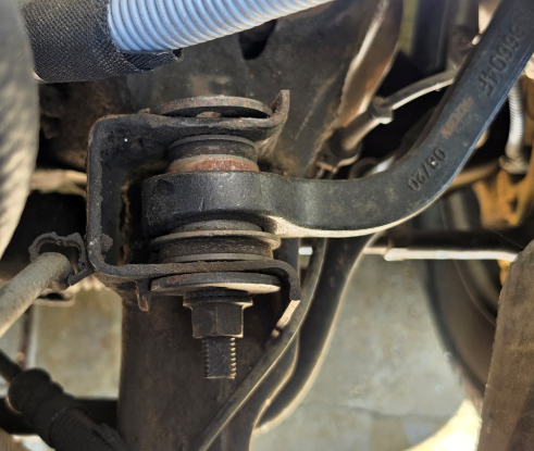

I wanted to start at the top and share what I think looks 'not right'
This is the front / drivers side: Zero lubrication anywhere

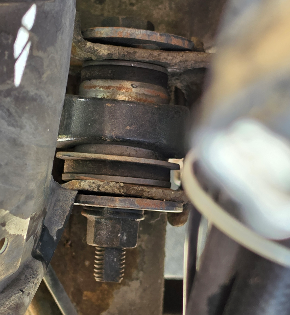

This is the rear drivers side:

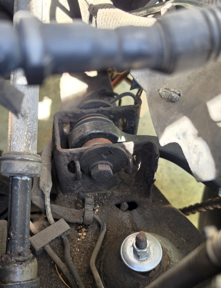

This is the front passenger side

Seems like your pictures concentrate on the A-arm bushings. But the rubber in the bushings look good correct? What are your balljoints like? Have you jacked up each side and tried to wiggle the tire with your hands at 3 o clock and 9 o clock, and 12 o clock and 6 o clock?

the upper control arm bushings do not get lubricated.
all the flexing is performed by the rubber. there should be no metal-to-metal movement.
check the nuts for tightness, do not turn the bolts, they hold the adjustment.
