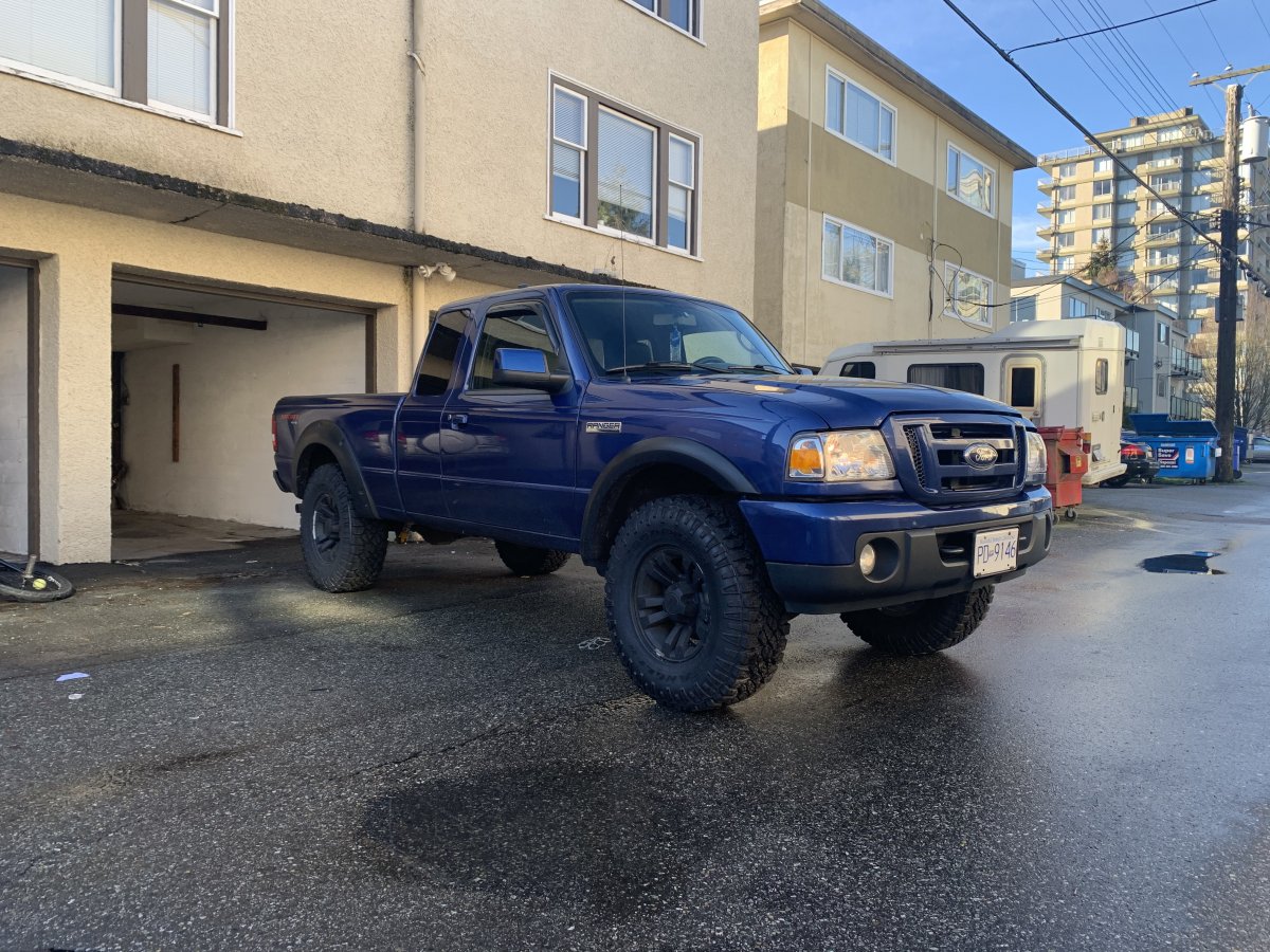

So here it is, out fitted, with my lady behind the wheel all stoked. It's probably one of the worst photos I've managed to take of it. But none the less, have the 285/75/16 Duratracs, 2.25" pro-comp keys, add-a-leaf int he rear and the Bilstein 4600 shocks. There's some rubbing at full crank, hitting my sway bar a bit. But some 1.25" wheel spacers should do the trick I think.

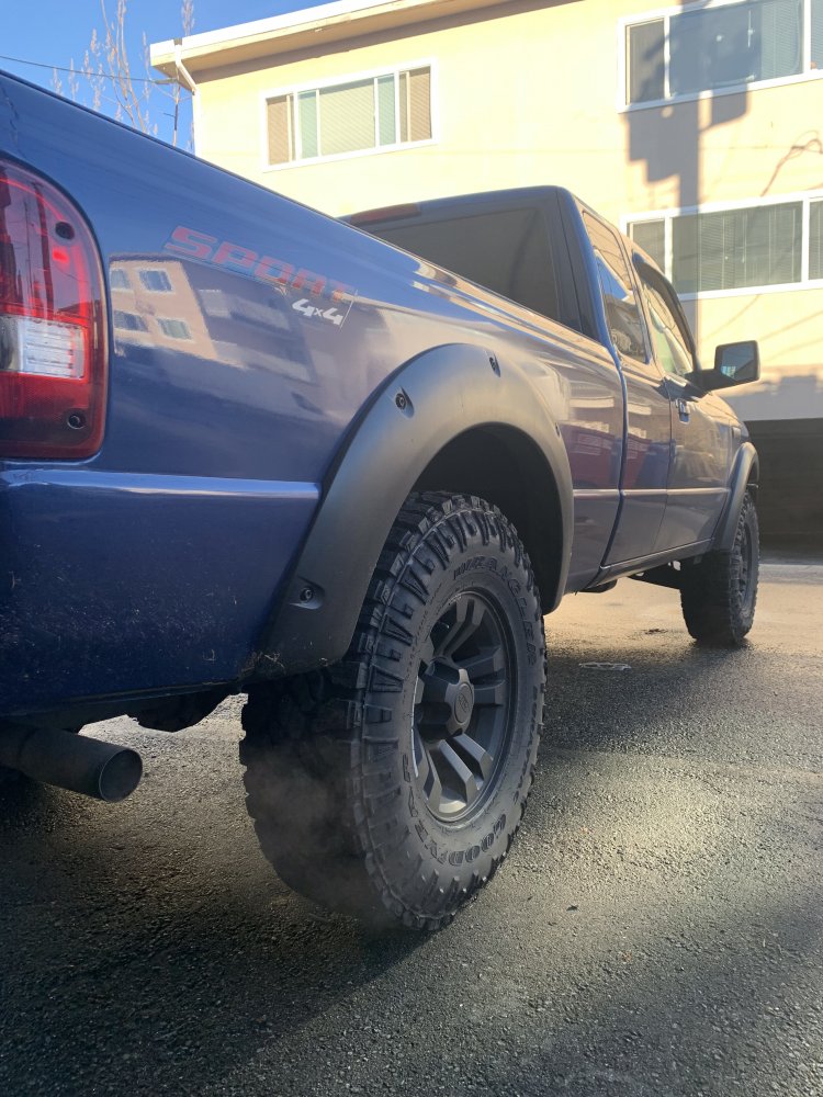

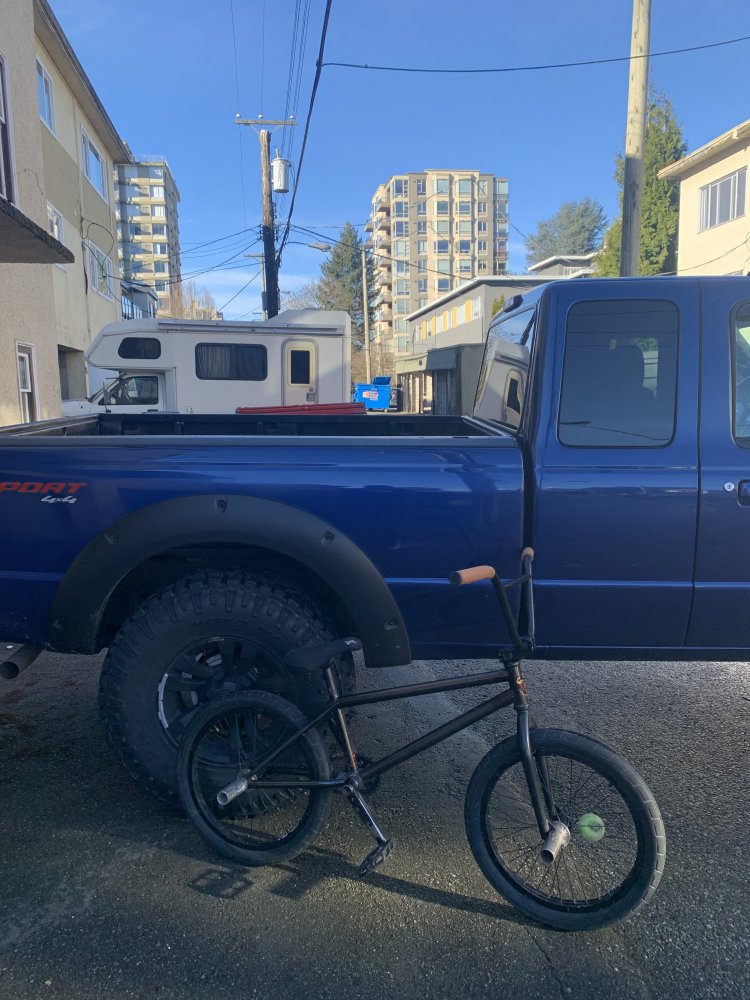

Here's a few more photos. I realize that my fender flares don't match... I really think it'd stand out less IF I find myself with a metal front bumper in the future. Any recommendations on those? I really don't need a winch or anything crazy.

You went a bit further in the front then I care to go. You'll just have to see how well the axles ball joints/bushings like it.
I would suggest looking at the Affordable Off Road website for bumpers,
Nice truck. I like the color.
I recently bough a rear bumper from affordable offroad, which is pretty nice. I have also heard other say good things about them on here.
There was also someone who posted about an AOR cone on amazon that seem pretty good too.
