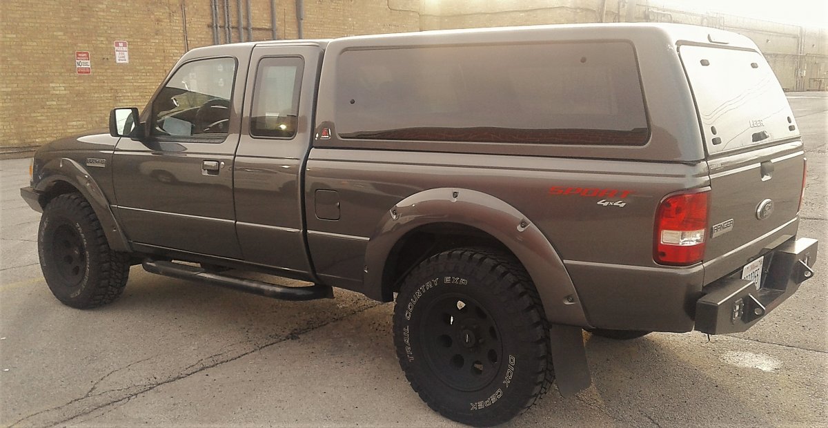

For reference... here is a picture on my 06 at stock suspension height on 32 inch tires and factory length KYB MonoMax shocks. This should be roughly where your truck would sit using pre 08 parts.

Man that thing is clean... that canopy is insane looking, never seen one like that. Jurassic Park looking ranger right there.
That's pretty much exactly what I'm trying to achieve. If the 32s fit on the lift I'm going to do, I'll be pretty stoked on that. Thing I'm going to do the pre-key mod, I'm going to replace my shocks just because I may as well and I'm considering maybe changing the torsion bars as well.. but that's a maybe - not sure what real benefit I'll achieve by doing that other than preventative maintenance.

LOL... Jurassic Park Ranger. I don't know if it's all that... but she's mine and I love her... I call her Bird Dog 1.
Just today when I walked out of Walmart... there is a guy laying on the ground under the front of my truck. I really thought it was going to be ON. But when I yelled at him he came out and just said he was checking out my bumpers. This is the second time it's happened there. They don't give them away... but they are super functional and they sure do draw attention.
Just want to say... your results may vary... but you should be close. If you have a 4.10 gear... a 32 inch tire will work pretty good... probably not optimal... but pretty close. I do plan to turn the front bars up a bit... but I've had a lot going on and it's been pushed down the list.
