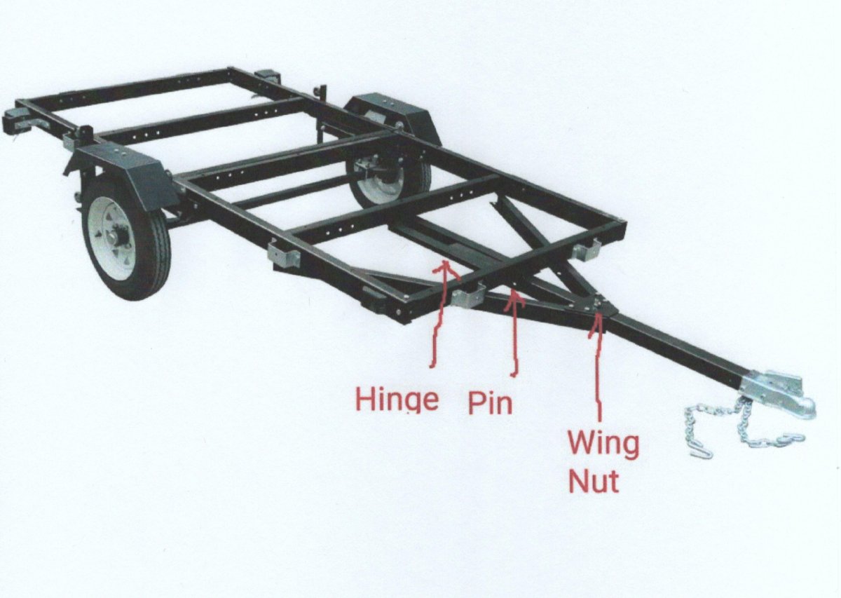

@don4331 the catch with the utility trailer is the pivot is at the root of the tongue bar. You undo the lock pin where the tongue meets the front of the frame and a wing nut from the stud welded to the tongue bar at the tie in plate forward of that. The bed tilts at the axle and the hinge point on the tongue. Since this is drifting away from the OP's thread and subject matter. I thought it best to move this to my thread already started for the trailer.
