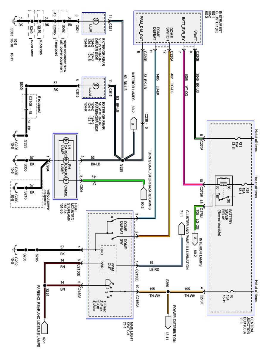

Does any one know which wire along the door sill that I can tap into to light up after market running board lights that mimic the cargo light, basically they will come on with the door opening or key fob lock/unlock function? If this can be achieved by tapping into a fuse that would be even better. My last option will be to tap into the cargo light and pull the wire through the pillars.
Black/lightblue I believe.
