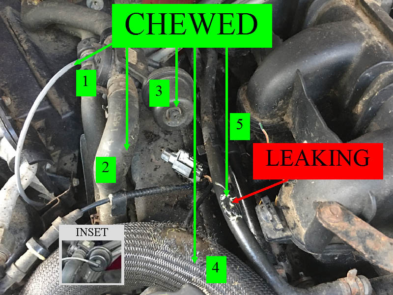

This afternoon, I went over, put a brass barb coupler in the leaking coolant line, hooked up some jumper cables, and cranked the truck to life. We reached a mutually agreeable price, I paid her cash and received the signed title. Drove the truck the mile back to my place and returned on my bicycle to pick up the RX350.

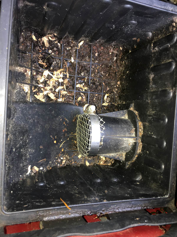

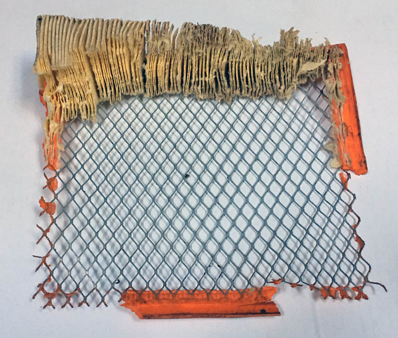

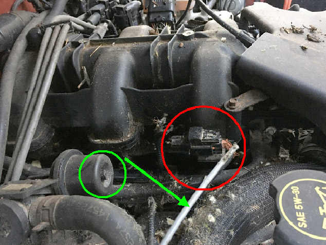

This truck is going to need some minor work. In addition to the rat damage, there seems to be some electrical gremlins that will need attention. The radio won't work unless the parking lights are on, and none of the radio buttons work, so it is stuck on 530 AM standard broadcast static with no way to adjust other than volume. That I can live with for now. More disturbing is the unusual random small relay clicking under the passenger side dashboard when both doors are closed, even with the key off. Opening either door stops the clicking. I'd be less concerned, but while driving home, the "door open" warning lamp in the instrument cluster was illuminating on and off, accompanied by an annoying electronic chime.
