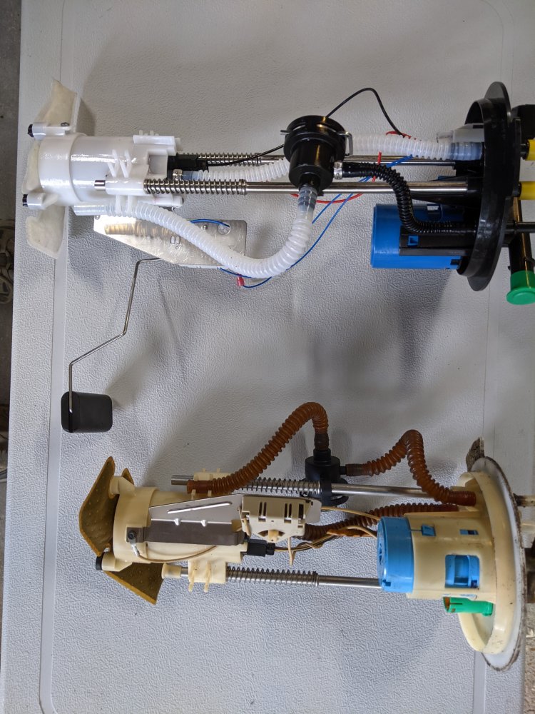

I ordered a new fuel pump on eBay. It said it fit my truck. I was putting it in today and it would just not go down far enough to put the ring back around it. I took it back out and it was taller than the oem fuel pump.
Now I have to send the one I ordered back. I am trying to find one that will fit on several different websites. Non of the sites give the dimensions
of the fuel pumps. I even messaged the sellers with no response. I don't want to order the wrong fuel pump again.
I even got the part # off the OEM pump and tried to look it up, but it wouldn't pull up the exact part #.
I am going to attach some pictures to show you why the new fuel pump wouldn't work.
Any comments or advice would be greatly appreciated.

The universal Pump should collapse/slide down enough to work
Rangers have 2 different size gas tanks, 17gal and 20gal
You can see the springs on the silver tubes that allow pump assembly to fit either size
But your new one does look too long even with springs compressed
Maybe you can pull out the silver tubes at the top and cut them down to match OEM tube length, or swap them with OEM tubes and springs
That may void warranty so just a heads up
Thanks for the reply. I messed with the new one and tried every which of way to get it collapse down to the size of the oem an it just wouldn't work. I tried so much I thought I would break it. The only thing different about my Ranger is that it is an Edge model. It is just a 2wd regular cab that has the height of a 4 wheel drive. Just like a Toyota Prerunner. But the one I ordered said that it fit an Edge.
Maybe someone knows how to make the one I ordered collapse down. That way I want have to send it back and can get the Ranger back on the road.

"Maybe someone knows how to make the one I ordered collapse down......"
Yes, shorten the tubes at the top they look about 2"-3" longer than OEM
Or send it back
They have sent you the wrong pump regardless of the "claim" of what it fits
Could be an honest mistake(wrong part in the box) or an "on purpose" because they were out of the correct model
