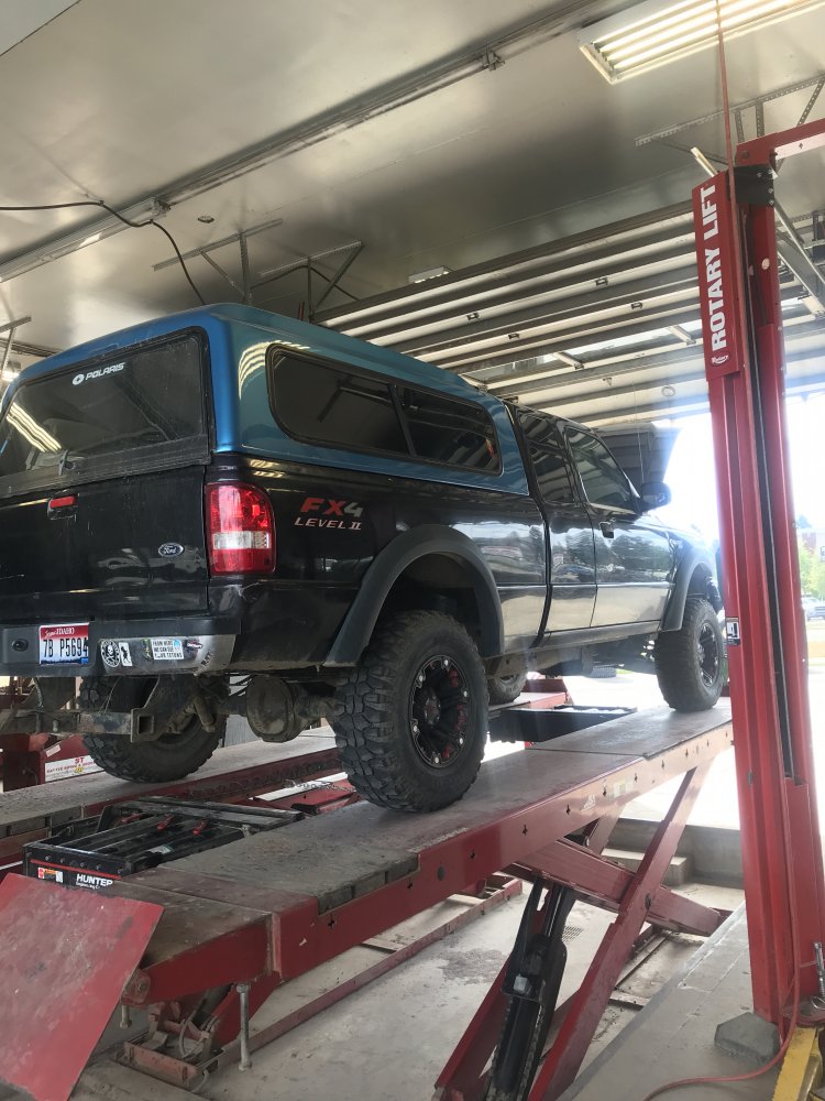

Pulled the truck into the shop where I work and now the fun begins again.
Gonna be doing ball joints, tie rods, wheel bearings, etc....
Rear brakes are all bad and corroded so I’ll be doing rear shoes, hardware and cables too!

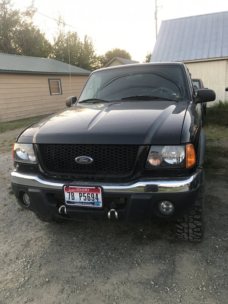

More fun stuff.
I put in some “new to me” head lights and I like the way it turned out.
They are cheap china brand but they make the truck look a little more stealth lol
Watch out with those style of headlights, they leak and will fog up and corrode the reflective coating. I had a set when I purchased my 2007 yellow sub fx4L2. You can however add some sealant to the edges where the front & rear halves met. Good luck. I'm doing a front end rebuild also.
