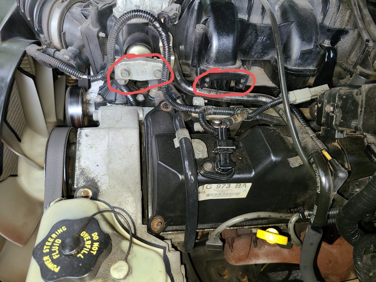

Another dumb question - my particular engine does not have an EGR valve from the factory (I had to do a lot of searching to confirm the previous owner didn't just do an EGR delete). If I get a donor engine with an EGR, is it just as simple as taking the EGR stuff off and re-using the blank plate on the intake from my current engine?
I ask because I have a 2002 4.0L FX4 available to pick from, and it has the EGR (like most other 4.0's out there). I haven't done enough research on EGR/emissions/vacuum lines yet.
Yes just remove it. You just can't use an EGR equipped engines computer on a non EGR engine or vice versa. If you're keeping your current computer you can just ditch the EGR stuff and block it off.

Check out the vacuum line diagram on the rad support on my previous 2002 vs my 2003.. dunno why Ford did it. From what I can tell it was 03 only.

Photo showing blank intake manifold filler plate and unused solenoid mounting bracket holes:
49561
