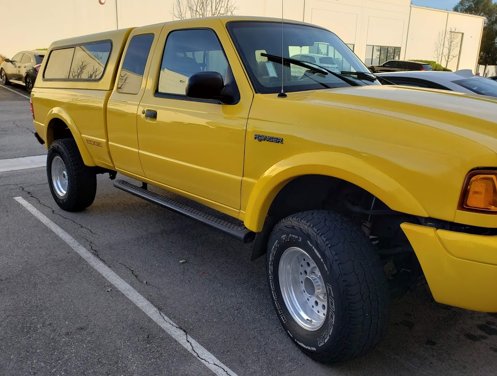

Good points made with tire clearance and gear ratios mentioned above. With the lift you have as @DRanger024 mentioned... 33X12.50's will fit most likely with zero issue. I chose 32's with my 4.10 gear... to put 33's back in the sweet spot would require a gear change to 4.56. But lots of folks run 33's with a 4.10 gear.
As for your fender flares.... those look like factory stuff to me.
