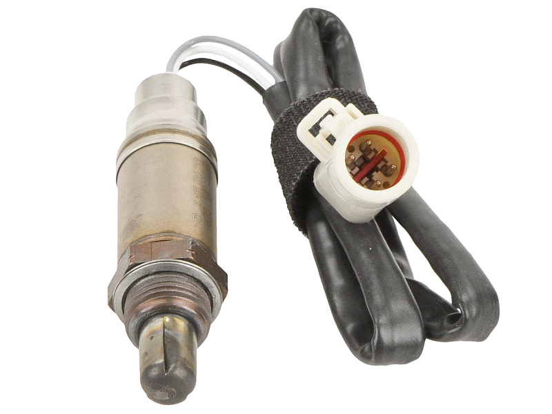

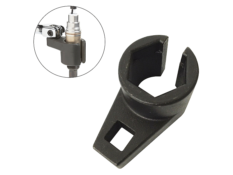

A Bosch 15719 with 24i00 0m610 Long Cable+Plug is good to replace any Ford 4WireNarrowBand OxSensor;
PenetratingOil & a 22mmSplitSocket, route longer cable away from hot & moving parts, secure with ZipTies.
