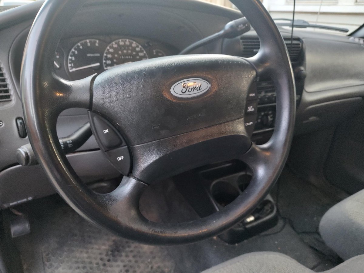

So I installed the cruise control components and the cruise control worked first try. The parts I used were as follows:
https://www.ebay.com/itm/265397702586 (Steering Wheel Buttons. They came with the wiring).
https://www.dormanproducts.com/p-102185-525-228.aspx (Clockspring for Ranger with Cruise Control).
Used Chassis ECM Cruise Control Servo Assembly Part# 6L54-9C734-AA. It came with the mounting bracket to the firewall as well as the throttle cable.
Everything bolted right in. The only modifications I had to do was trim approximately 1/2 inch off of the plastic on the column so they buttons would fit. Forgot to take a picture of trimmed plastic. Can confirm https://www.therangerstation.com/fo...plete-oem-cruise-control-installation.160781/ Is a good tech article.
