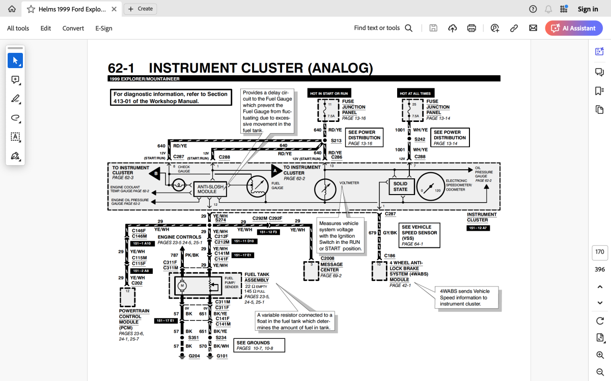

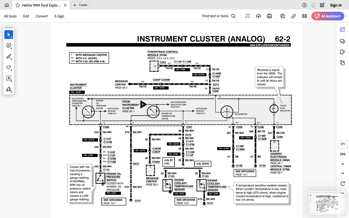

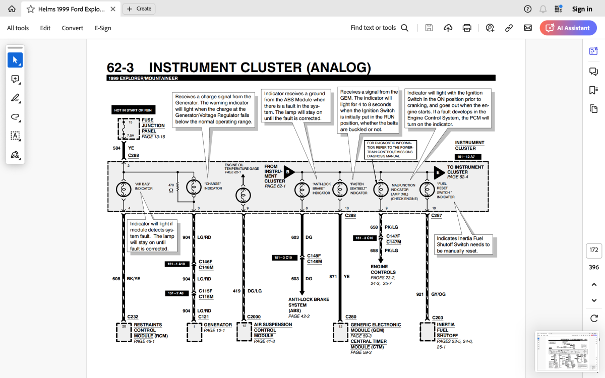

1999 Helms/Ford EVTM. Cluster runs on 12v/gnd and an 8kPPM signal bussed from the ABS module, balance are DUMB analog gauges with independent senders, there is no CANBUS here. No SERVO motors. All devices, radio volume, etc all get the ABS pulse train, including the speedo, with no interaction from the PCM. Maybe the tach wont be happy.
Im just not seeing a complication. PDFs attached for your perusal. All those module connections are not DATA, they are idiot light drivers not stemming from PCM activity.

Rusty:

Rusty:
