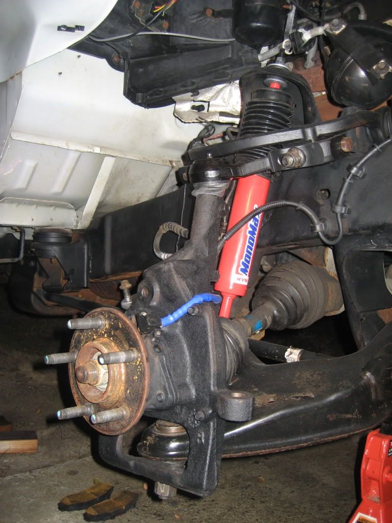

I didn't follow the book with the T-Bars. I simply canked them (loosening direction) till I got the droop height I was comfortable with, as shown. Have fun with the 32 mm axle nut (live, non-PVH), loosen those suckers while the tires are still on the ground.
No need to touch the torsion bars period....I don't know why people do. Support it by the lower control arms, remove the knuckle, replace the upper control arm and then press out and replace the lower ball joint.
