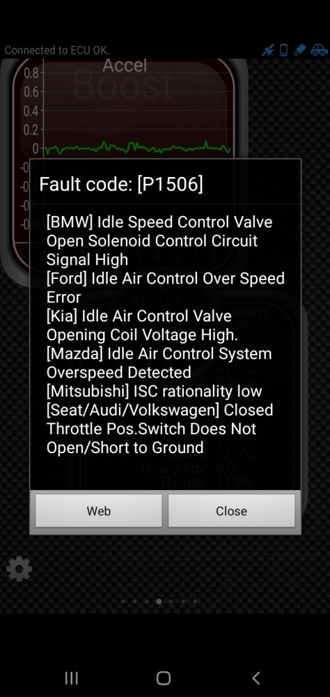

49769
49770
the iac code was a code I was seeing before I swapped the ENTIRE electrical harness for the truck. I reset codes and it came back. The iac like said is new and replaced after I swapped harness and cleared codes. Egr is new though
What brand is the IAC valve...
