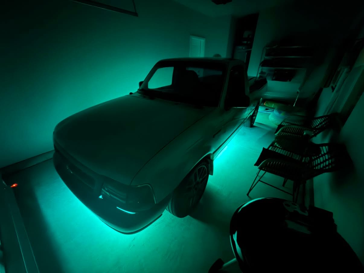

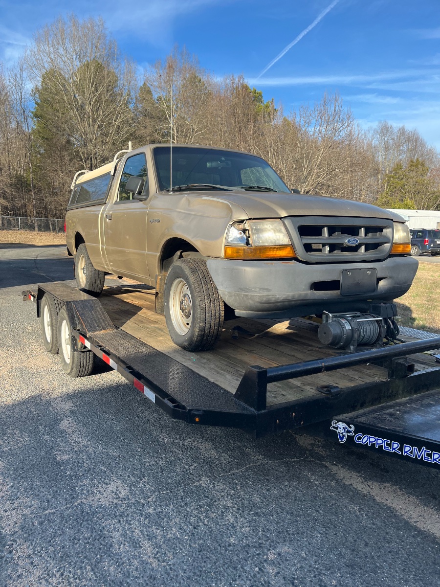

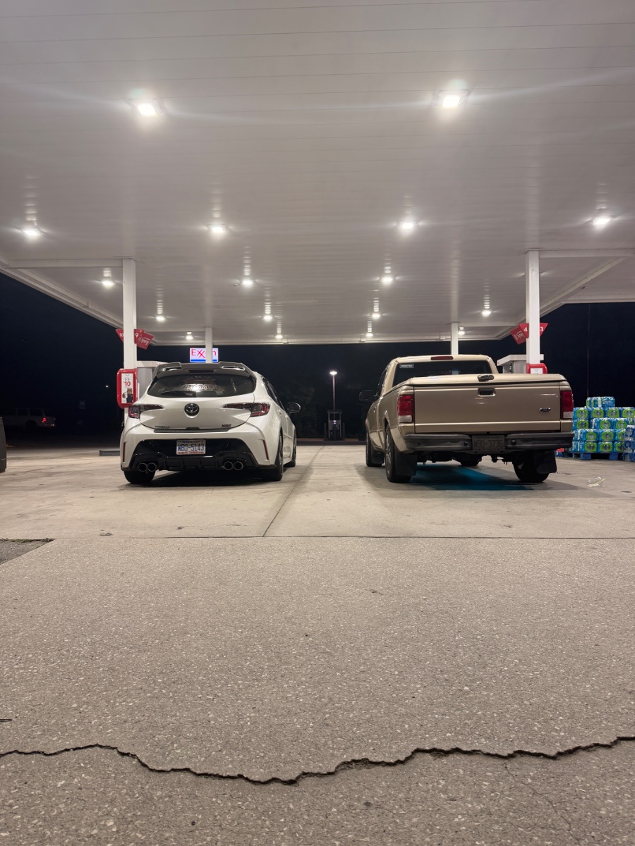

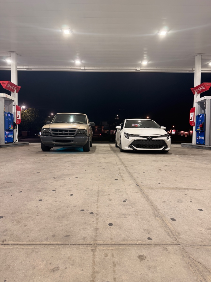

Here are some pictures from when I got it to now
