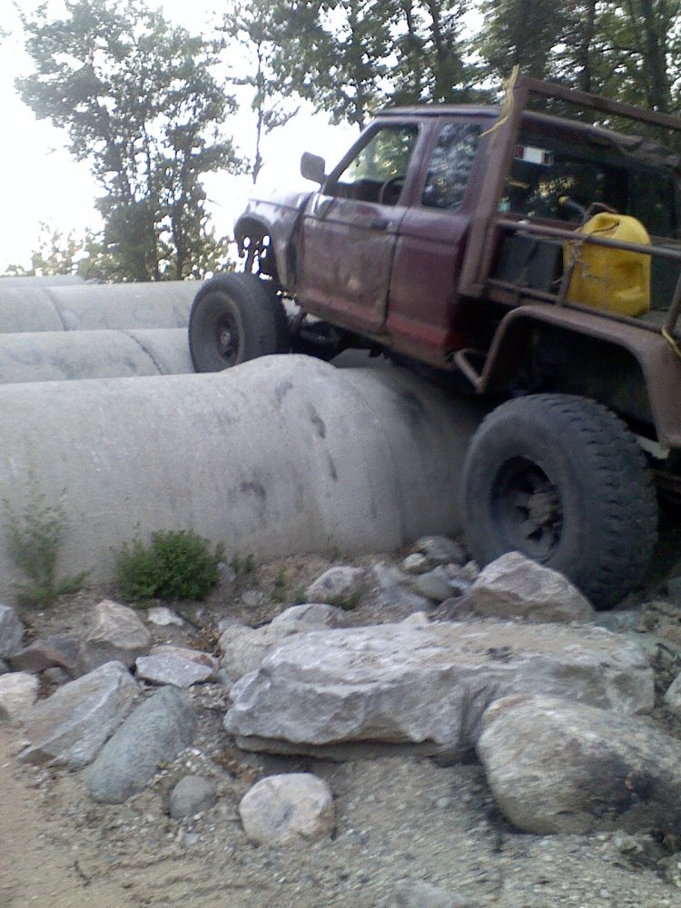

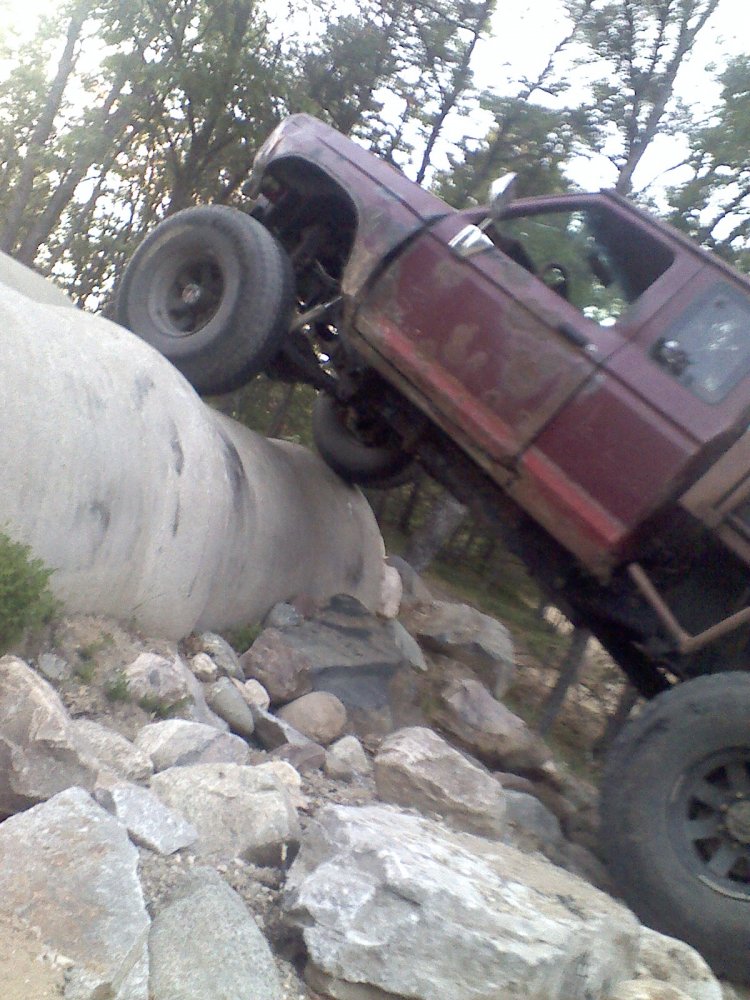

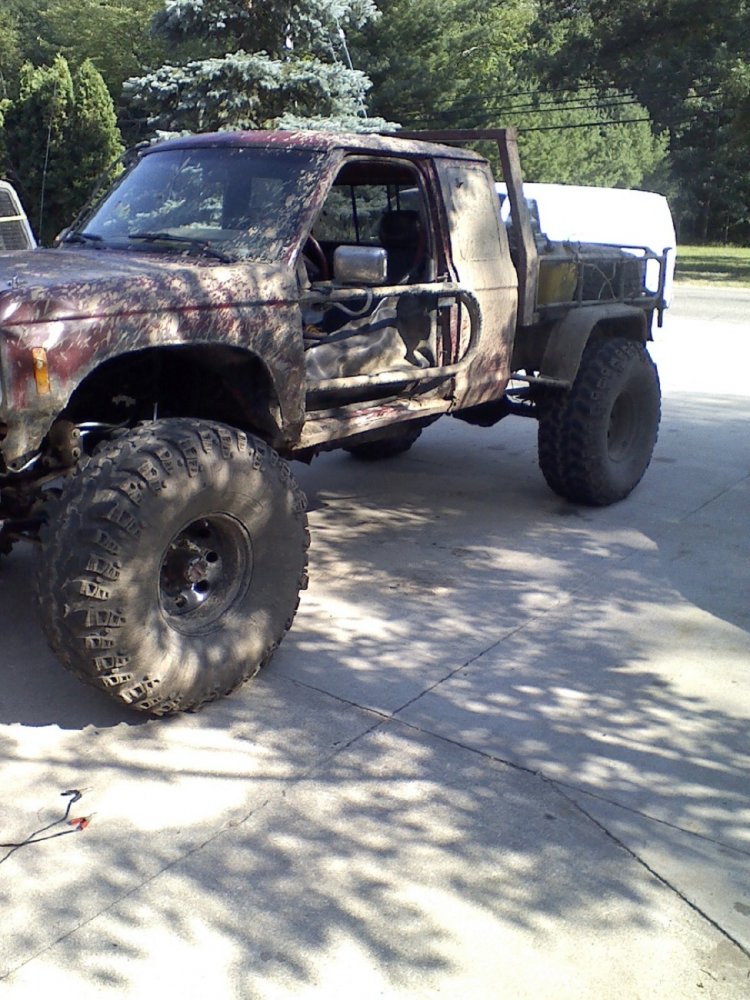

i run them for years...extremely overloaded....truck pulls, tough truck, and sand/mud racing and ridiculous off road abuse... i twist up springs like bailing wire.....my front springs on my 60 are w'ed right now.
this axle in the ttb pics was about another 1/8 wider perch spacing then stock b2....because I fawked up when I dropped off the mock up axle....it was a b2 axle and not a ranger....
these are old pics.....but this truck has over 1.2 million miles on that frame and whats left of the cab and sheet metal sans doors on the oem spring hangers.....
shackles....well...murdered dozens of those..and axles...and transmissions and drive shafts...
been on its roof twice....and to this day i will hop in it and drive thousands of miles one way to go to work if need be. AND I DO.
so. no. i am not concerned about the b 2 axles difference in perch mounts vs ranger dimensions.
