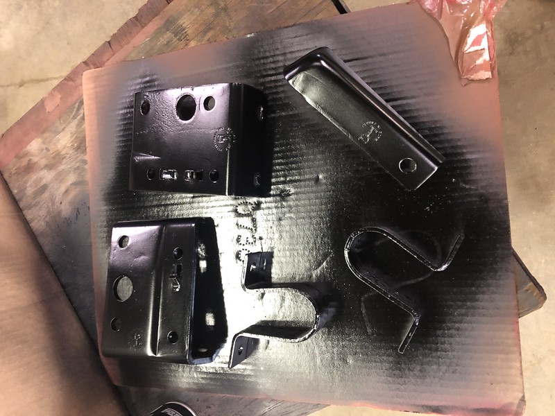

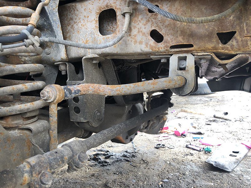

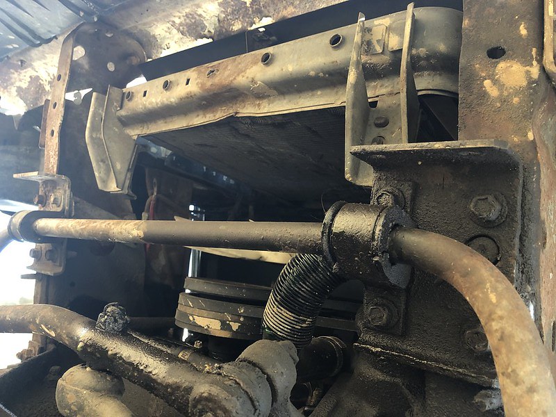

I am kind just starting to delve into this thing, I have found at least three different kinds of front sway bars on TTB (4wd) trucks.
TTB standard cab Ranger (D28)
Not a real good way to get a pic of it, bar is behind the axle and actually runs in the radius arm brackets and goes ahead and is clamped in the radius arm with the shock mount.
The two bolts behind the front shock are actually a U bolt that clamps the sway bar. You can kinda see a shadow of a sway bar making the turn at the back of the radius arm to go into the radius arm bracket...
Super Cab Ranger (86-??) and Bronco II (84-88)
They had the sway bar in the front of the axle. It kinda looks like they had a width issue so they have stamped plates to move the sway bar mounts inboard. May have also had a slight structure issue, the DS frame rail is a little more boxed thanks to the steering box, the PS bracket has an extra brace running to the top of the frame. First gen BII pictured (crappy picture of the brace, I apologize):
In the interest of having a disconnectable front sway bar for offroading I am converting my truck to this style. I pulled my front sway bar off of an earlierish second gen and the reinforcement bracket seems a little short. I do yet know if they changed something between the front of a std cab Ranger frame (what I have) and a scab/BII OR if it is a first gen to second gen change.
And then when they added a crossmember (later second gen Ranger, first gen Explorer, second gen BII??) they ditched the plates and bracketry and just mounted the front mounts directly to the frame. Note the front bolt goes thru the added crossmember. First gen Explorer pictured.
