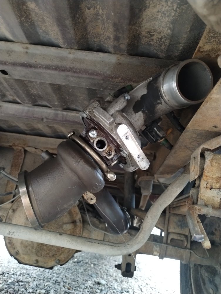

Strapping a turbo on my 2.9L, have a greased turbo that doesn't require oil lines, and running it just behind the rear axle so heat soak isn't an issue, intake air temp after half hour running is 70 ish F, just need to get my tubing ran along the chassis for the compressor intake and outlet up to the intake manifold, it'll be all tucked away and out of sight, have it regulated for 10 psi ATM will see how it goes from there, 2 new engines to swap in it, so this one's kind of the big bang engine, 235k and on its last leg, will be sure to get video 🤣
To add to the piston conversation, i've been running OEM rods with eBay chinese crap pistons on my 2.9 and mine's successfully made 370 with a gtx3076. This may be a parts-bin dance you guys are doing that isn't totally necessary. Although sticking with stock parts, OEM or cheapo aftermarket, means I'm stuck with factory compression. Should probably mention that my cam & valvetrain allows me to rev it to 7300.
Strapping a turbo on my 2.9L, have a greased turbo that doesn't require oil lines...
Don't TEASE... needz us some names and Part #'s of such a wonderful creation!
