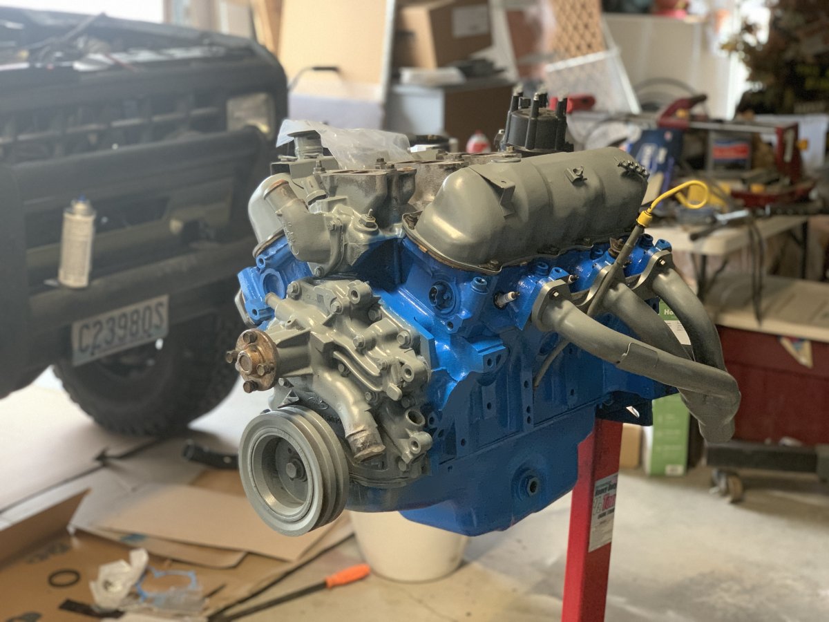

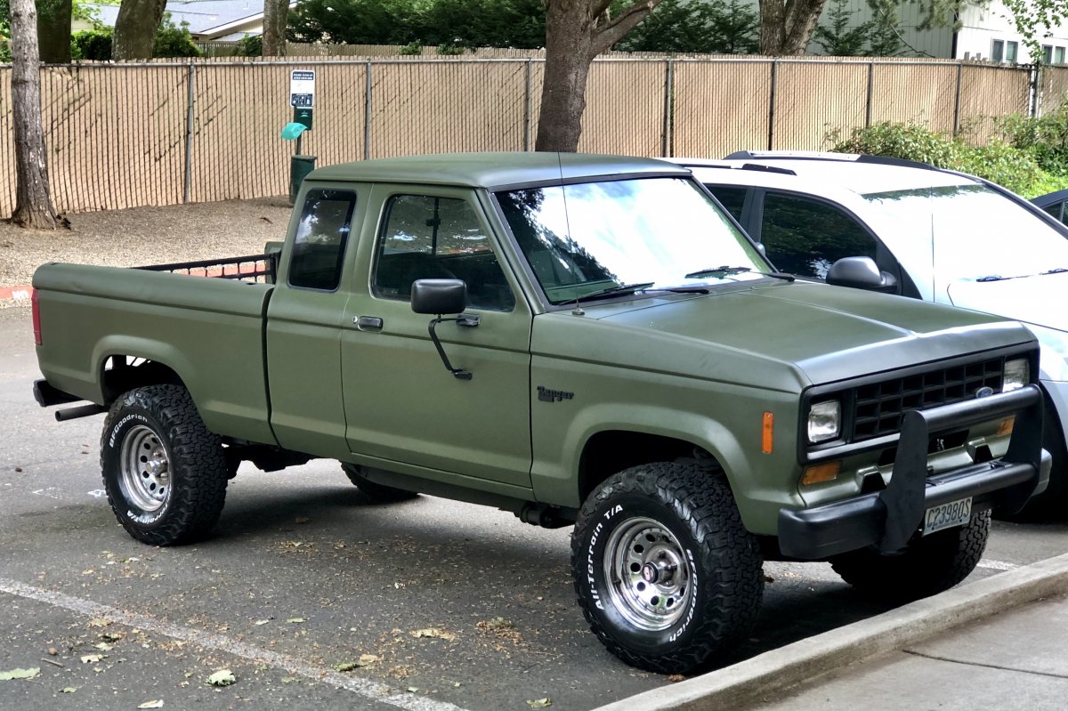

So, I just rebuilt my 2.9L. It’s bored +40 and stroked and I put an RV cam in it. The motor literally has only 2000 miles on it as of today. I’m seriously considering putting a turbo on it. I was originally going to super charge it, but figuring out the mounting is just not what I want to do. I plan to turbo within the next year.
I should add, my cooling system is far from stock, and I’m currently running without a thermostat.
I think I’m probably sitting at about 160-170hp right now with all the upgrades I’ve done (it’s really snappy). I’m trying to break the 200hp mark. Are there any manifolds/turbo’s that will bolt on from other years/motors, or am I stuck on eBay trying to piece this thing together and fabricating?

Where did you source the stroker crank?
4.0 crank with compatible rods and pistons brings displacement up to 3.5l or so.
Honestly couldn’t tell you, the machinist I took it to ordered all the internals for it. When I dropped it off I told him, I want more power lol. When I picked it up, I had the goodies. It wasn’t cheap, I will say that. I’ll get in contact with him and find out where he found it.
Never had a chance to ask, but did you wind up using cast or forged pistons? If forged, where did you source yours??
I wound up with cast, the block was in the shop for 6 weeks, I was itching to get it back. Didn’t want him spending more time trying to find the Pistons. Lol
