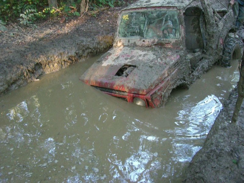

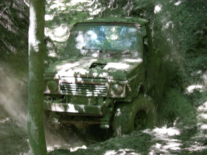

the only thing i diden't like about the 4.0l in my 91 sploder was it would start to misfire if you ran through water too much and splashed it around the engine compartment.i've been up to the bottom of the headlights in my 2.9l truck and it diden't cut out with a relocated air intake.(but if my truck stopped while up to the lights i'de probably be shit out of luck).i know it could just be that particular truck but anyone else have their 4.0l start sputtering after a few mud runs?
2.9L to early 4.0L swap really worth it?
never had a problem with water with my 93 4.0v6 in my samurai.
