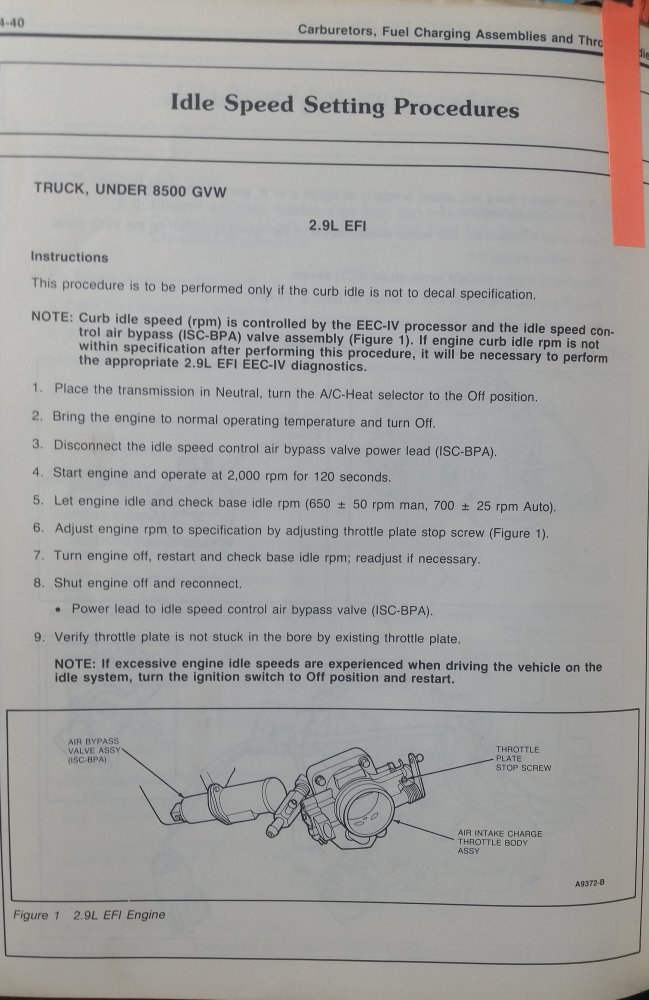

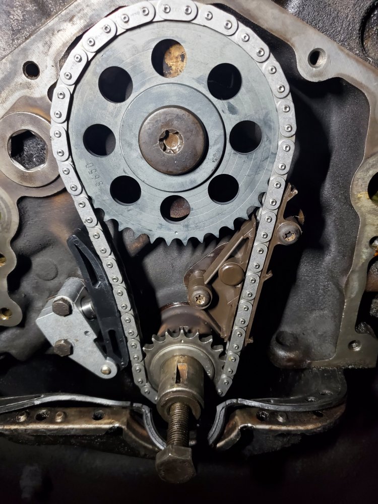

So I think I found the main issue talking to some ford techs and the previous owner. His son Couldn't get it to idle and messed with the idle screw. Does anyone know how to adjust this back to factory. Also the truck is backfiring really bad. When I did the timing gears the tab on the aftermarket crank pully broke. I turned the cam pully back to line up the marks and reassembled. Is it one rotation of the crank to half rotation of the cam or did I mess that up bad?

Timing marks are lined up. The #1 piston should be at TDC with both valves closed. Im not seeing much in the way of why it wont run. Theres a trick to set the "idle" screw, don't know if that is what they call it with a EFI. Its in the tech library i think. Mine is just turned in enough to touch the linkage and take pressure off the plate spring in the Throttle body.
To get an approximate setting on the throttle screw, you can unplug the IAC and crank in the screw until it just barely stays running (think ~600rpm). Then use a volt meter to check the IAC - I think that's supposed to be returning around .9 volts at base idle but I can't remember for sure. There's a limited room for adjustment on the IAC to get that correct by loosening its mounting screws. Then tighten everything down and reconnect the IAC plug.

Where's the woodruff key for your crankshaft in the photo above (post 32)?
