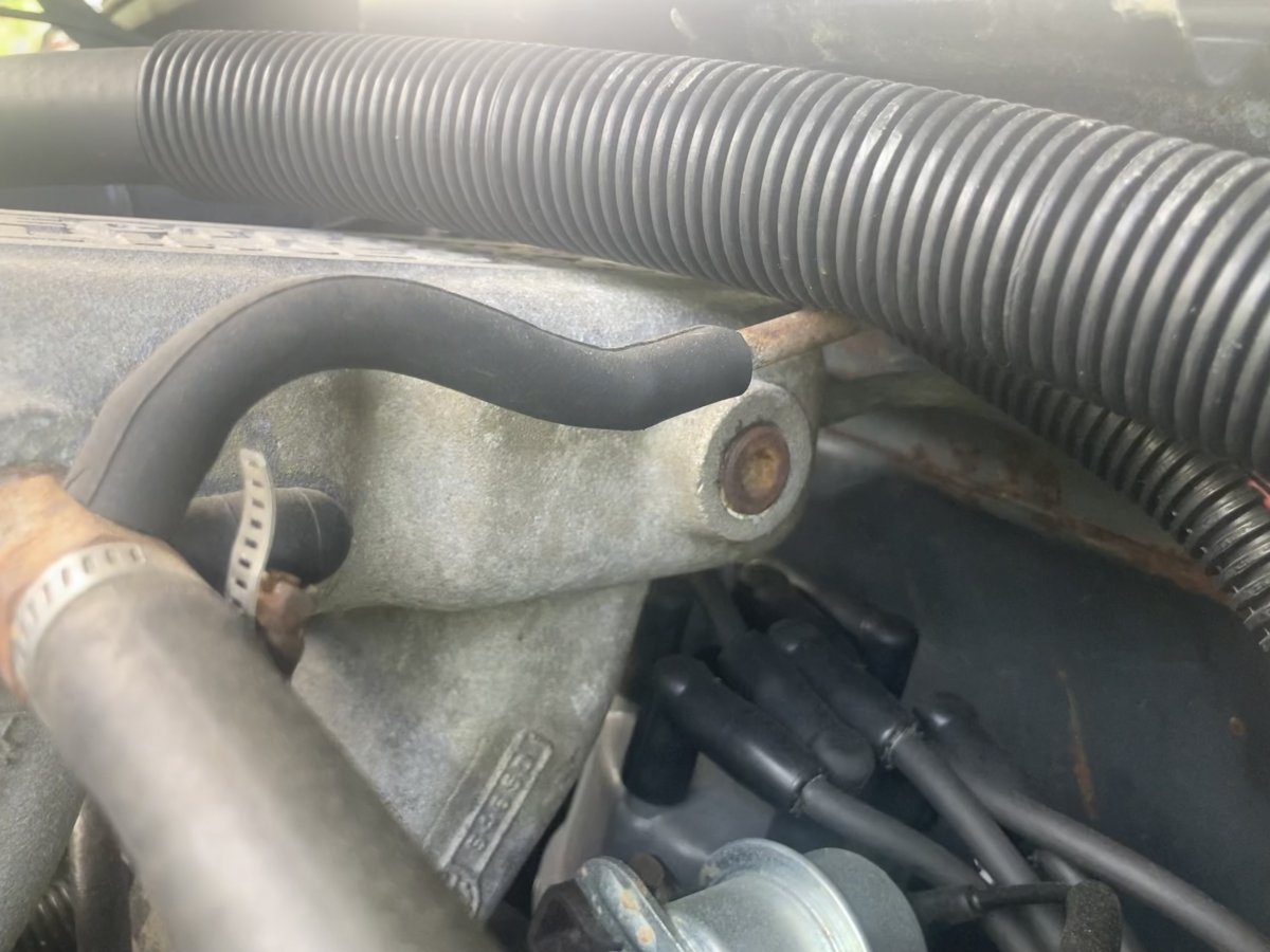

I want to hook up a vacuum gauge to the intake manifold and have it sit in the cab so i can better monitor the engine while driving for a few days. I took a pic of a rusty hex/allen driven piece that’s in a spot on the drivers side near firewall. Maybe this is a good unused vacuum access point to hook up a gauge? I'd need to be pretty careful removing it but if successful it would be a nice ergonomic location to run a vacuum hose out of the way and into cab.

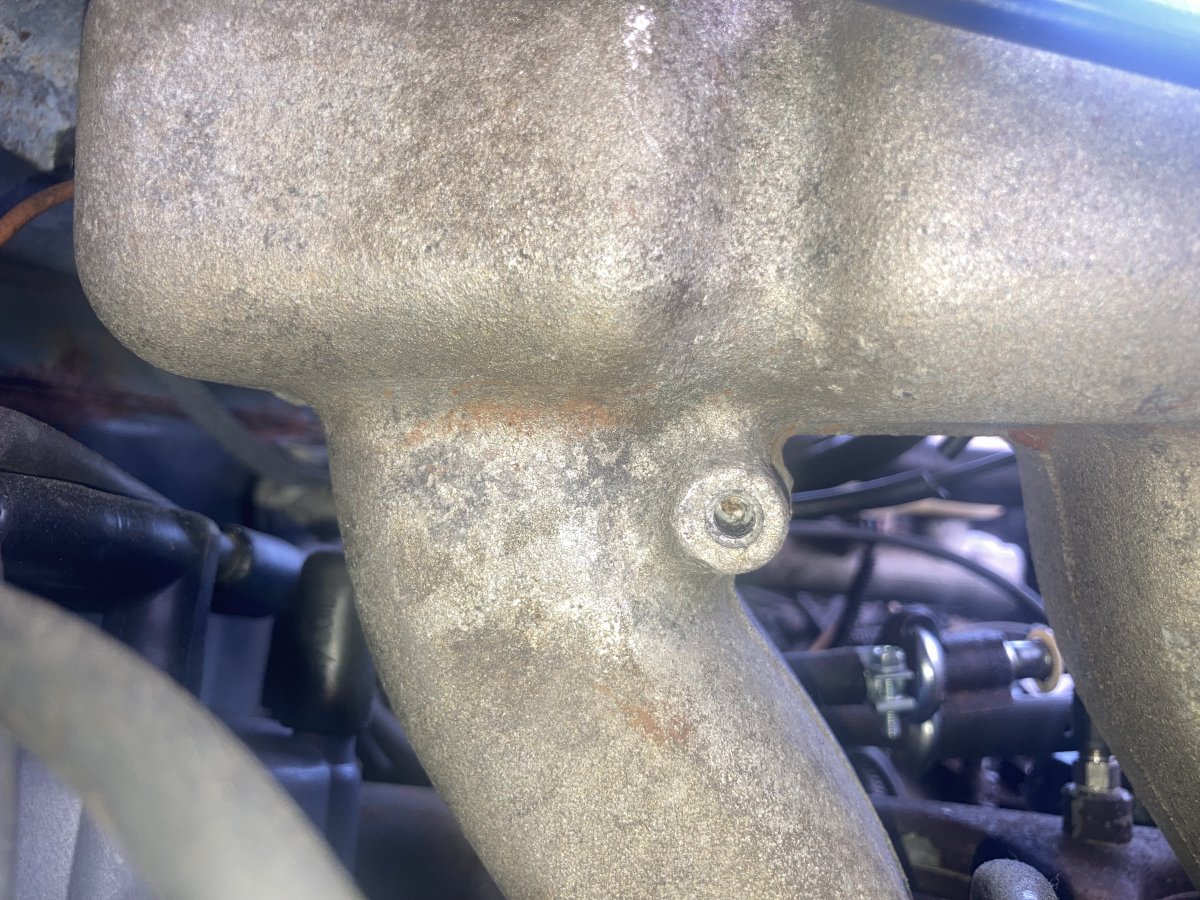

Also there are a couple mysterious threaded holes on the intake, and I’m hoping those are just external and aren’t leaking some internals somehow. Figure the smart thing is to post a pic of one here too just to see if I’m gravely overlooking their openness...? I mean you can see the back wall inside of it using the camera flash, but still I want to confirm there's not some sideways routing in there.

It looks like you can tap the vacuum tree right beside where you want to pull the plug. If I'm seeing clearly there is a cap on one of the outlets.
