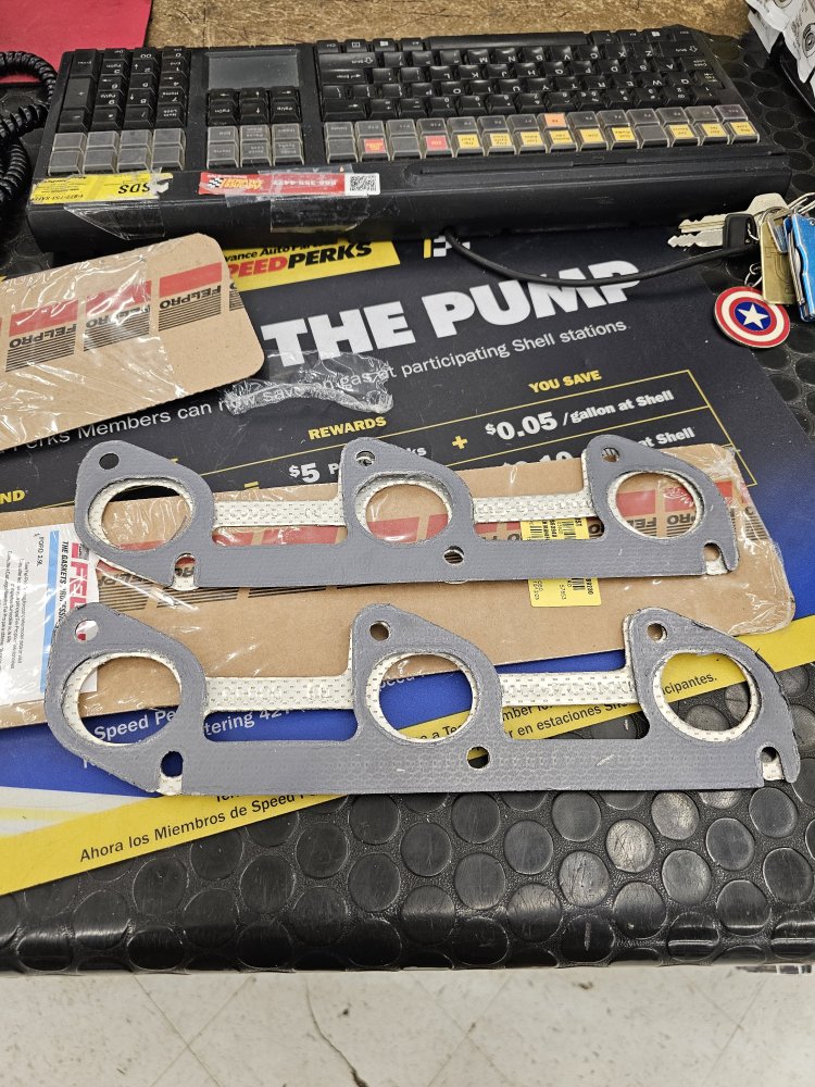

From what I can tell, the exhaust gaskets bolt up perfect and have no differences other than the 4.0 holes being bigger. I'm gonna keep looking around before I make a purchase on a set of 4.0 headers.
@TexasDuck66 ,
GreaT JOB MATE!!
The next and more amazing pic will be the 2.9l gasket on 98+ OHV 4.0l head exhaust ports ..)
