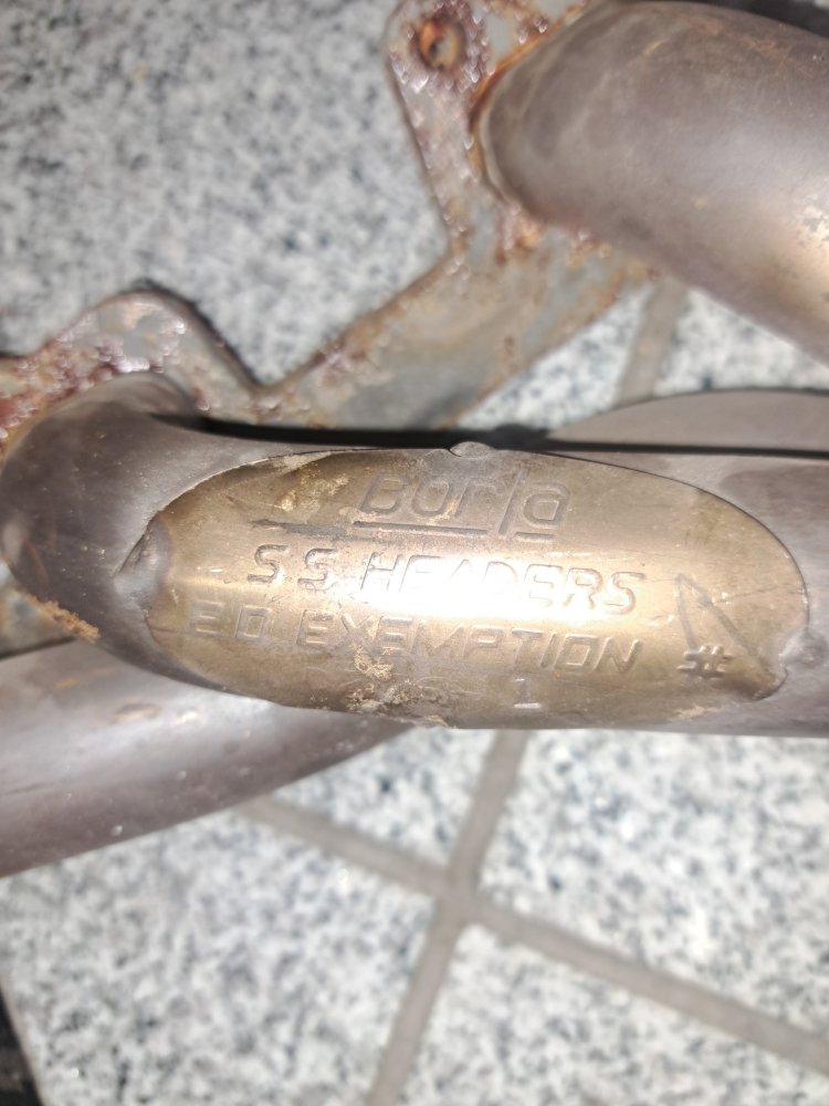

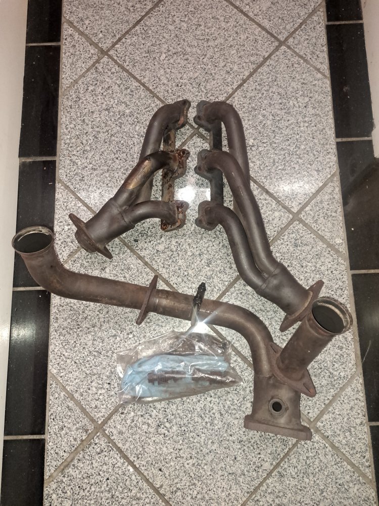

The Borla headers are in great shape. The crossover pipe can be shortened to fit the 2.9. I have 2 sets of JBA headers for the 2.9 in storage, not near me currently. I think I still have the set of Hedmann headers I had on my 4.0 Aerostar van.
Oh wow! I probably won't need the crossover pipe. I had the intention of doing true duals with an X Pipe. How much would you want for the Borla or the JBA?
You'd want the JBA headers for a true dual exhaust. The ones I had on my 2.9, the ball sockets at the collector kept loosening up and leaking so I had someone weld them to cure the problem. The silver coating looks decent. The other JBA set has surface rust from being outside for 15 years. $350 for the JBA but I can't ship immediately or $500 for the Borla that can go out tomorrow.
