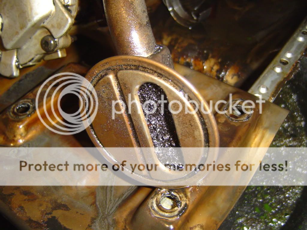

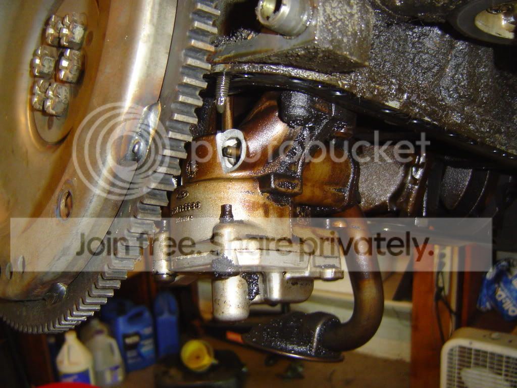

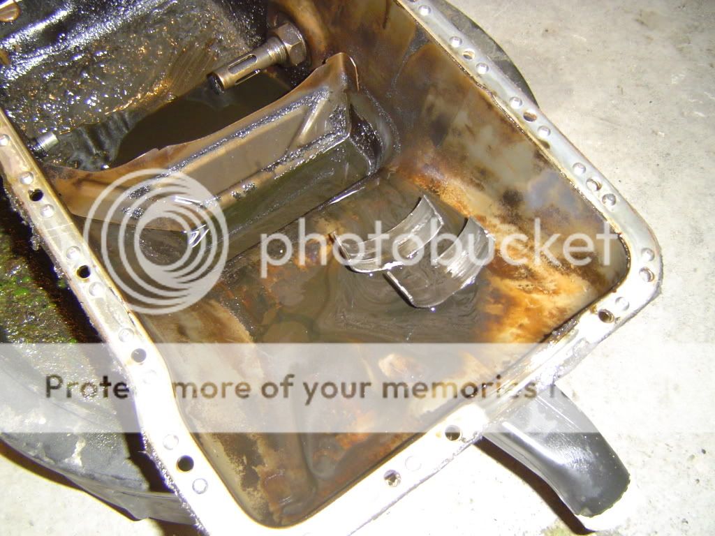

Dropped the pan and took a look. This looks to have been a problem long before I got my hands on it. Still ran surprising well considering.

This truck is getting the good running 2.9 from my 86 and will be sold. Then the 86 is getting a 5.0. Any idea what could cause a failure like that?
Your engine flush.
It does NOT look like the usual sludge deposits (except for the stuff around the oil pump body). It looks loose.
And it's BAD if it expelled a crank or rod bearing. A piece of dirt got in there and spun it. And if this happened a long time ago, you forgot to tell us about the engine knock. So, I think it JUST happened.
