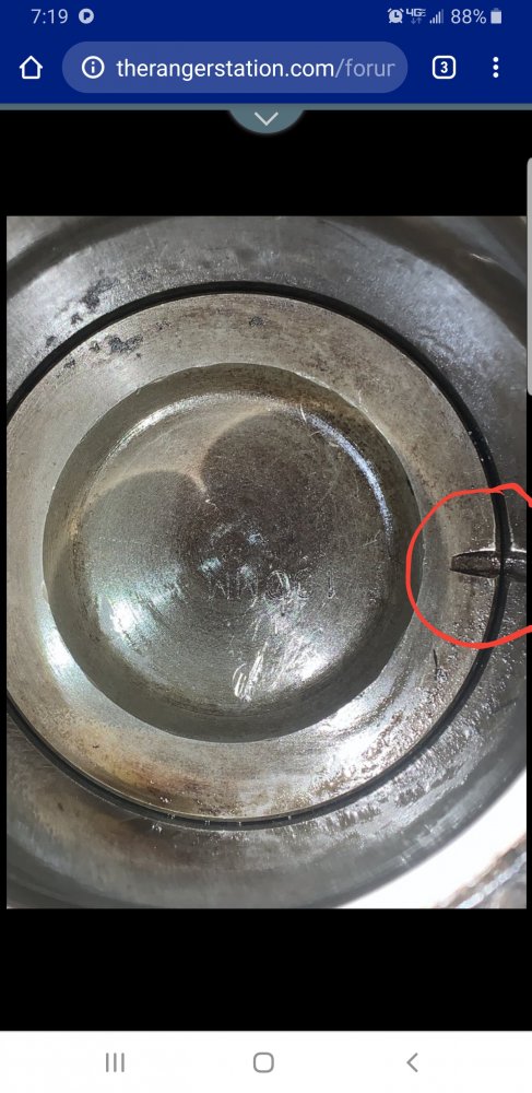

Nothing in those pictures say... I'm not gonna make compression. Are you sure you didn't wipe an intake lobe off the cam on that cylinder?

Is it me, or does nobody else see an impact mark on the head?
Maybe I'm seeing something that really isn't there but this looks like a significant connotation leak to me.

I think you're seeing a reflection...
Probably, my old eyes couldn't quite get the depth perception tuned in on that pic. I knew it looked almost like a mirror image, but with it being right on the edge of the pic, I wasn't sure. I think I can see it now that I've had a cup of coffee.
we probably shouldn't trust my eyes... just saying

I agree with G8orFord, though. I can't tell what that notch is.
Acssnowrider has it. Notch indicates towards front of block. Looks like reflection off cylinder wall.
Cylinder walls shouldn't be reflective!
