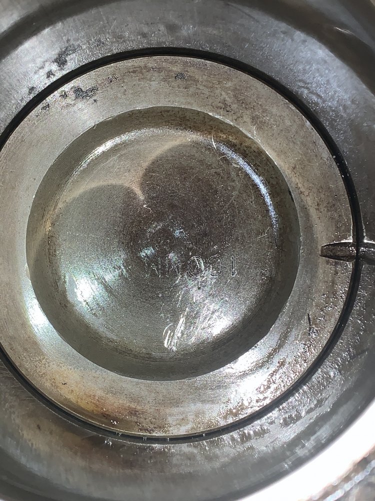

usually the land at the top is visibly fractured...and if the ring died a horrid death the cylinder writes the novel.
bind/hang is suspect....step 1 compression test....step 2 leak down. step 3 pull covers and crack out degree wheel if two is kicking you in the berries....

This still wouldn't explain the scratching noted on the piston.

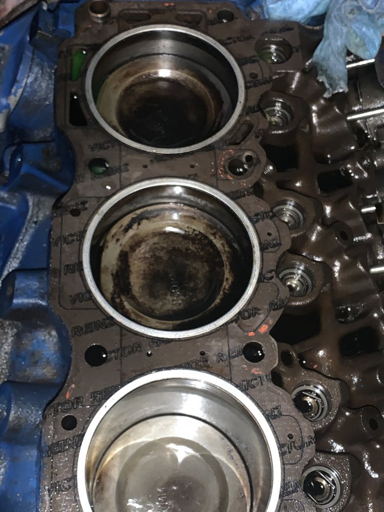

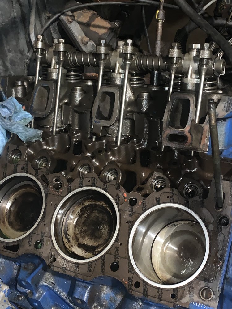

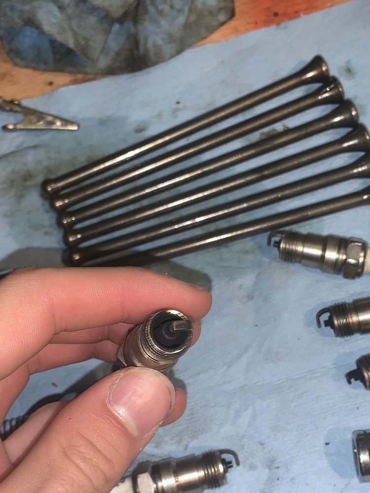

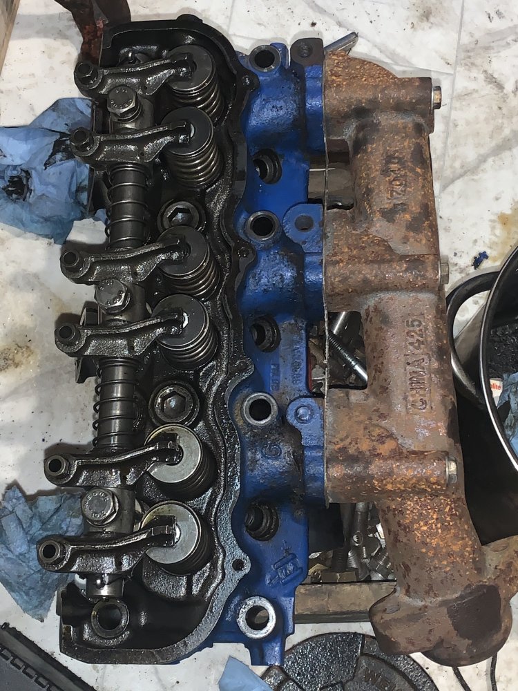

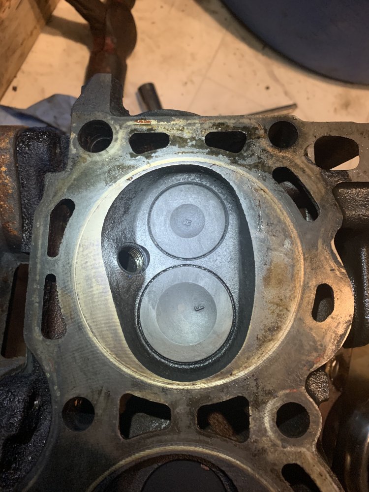

alrighty, I went out and took some pictures for you guys. I took a picture of the piston, the rods, the block, and the head as well as one of my crusty plugs.....ok rangerstation...do your thing
I'm starting to think purchasing a new block or salvaging one from a junkyard might not be a bad idea, and just reuse my oil pan, intake, and all the accessories I already have. I'm tired of messing with this thing and ide like to just build the motor one more time and be 100% positive it's correct, in spec, and going to get me down the road. also, note that cyl above looks very clean because I wiped it down looking for damage, all the cyl looked sooty and pretty much the same when the head came off. I put some oil in the cyl while I was at college for the week so cyl 2 and 3 look much dirtier than they actually are.
dirtman also commented about the bore, I got the truck as is and drove it 30k with no real issues I wanted to do a good teardown and rebuild over the summer and that's when I realized someone before me had done some customizing to the bore and crank (I suspect someone hooned the truck a little too hard in the past and blew the engine to hell, also note the block is sleeved with the .040 oversize.)
