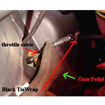

Whole this won't fix your idle issues, I almost guarantee that your throttle cable is stretched and it's not allowing you to reach top speed.
