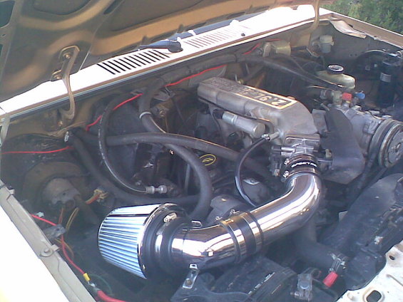

got a code reader, only code it pulls is 11, it doesnt have anything stored either. Yesterday i replaced both the cat and the 02 sensor... problem still not solved. checked fuel pressure, stays right at about 34psi on the rail.... I wish i could remember when it started acting this way because i did quite a few "mods" at once, Im starting to wonder if my intake is the problem? could the air charge being too hot be the problem?
when i bought this thing last year in albuquerque it was the cool part of the year so this is actually the first summer having it and expieriencing this issue at such an extreme, shortly after buying it I did a few "upgrades" including intake stuff and exhaust.
that intake tube gets pretty hot, should I bother with a new one or insulating that one? perhaps cutting in the wheel well to get a colder air charge going into the filter, or is this irrelevent to my problem?
Where's the air sensor? No wonder you're having problems. Put the stock air filter box and air sensor back on. It will provide more than enough cold intake air and the stock filter will keep fine dirt particles out. The cone filter you have passes fine dirt particles.
Looks good..but...I'll agree that it is sucking heat in from the engine compartment.
couple this with warmer southern temps
