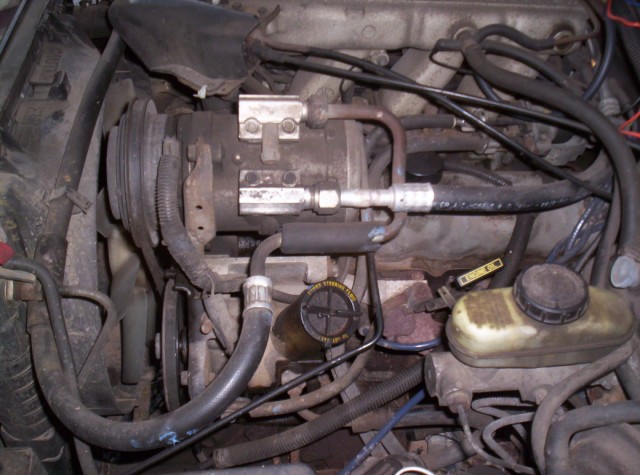

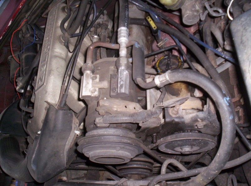

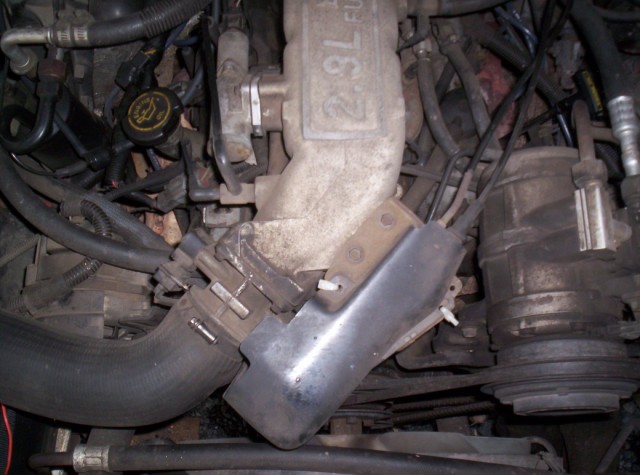

does anybody have a picture or diagram of the location for the accesories on the engine? i need to see where the p/s pump, a/c comp, alternator all mount to the engine. i got a 90 b2 from my friend who had it in pieces and instead of trying to piece it together like a puzzle i figured i would ask, thanks in advance

alternator goes on the passenger side of the block, power steering is on the driverside lower section and the ac is on top of that, i can get you some pics later but i am sure someone will beat me before i get off work later, let me know if ya have any questions

The accessories are in the same location as on the 2.8L if that helps at all. So if anyone has pics of a 2.8L
Okay here's a 89' 2.9 liter with air conditioning, hope it helps.
thats exactly what i was trying to find, the "puzzle" of parts i have are a lot easier now that i have the picture on the box to reference
